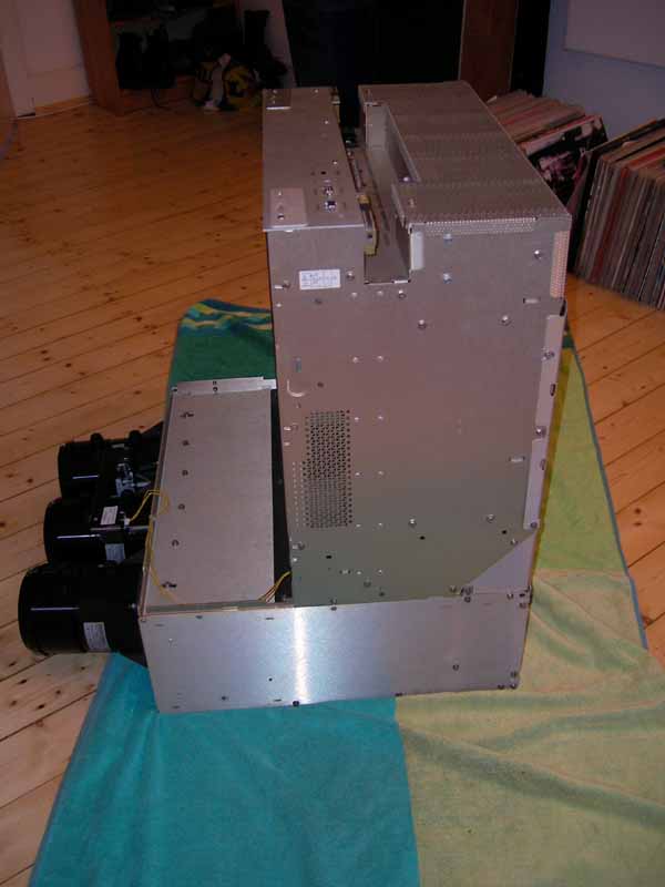

The first step was to get the LC-Housings; thanks to MadMrH I got the hardware very quickly.
Pic.4

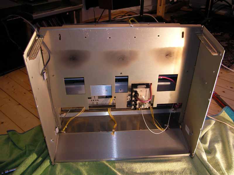

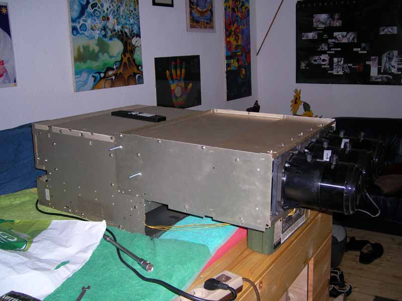

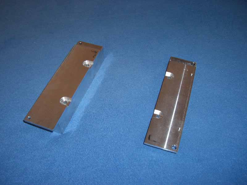

The next step was to built adapters to fit the LC-Housings into the projector, this was also easy I made a drawing and thanks to some guys in my company I had them within a week.
Pic. 2-3

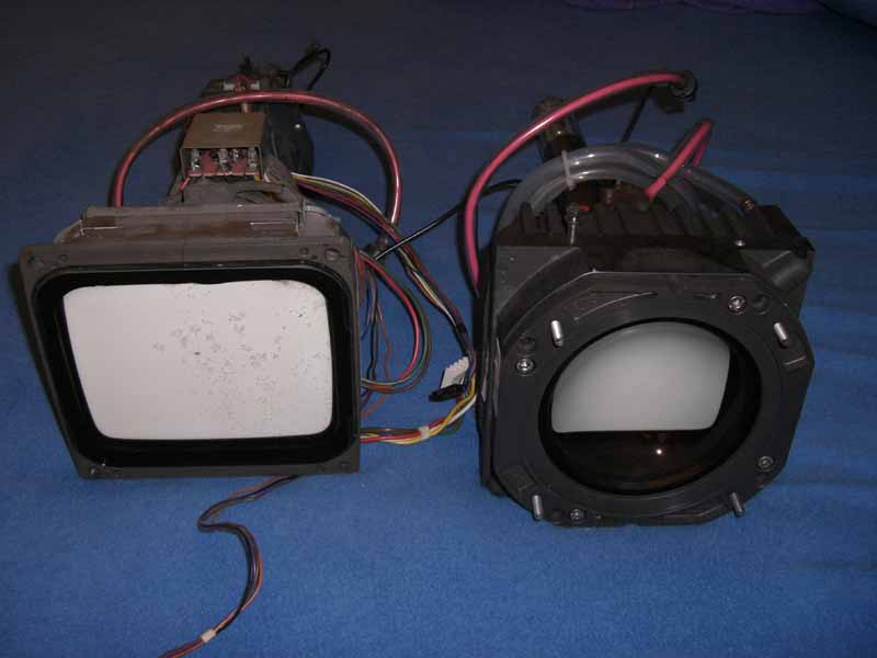

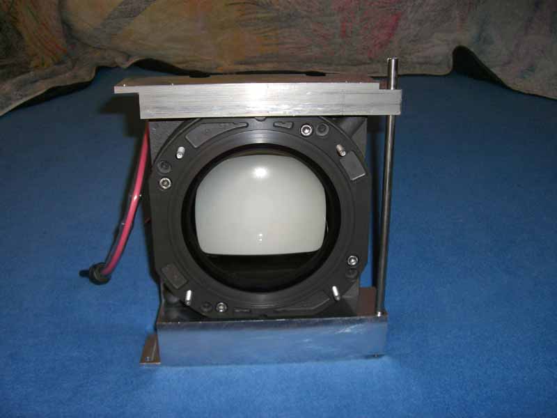

But then the Problem started I had to get Lenses. I had two choices the HD117-14 used in Barco Retroblocks with a limited screen width of 1,6mbut this would not be enough for my HC and the HD215, they don’t have a separate corner focus ring but I thought Barco used them for the Zenith 1200 so they can’t be so bad.
So I bought the HD 215.
Pic.1
HD8 vs HD215

But then I had to find out that 8”LC’s use different C-Elements so that I couldn’t use the HD-215 with the LC-Assembly. I just couldn’t get a sharp picture.

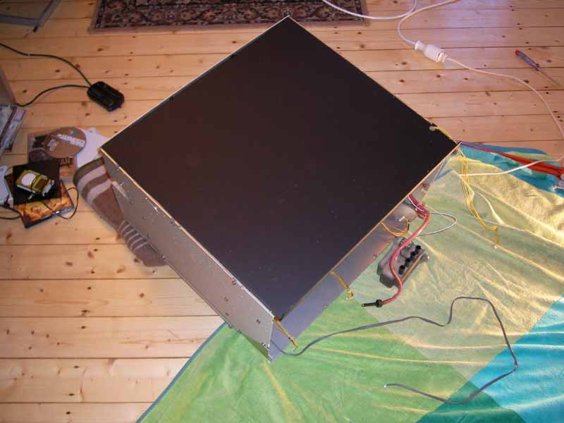

With a bit of searching I found in the Barco Lensprogram the HD117-24, they are good for a screen width of up to 240cm. So I tried to get them and I found a set but one day before I transferred the money to settle the deal I got an offer for a 808s retroblock with HD117-24.
The asked price for this Projector was really good especially if you take in aspect that it is almost a Zenith1200 just the coloured C-Elements and the orbitingboard are missing, but there for it comes with HD117-24 instead of the hd-215’s so that I could get good corner focus.
The next thing I know is that I had the 808s Retroblock in my room.
Pic.5

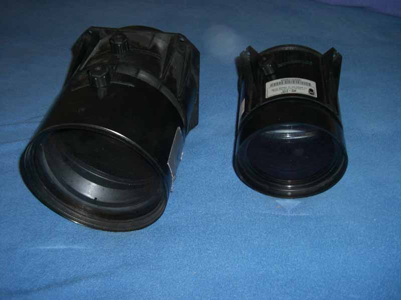

I had to alternatives first I will take the tubes and the LC-hardware out of this projector and but it into my 1208/2 as I intended to or I would take the 808S apart and try to turn the L shape into a I shape.
So this is what I did:
Pic.6-8
And so I ended up with an ugly 808SLC (almost Zenith 1200) that it is ugly is no problem because it is hidden in a Hushbox.
The transformation of the Projector was easy I just had to take the case of the LC-Assembly apart and cut a piece away from the Al-Plates and drill two holes that’s it.
The picture quality of the 808sLC is way better then the picture of the 1208/2 due to the almost pristine new tubes (High resolution tubes) the LC-Hardware, and Contrast modulation. Razz
There are only to bad thinks about the new projector: it is a bit dimmer and it got a bit of ringing but I think this is due to my long cable run almost 10m. Before with the 1208/2 I couldn’t see any the ringing I think this is because I couldn’t get the picture as sharp as I can get it now.

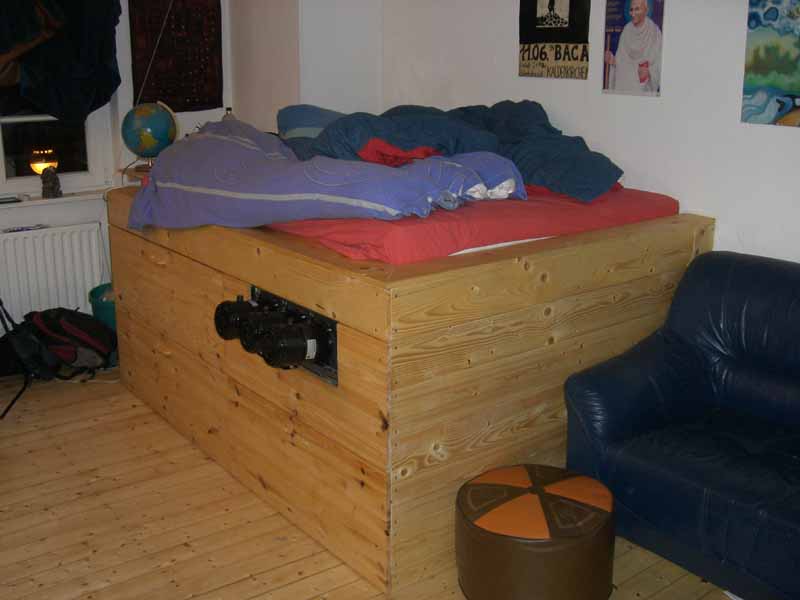

Here is a pick of my hushbox, Bed and Drawer combination.
And don't start to tell me I should fold my Bedsheets, my girlfriend does it allready all the time Razz
Joerg

That bed is awesome!! I can fully understand why you built it like a fort... If it can't rock, the convergence won't take a knock. Laughing
So how tall are you?? Do you use the lenses as a step to get in? Or a small trampoline? Laughing Sure would suck to forget they're there and slide out of bed in the middle of the night and whack the package on them! Laughing

whoooooa!!!! do you have any plans or drawings of that bed/hushbox combo??? that's WAY COOL!!!!

Sorry no plans,
normally I just go into the DIY and think what I can built.
Before I placed the 808sLC into the bed there was a 1208 with HD8 in it, the projector inclusive the lenses were completely hidden in the Bed.
If you have a closer look at picture you can see three handels they are for big drawers.
The one right under the PJ is filled with DVD and the remote.
If you want to built one your self just do it, it is not so difficult. Razz

Posted: Mon Jan 14, 2008 2:16 am    Post subject:
How do you cool the projector? It looks like it's completely enclosed under the bed no? It would run too hot I think... though it would provide for a nice warm place to sleep. Smile
