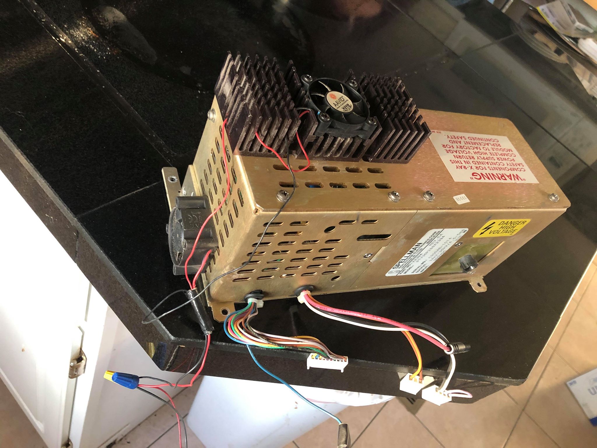

This is how I managed to finally solve the HVPS failure problem.
 Filename:  86427306_3056908684328548_8759586392897486848_n.jpg
 Filesize:  380.57 KB
 Downloaded:  249 Time(s)
I do love my AmPro's
papalek
Posts: 1536
Location: Longs SC
Posted: Sat Feb 15, 2020 10:16 pm    Post subject:
Heat sink on main chips and you have to cut o hole in the cover for it to fit through. Small fan on the end to draw air though the circuits. Fans connected to the chassis fans.
Posted: Sat Feb 15, 2020 10:51 pm    Post subject:
Best use of a Pentium II slot cooler!
