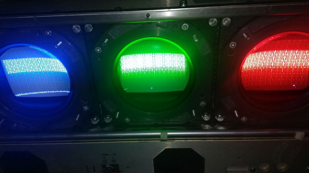

Posted: Fri Nov 29, 2019 12:43 pm    Post subject:

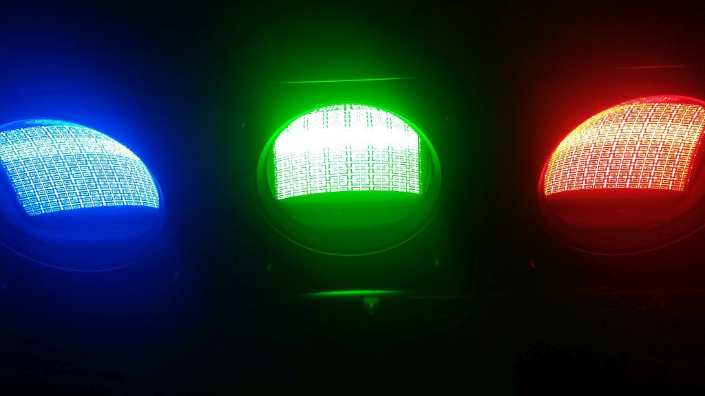

I did with a flash. On the lamps there are elements "c" for Sony g70
 Filesize:  92.72 KB
 Viewed:  5723 Time(s)
 Filesize:  93.59 KB
Posted: Fri Nov 29, 2019 12:46 pm    Post subject:
I'd say it's fast phosphor, since normally the green has the longest persistence, but on your picture it has the shortest.

Posted: Fri Nov 29, 2019 12:50 pm    Post subject:
What is best to do not to change the lamp. Leave element "c" from g70?

Posted: Fri Nov 29, 2019 1:00 pm    Post subject:
I agree also to say it looks like a fast green phosphor.

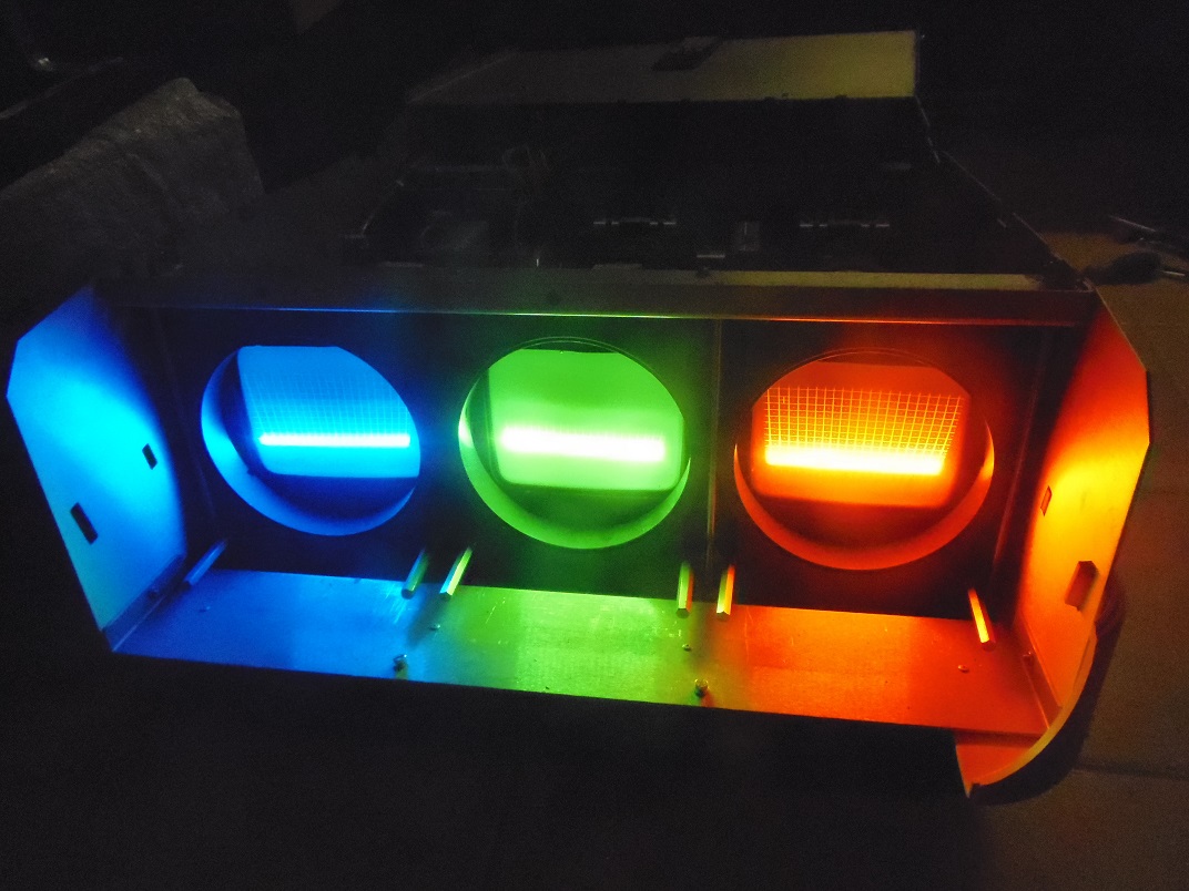

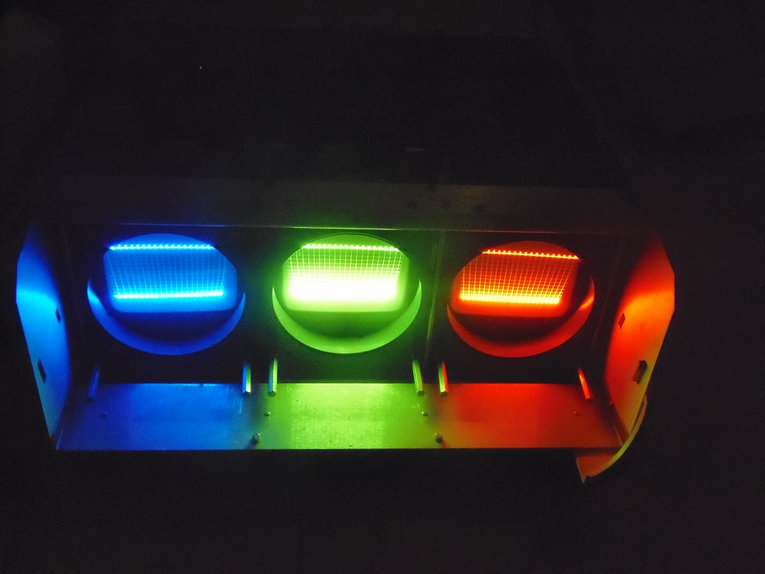

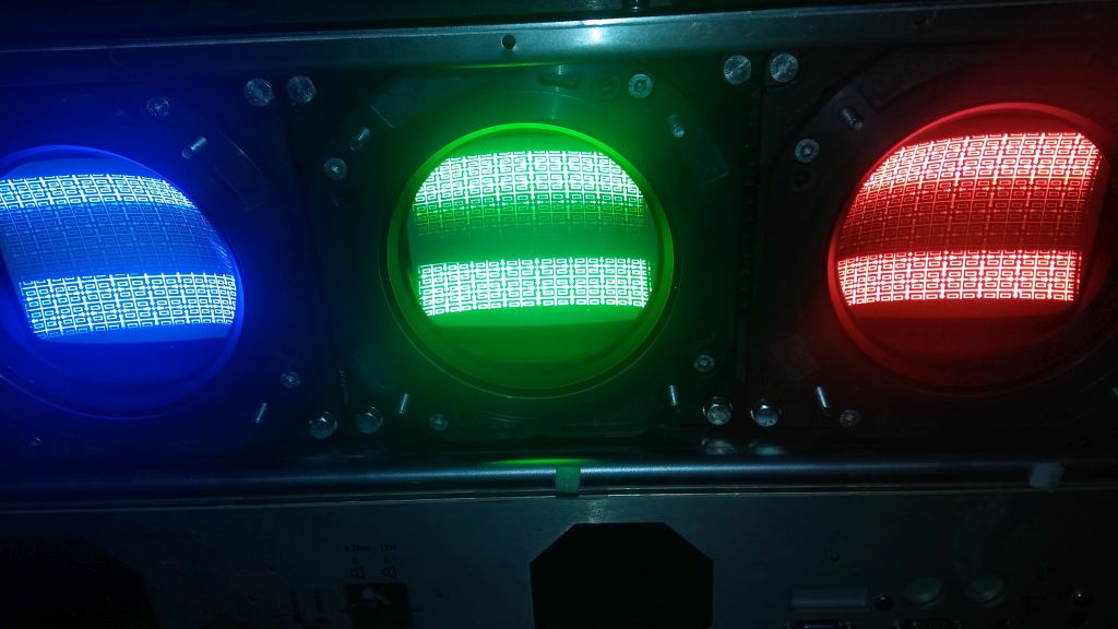

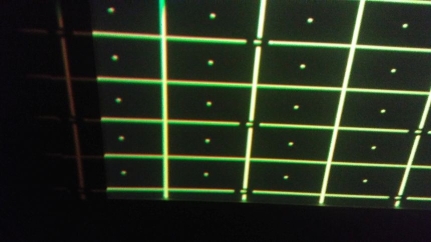

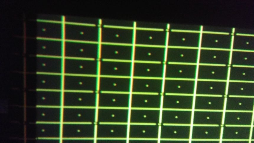

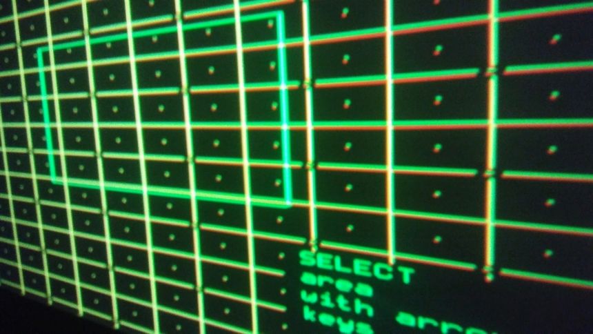

Posted: Tue Dec 31, 2019 9:34 am    Post subject:
I definitely use my 908 with Sony g70 lenses. A fast green phosphor lamp works in it. I decided that a green filter was needed. Overall, I am pleased with the image obtained. I will check with a colorimeter. We will see the results. However, I have a problem. After setting the perfect convergence, the image of the second day is strongly disturbed. Especially the red grid does not hold tight. Until then, all the projectors I used did not have such a big problem - they only required minor quick adjustments or did not require at all, because after heating they returned to good convergence. This is a new projector and I'm surprised that convergence can be lost even during use, when it gets warm, I need to stop the projection and improve it a bit. Sometimes I improve in one place and at the same time break into another place in front of my eyes. Maintaining perfect convergence requires eternal corrections. There is certainly no problem with convergence, I will set it perfectly, but it will fall apart the next day, and then, after heating, it is constantly improved. Warming up the projector does not help. None of the grid setting points are stressful. Advanced setup for the next day is annoying, but repeatedly improving an already heated projector is very annoying to me. Do you have any ideas? Is there a problem with the eternal and advanced mesh improvement in Barco 909? Projector from 2004 production, 180 hours of operation. Can capacitors lose their value at storage age that has never been switched on? If so which? in which section should I change? Everything else works perfectly.
for the next day
 Filesize:  55.25 KB
 Viewed:  5527 Time(s)
for the next day
 Filesize:  71.95 KB
for the next day
 Filesize:  95.33 KB
 Filesize:  84.86 KB
 Filesize:  131.69 KB
Posted: Tue Dec 31, 2019 10:09 pm    Post subject:
The problem sounds like Bad Capacitors however it could also be because of a bad mechanical setup which in turn is pushing the elctronics to keep convergence correct althought this should be less of a problem on a 909 or 908.

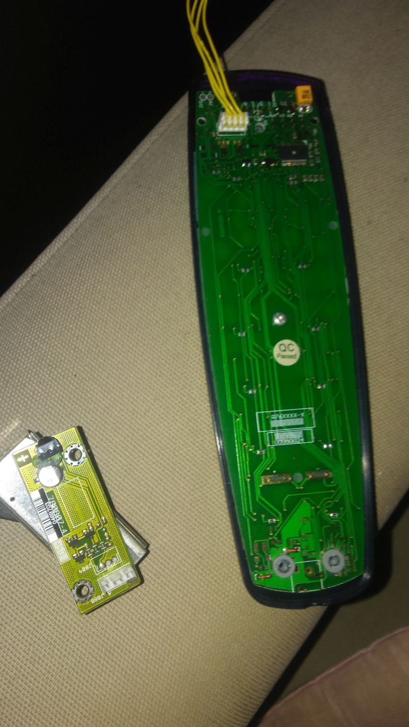

Posted: Thu Jan 09, 2020 9:46 am    Post subject:
The remote control does not have half the housing. There is no battery connection. I don't know where you can solder the cables to the battery. You need the IR receiver that I got with this projector. Can someone show in the photo where to solder the cables to the battery? Smile / 9v battery? /

Posted: Fri Jan 10, 2020 5:25 am    Post subject:
These use two AA 1.5v batteries not 9v like the older style remote. You could just extend the cable. Not sure if the IR circuit is in the internal remote.

Posted: Fri Jan 10, 2020 6:59 am    Post subject:
The remote control shown in the picture won’t work anyway without being attached through its cable. It is missing the IR LEDs and maybe even more parts around them. You can see it in the picture: Above the cable connector there’s a notch in the PCB. Two IR LEDs should be there.
