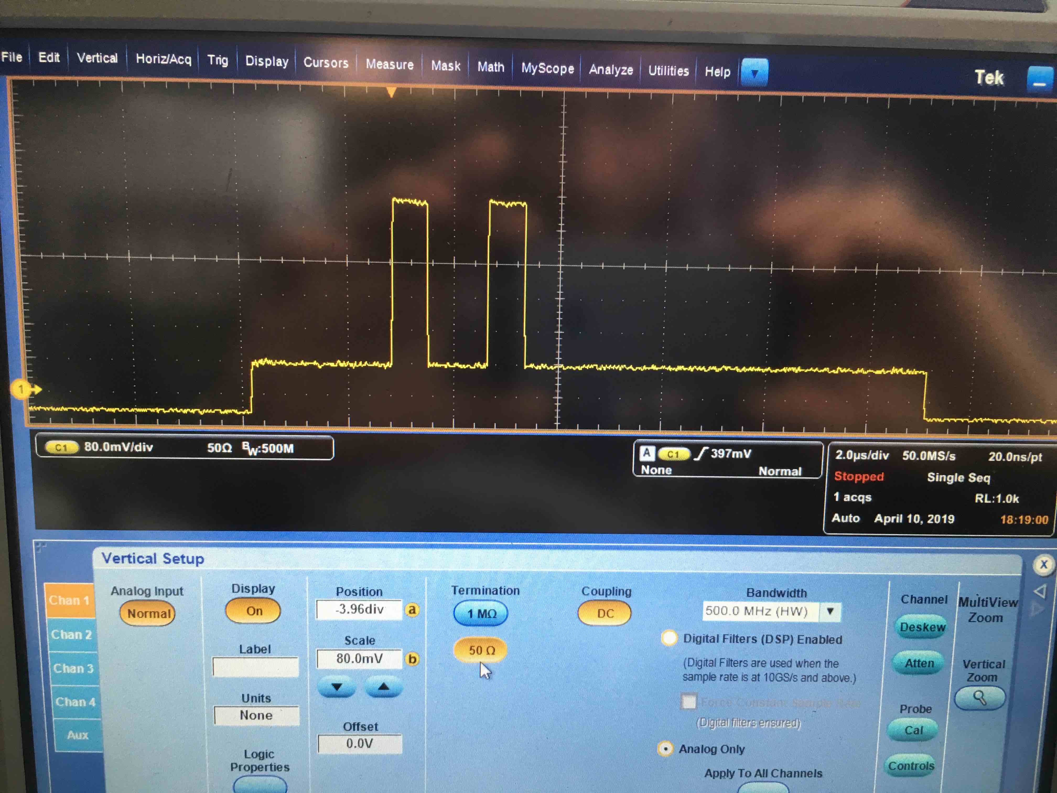

Hi All,
I recapped the LVPS and but I didn't see any further improvements. Anyway the LVPS will outlive the whole projector now I hope.
What I forgot to mention was that after Gjaki's upgrade I didn't see any blooming anymore. Now maybe I have to re-adjust the G2 and drive settings after his mods but I'll do that at the end.
I'm now working on the last part of the chain: the moome box.

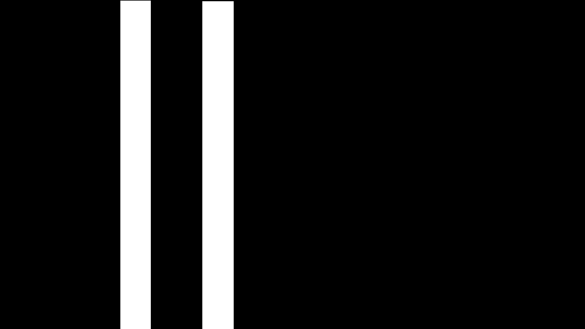

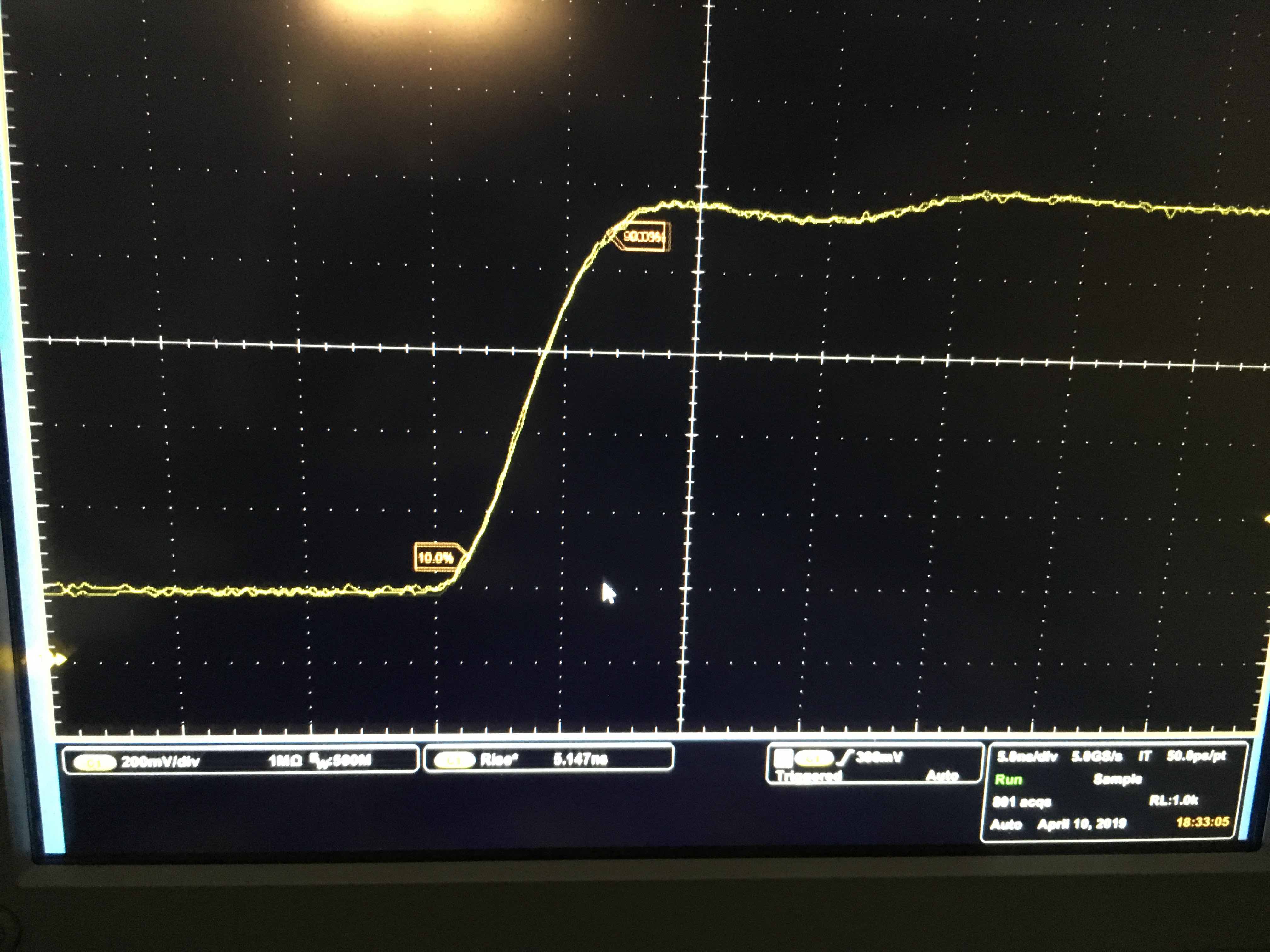

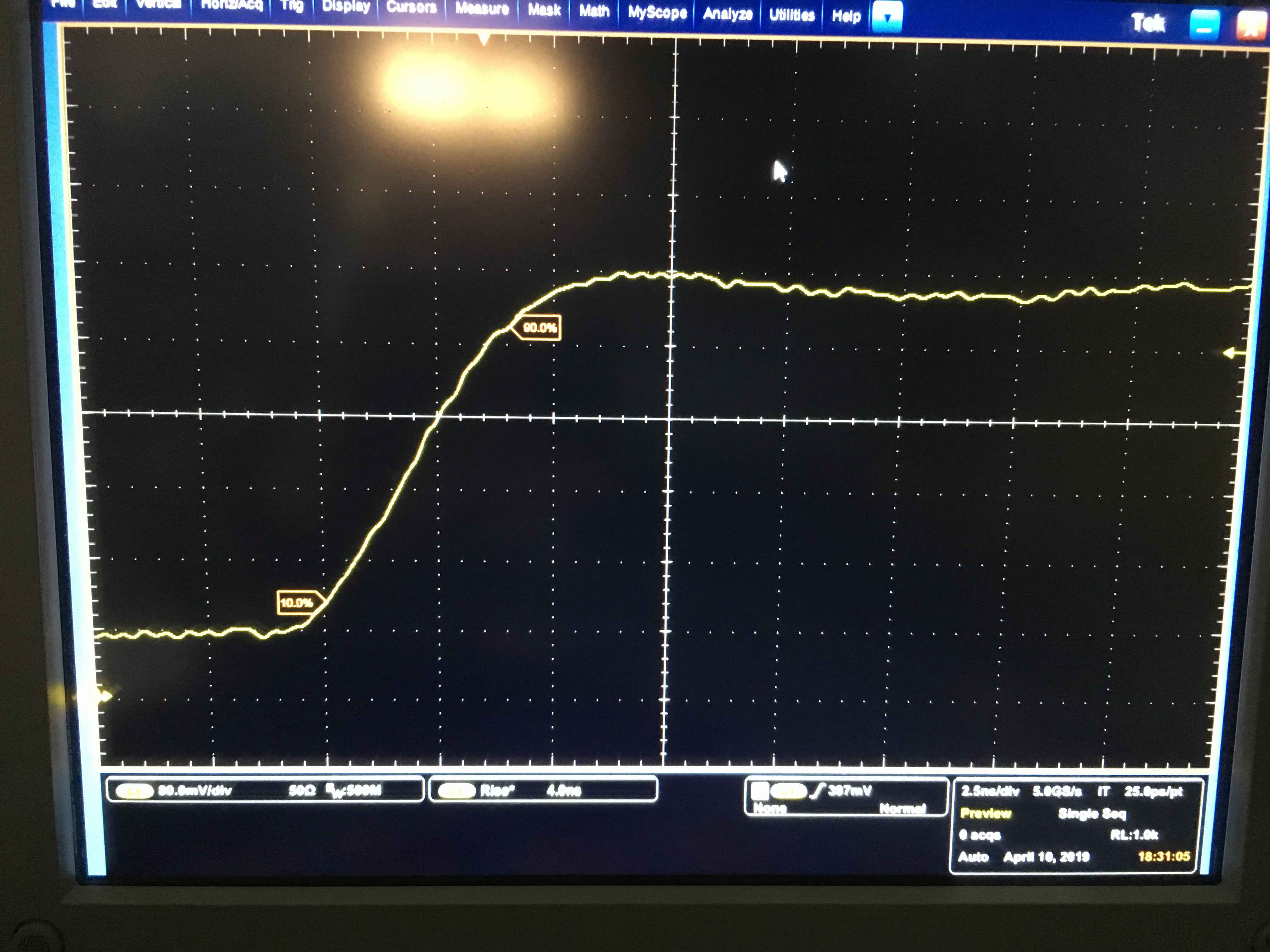

I did a quick measurement of the rise time. See attached pictures.
Unfortunately I had only a 50 ohm termination so I'll redo the measurements tomorrow with the correct termination.
The measurements are done on a 500Mhz bandwidth Tektronics scope that was standing in one of our labs.
I took a VGA to 5 BNC breakout cable with the red channel connected directly to the scope with a 50 ohm termination.
In the pictures you have the test pattern I used, the scope settings and the rise time with 1Mohm termination and 50 ohm Termination.
With 50 Ohm the rise time is about 4.9ns.
Regards,
Ron.

Posted: Wed Apr 10, 2019 8:24 pm    Post subject:
I think you did the measurement right. Don't care about the 50 Ohm load, properly terminating at 75 Ohm wouldn't change the rise time.
4.9ns rise time is pretty bad by the way, that translates to ~70MHz bandwidth. also note that the rise times are propagates: so if you have a source (signal) with rise time tr1 and a system with self rise time tr2 then at the output the accumulated rise time will be tr3=sqrt(tr1^2+tr2^2).
One can calculate the signal/system bandwidth by knowing the rise time: BW[MHz]=0.35/tr[ns]
Note: All these applies to your your signal measurements, there tr3 was 4.9ns, and the 500MHz scope should have a self rise time of 0.75ns, doing the math backwards gives a 4.83ns theoretical signal rise time, not much difference, since the 500MHz bandwidth of the scope is much higher than the signal of interest, but generally if the measured signal's rise time gets close to the measuring system's own rise time this effect is more considerable. This is why it is advised to have your measuring system's own bandwidth 3-5 times more than the signal of interest.
Anyway, a well behaving stock VNB (like yours) usualy have self rise time around 3ns, my daughterboard has a self rise time about 1.5ns, that results in approx. 3.4ns system rise time. To properly exploit this you'd need a source with <2ns self rise time.

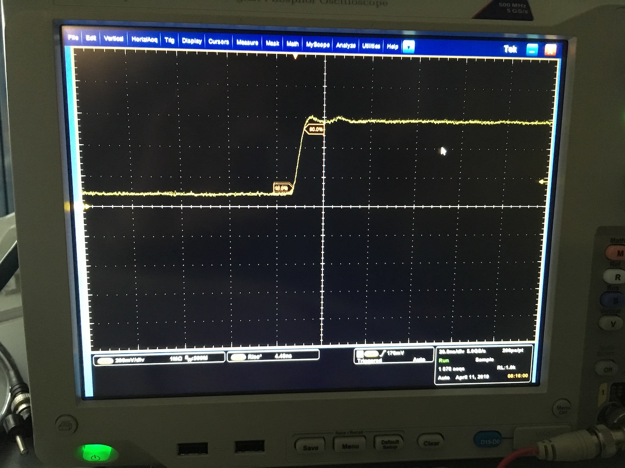

Posted: Thu Apr 11, 2019 7:17 am    Post subject:
Hi everybody,
As promised the rise time with 75ohm just for completeness.
rise time of the system 4.5ns
with your formulas we get around 80Mhz bandwidth.
So now it's time to find the outputs of the DAC on the moome box and see if we can connect that into the projector.
Regards,
Ron.

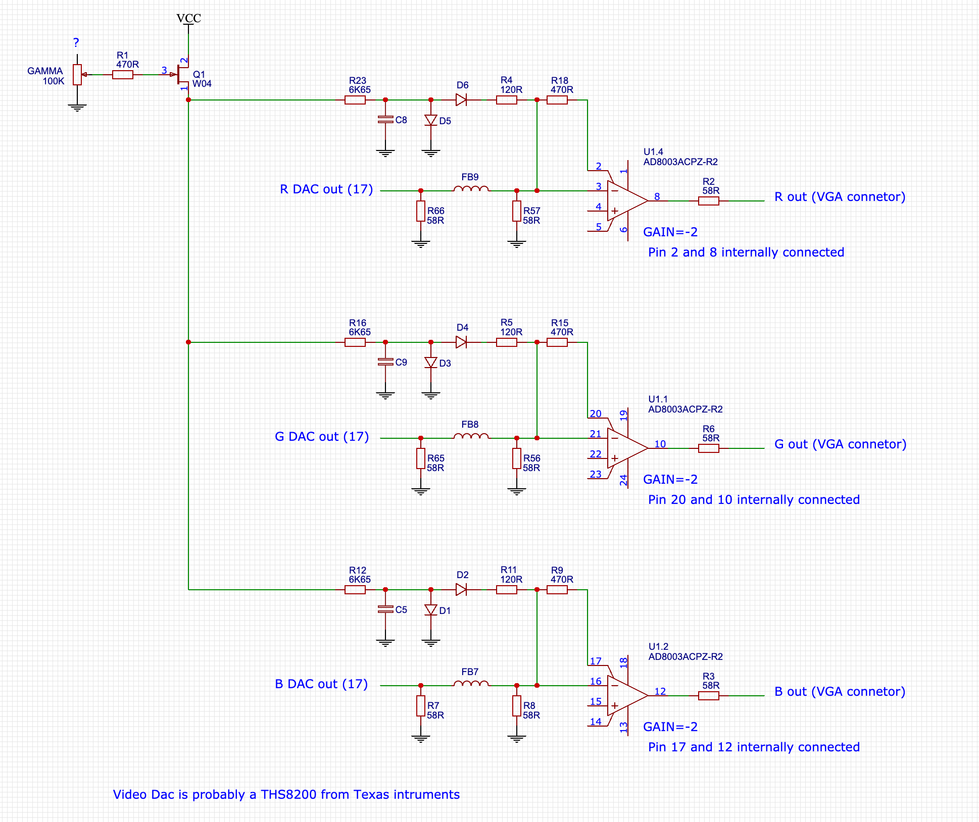

I'm working on it. i first want to draw the schematic from the PCB in order to see where to bypass since there is also the gamma and contrast circuit involved.

I have puzzled a little bit during the weekend and this is the result:

Posted: Mon Apr 15, 2019 8:40 am    Post subject:
That's clearly a single feritte bead being used as a low pass filter. That is the least complicated filtering method and by simple jumping the three beads, you should get good results. But I would still scope it at some point to see if there is any overshoot on the video.
Post back your before and after SMPTE pattern images.

But if it is really using the THS8200 DAC then, no high hopes, since that DAC has 3.5ns output rise time specs.
Posted: Mon Apr 15, 2019 11:09 am    Post subject:
gjaky wrote:
Good point. But his question was dealing with jumping the filters, which was my focus.
Are you sure of it using the THS8200, that could be a 1280X1024 at best DAC?

No I'm not sure about that, but its an 11 bit dac with 80 pins housing and I don't find so many dac's with so many pins. On top of that the output pins at least correspond with the PCB.
I tried to bypass the bead of the green channel with a short wire (4mm) across the bead but that didn't change anything on the screen at least. I couldn't check it on the scope today.
Now I feel ripped off paying 240$ for a so so dac.
regards,
ron.

I tried also bypassing the complete amplifier section. I took out the bread FB8 and R2 and connected from R65 straight to pin 2 of the VGA connector. No change in image. absolutly nothing not in brightness not in sharpness.
I guess i have to find another dac.
regards,
Ron.
