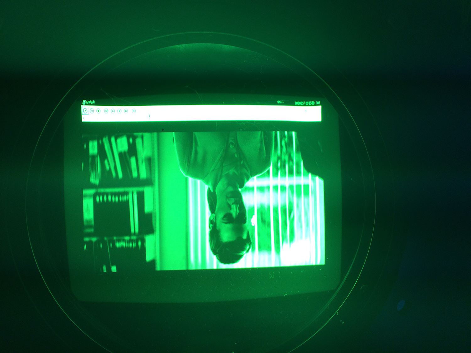

I managed to hook this up to my PC with an RGB breakout cable. It looks to be working well! Going to move the projector into place tonight and put on the lenses. HFQ900HM. Just need to figure out the optimal throw distance. Smile

I moved the projector tonight into position roughly. I put the lenses on and powered it up.
I noticed right away looking at the tubes that the image is going outside the raster on at least one side (which if I recall is bad!)
So... I shut it down for now. Since I have never owned a Barco and it has been 6 years since I have setup a CRT,
I am going to have to dig in the manual to see how to shrink and move over the raster.
I am feeding it 1600x900 since that is the max my video card will apparently go through the RGB port.

Posted: Mon Aug 20, 2018 10:58 am    Post subject:
Hey,
please be sure to center the image on the tubes.
Mostly if you center green (Raster Shift option "coarse" of "fine") the other two colors get touched also and should be centered. If not you can do raster shift on each color.
You can also use the Geometry option to shrink vertical and horizontal.

Posted: Mon Aug 20, 2018 6:23 pm    Post subject:
Thanks ElTopo. Yes, I am not at all familiar with the Barco menus yet so I am reading up on them now so I can go in quick and shrink them down without the tubes on for long. That will be the first thing I do before working on focus.

Oh, and do a 'set to midposition, all' in the service menu, under the memory page. The keystone and everything else will be a mile off on these sets given the installation. No problem running to the edge of the tubes, but turn the contrast way down, to 10 or so, and you won't implode tubes.

Ok good to know. I was hoping there was some sort of "revert to factory" type setting. Its hard to even read the on screen menus at this point. I have NO IDEA how to set these up lol. I am having to re-educate myself on CRTs. It's been a while!

1st = mechanichal focus on the lens
2nd = focusing inside the menu
After that reading should be no problem anymore Wink
