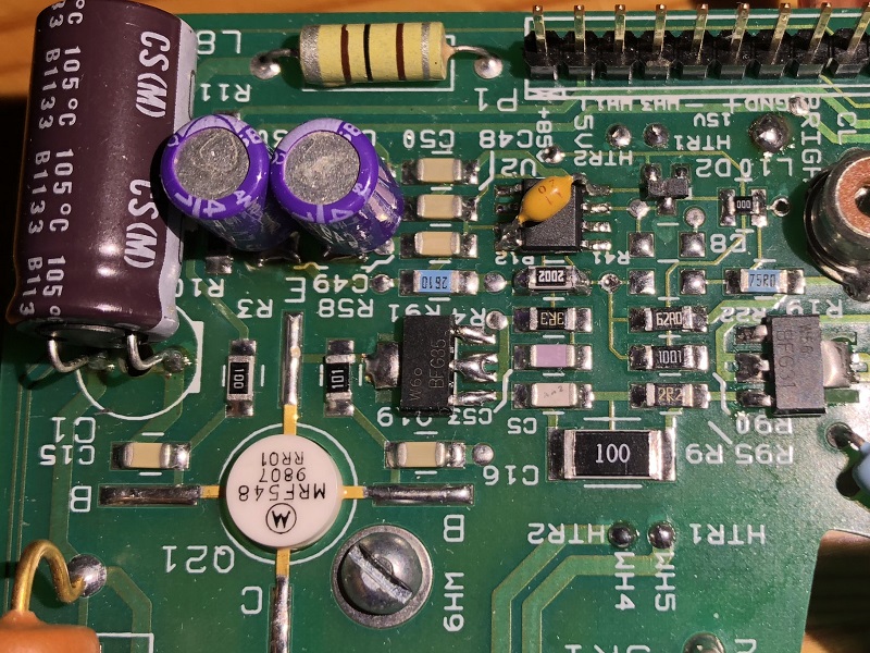

...if you take your time and use the right tools, the right heat they still can look factory new.
In my opinion, it doesn't have to look like factory new. On the other hand, broken and/or lifted traces plus burn marks on adjacent parts and cables aren't necessary.
The PCB boards on Marquees aren't the best I've ever seen but they aren't overly bad either.
With care and patience, good results are possible like for example the neck board I've been experimenting with recently (see picture). All soldering was made by hand using a very old Weller magnastat soldering iron (temp around 700 degrees Farenheit).
Removing the 8-pin SMD transistors was done using this procedure:
- Add a blob of fresh solder (mine contains 3.5% flux) to each side of the chip
- Heat up all four pins of one side at the same time (the solder blob will transfer the heat)
- Lift this side of the device carefully using a micro flat tip screw driver while the solder still is molten
- Grab the lifted side with a pair of tweezers
- Heat up the other side and remove the device
- Remove all excess solder using solder wick
- Clean up the solder pad using isopropyl alcohol
