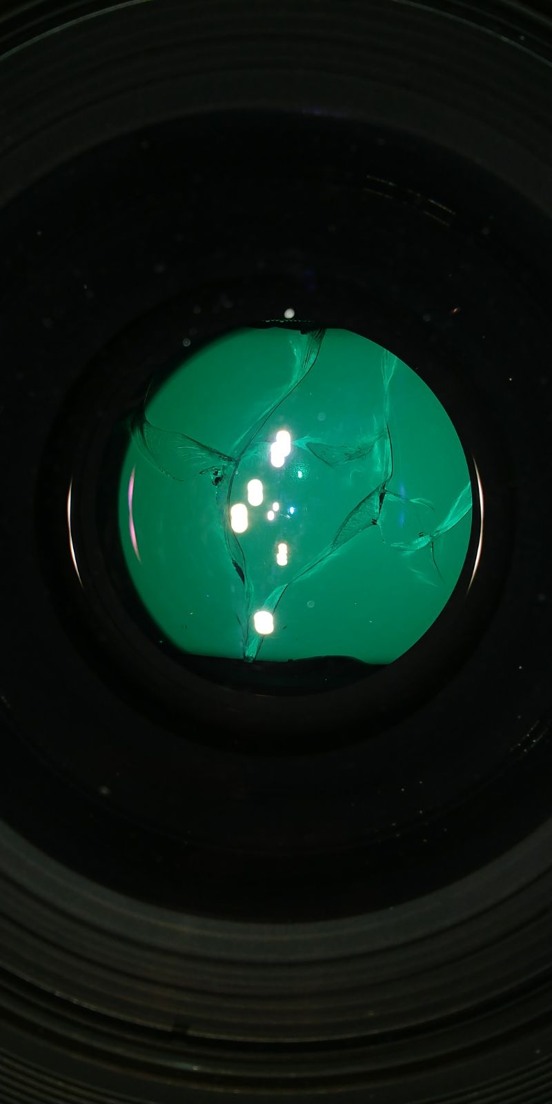

Posted: Tue Jun 27, 2017 8:27 am    Post subject:
Currently hating life. Just spent about 6 hours over the last few days getting the green and blue tube for lack of a better word ... perfectly sharp! .... only the red left .... as I'm waiting for the tube to warm up i hear almost like a fuse blowing sound and the projector turns off .... Can't turn it back on! ... on the back of the projector it says 6C ..... can someone just kill me now please .... what does this mean?!?!
wassup30
Joined: 14 Jun 2017
Posts: 30
Posted: Tue Jun 27, 2017 8:29 am    Post subject:
NVM .... i know exactly what it is .... green tube is completely cracked Sad .... this sucks so much!
Posted: Tue Jun 27, 2017 11:54 am    Post subject:
I am sorry to hear that!
That is the third time I am personally aware of where a G90 has broken a tube.
My first G90 came with a broken blue tube. I recently replaced a broken green for somebody else, now this.
I've heard of other instances but haven't personally dealt with them.
The ones I've dealt with were unquestionably Sony factory jobs. so it's not a matter of workmanship, or at least
I have no direct evidence of that. But I find myself wondering about the way that Sony decided to install the
tubes in the mounting frame. There are four little metal pins that space the tube a set distance away from the
mounting frame. The purpose is to ensure that the silicone adhesive bead between the tube and frame is of consistent
thickness. But they also will conduct heat away from the tube. If one of them conducts the heat better than the other
pins, then you get a cold spot at that point on the tube relative to the rest. This thermal difference, if it is great enough,
WILL break a tube.
If you can post a picture showing WHERE the tube has broken, I will not be surprised at all to find that the crack crosses
over one of those four pins. In fact it probably originated there. Those pins are located at the centers of each side of the frame.
If that's the case, then I'm going to think that those spacer pins should not be metal. In fact if that's the case, then I will
discontinue the use of those pins and insert thin plastic spacers instead, which is what I do on Marquee tubes I install, which is
factory correct for Marquees.

Posted: Tue Jun 27, 2017 4:40 pm    Post subject:
Here is a picture of the Tube. When I get the lens off the front of it I'll take some more pictures.
Broken Green Tube
 Filesize:  56.99 KB
 Viewed:  8693 Time(s)
Posted: Tue Jun 27, 2017 5:02 pm    Post subject:
Did I call that shot or what? Cool
Yep, top dead center, right under a spacer pin. I'm convinced.
If nothing else, the pin needs to be covered over with silicone before the tube is placed. And silicone
inside the hole where the pin sits, too, is a good idea.
I think that for future G90 retubing, I'll just use plastic spacers instead.
And, don't worry, I've got you covered on a replacement tube. Somehow we'll make a deal that works for all concerned.
