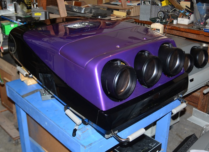

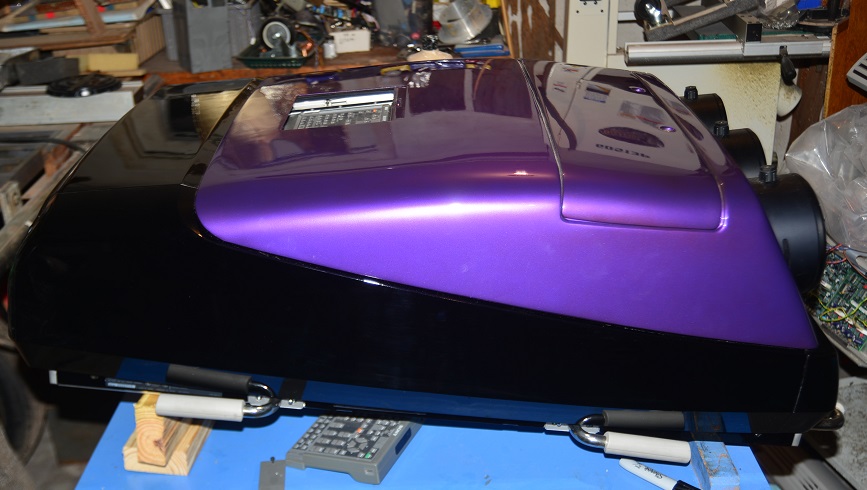

Posted: Tue Jun 13, 2017 8:03 pm    Post subject:
I like purple!

Posted: Tue Jun 13, 2017 8:05 pm    Post subject:
If you can, get a Vision 1 or related case kit for your Marquee. I think you'll love it.
If you can't find one, sculpt case parts out of foam, fiberglas over them, then cut out the foam inside,
and finish making your own custom case set. Which is a lot of work, to be sure.

Posted: Tue Jun 13, 2017 9:16 pm    Post subject:
I'm almost finished with the Vision Two/Vision One transformation. I need to widen the holes a little bit more, but it was such a dusty ordeal last time I've been putting it off for a breathing mask. I'll re-post images soon to show. But a custom front would be nice, great ideas.
