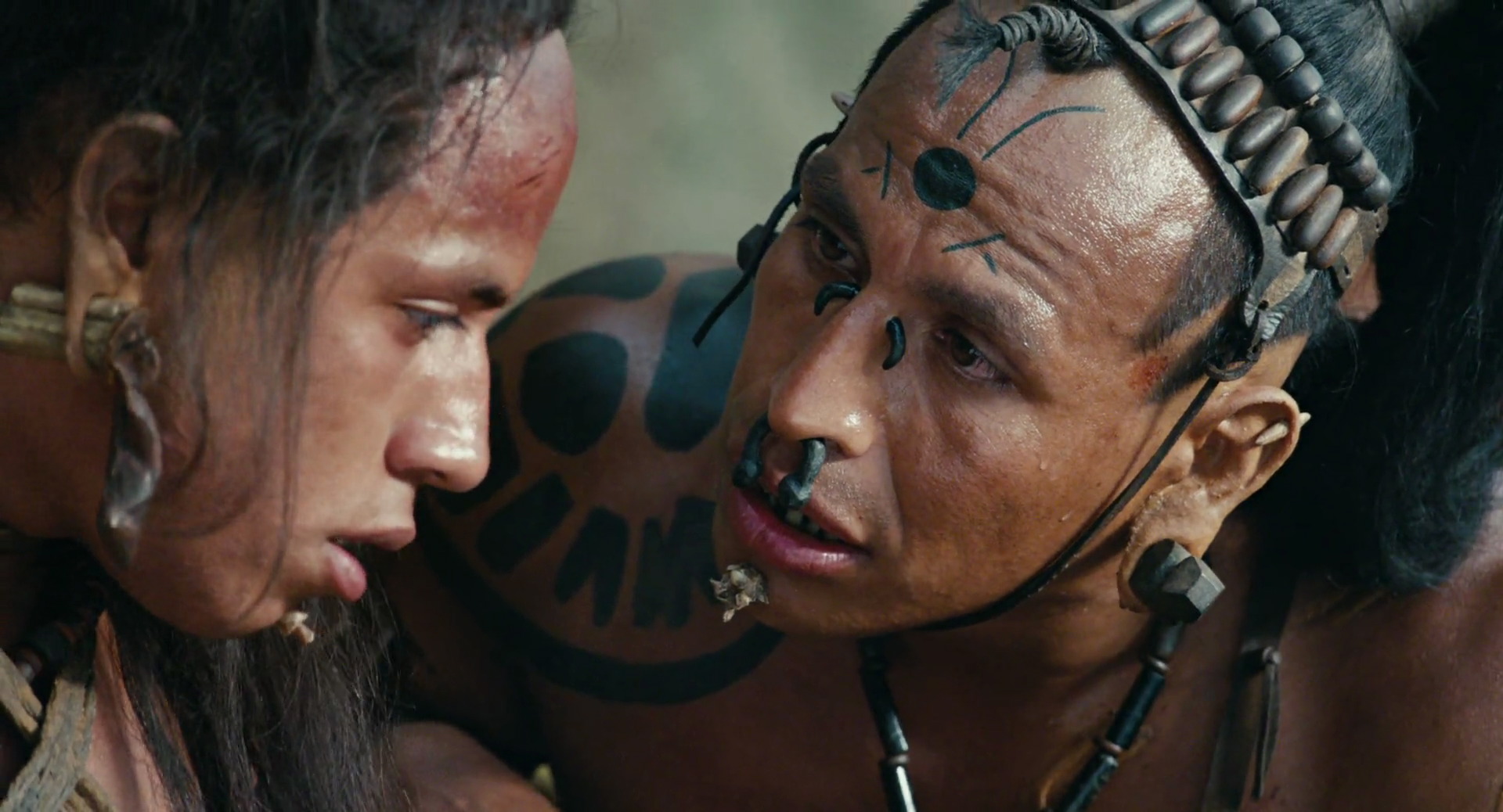

Posted: Sun May 28, 2017 8:52 pm    Post subject:
The one on the top is my shot. The one below that I'd rather not resize is a screencap.
This is my best camera, and this is also totally before any calibration or serious focusing. I'll just put this right here for now. And from now on until I get things calibrated, I'll use my best camera.
Also, there is ZERO , none enhancements. just a super video chain in action..Mr. Green

Also and above I've posted a shot from my screen and below it a raw from the internet screencap of the same image. In those two, you'll see what I was saying about the colors, though not calibrated, the CRT is more color saturated.

Posted: Sun May 28, 2017 9:36 pm    Post subject:
Not too shabby. If I'm hyper critical, it looks like your blacks are a bit crushed. Of course, this could all be in the camera. Note the wisp of hair above the ear on the right hand side of the reference image or the area where the ear adornment stands out from the face on the left hand side. I can't resolve these details on your shot on my monitor.

Again, what is in the frame buffer in RGB color space was computed from the YCbCr information encoded on the BD. It's the same 'source' information but they are necessarily in different color spaces. You can't post a YCbCr encoded image that we can observe with a base web browser. It HAS to be transcoded to RGB color space and if for it to be correct it has to be specifically sRGB color space.
Agreed. If one says the frame buffer grab most represents 'accurate' or is most representative of the image information encoded on the BD, then your shot appears a bit over saturated with a bit of black crush in comparison to me. Also note the color of the background above the shoulder. Your shot has it at a higher color temp (more bluish) to my eyes but not too shabby considering there is a camera and screen involved. My comments are hyper-critical, but when images are posted in an A/B manner one can be that way. FWIW, most of your shots strike me as bit over saturated even when not done in an A/B manner.
Posted: Sun May 28, 2017 10:38 pm    Post subject:
Yes, the camera surely limits the IRE window when doing this, it just does not have the dynamics. That plus things have not yet been calibrated and that would also cover the hair, because focus has a long ways to go. fact is, after installing the GREEN tube, I only focused the center. None of the stig has been done globally.

Agreed. If one says the frame buffer grab most represents 'accurate' or is most representative of the image information encoded on the BD, then your shot appears a bit over saturated with a bit of black crush in comparison to me. Also note the color of the background above the shoulder. Your shot has it at a higher color temp (more bluish) to my eyes but not too shabby considering there is a camera and screen involved. My comments are hyper-critical, but when images are posted in an A/B manner one can be that way. FWIW, most of your shots strike me as bit over saturated even when not done in an A/B manner.[/quote]
The over saturation has to be corrected using a processor or other ability to decrease the saturation. The Grabs will also look like this in comparison to the Frame Grabs.
My setup is in serious need of calibration and finer tuning. I'm pleased that you've not mentioned sharpness being a problem, which would not be the case with this video chain at all. And if you knew how much better it could get after things are dialed in better, there's a lot more to expect from this setup. Surely the need for a Darby of other sharpening tweak, will never be needed or desired.
I posted the comparison to give an idea of how well things will look even when everything is not where it should be. This video chain is the BEAST. And I'm going to let that beast out the cage after I get things dialed in the way they should be..: Mr. Green
