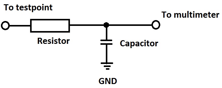

Anyway, we can start over now with taking measurements on the GAIN CTL board first. Normally for such measurements an oscilloscope woud be desired but I assume you don't have one so we try to rely on your multimeter. For this we (you) will ned a "special" adaptor.
The idea is to take measurements on the video lines when there is nothing displayed (no menu, no source, no nothing) on the screen so if we can measure some drift somewhere that would be most likely the appearance of the ghost of brightness drift.
But even with no signals applied there are reasonably fast signals on the video lines, those may fool your multimeter, for this reason we need that adaptor which would be a simple low pass filter actually, so it would give the average of the fast signals, but that would be still OK for us since if we can catch the brightness drift it would shift the measured average value as well -at least his is the plan Very Happy
It would need a tiny bit of soldering and a lone capacitor and resistor, their value is not critical at the moment tell me what you have and we put together something useful out of it.

I do have a 'scope, a PC (USB) Picoscope, but it's not in the same room as the projector and I don't have a fast enough laptop to use it. If there's something crucial to test with the 'scope maybe I can borrow a laptop or something.
I have some 10K resistors and 10v 100uF caps from a mod. chip I made for region hack on Sony DVD player a long time ago (simple RC filter to give analogue voltage output via PWM on PIC microcontroller). If those are not suitable I can get anything else in local electronics shop no problem. Soldering is no problem, I've fitted 1000's of mod chips over the years. Like I said I'm a software guy (with limited hardware knowledge), if this could be fixed with a hack of the firmware I'd be on it already. Smile

10k and 100uF is great! So do the above mentioned filter and measure the TP7011 on GAIN CTL, and see if it changes with the brightness drift.
