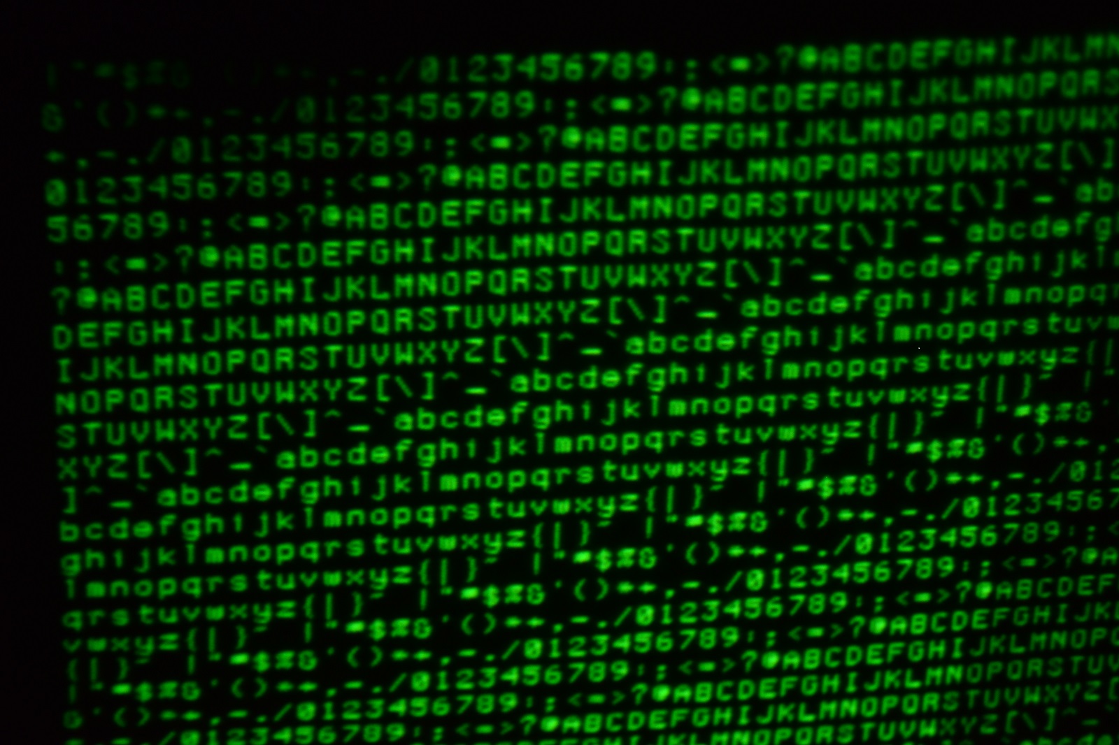

That's good news alright, and I think I speak for a lot curious people how good they really are! But I much rather see you post a 1:1 1080p image to see how sharp that must be.
And as always, excuse myself for asking such a thing - when I don't post much myself recently but rely on others to spice things up,
- and actually don't know what's really going on either, I just look at how sharp it appears to be. That's all I need to know I think.
And the gray step pattern of course, to see if it's better off with the white-to-black squares. Are they white to gray to black or tinted somewhat. For the sake of this site it would be interesting if you took a bunch of photos to show off. You know how starved we are!

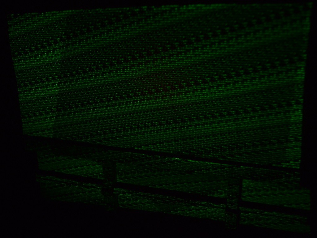

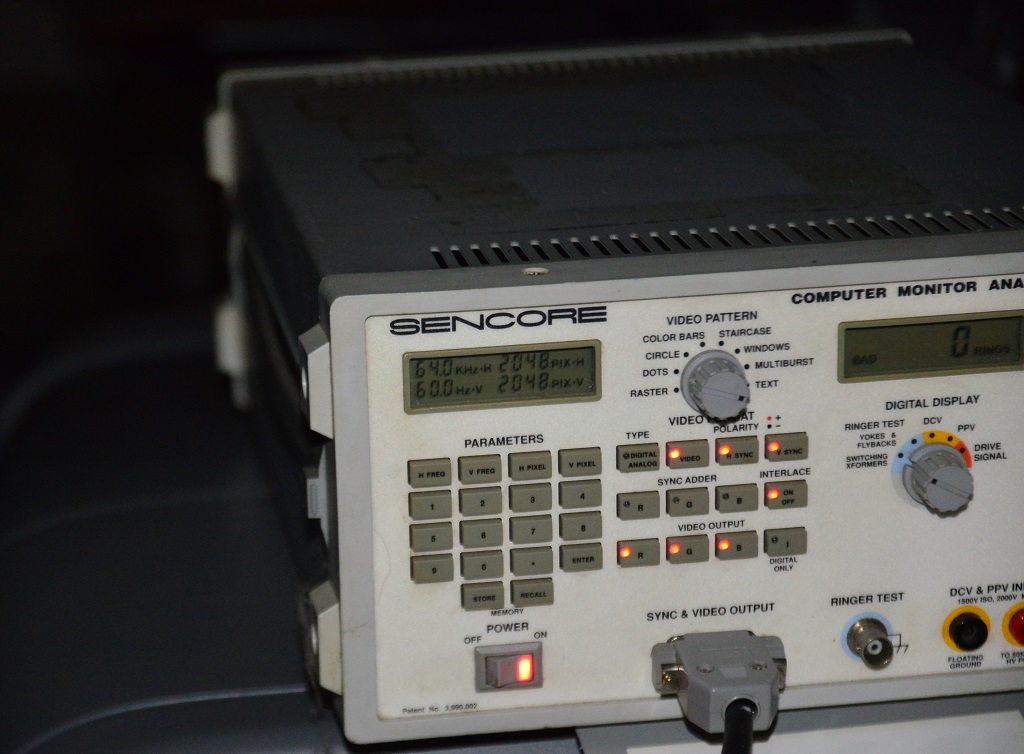

I'm a little ways off from being able to post screen shots of this unit. But I can post some detail shots now.
You will simply have to trust me when i say that these images are taken from a test pattern running at a resolution of 2048x2048 and
mechanical focus has been optimized only for the areas of interest at the center of each image.
Just three images for now: The analyzer/pattern generator showing a set resolution of 2048x2048, and showing the text pattern selected, a shot of the entire screen projected on my garage door, and a close-up of the upper left corner of the same image.
