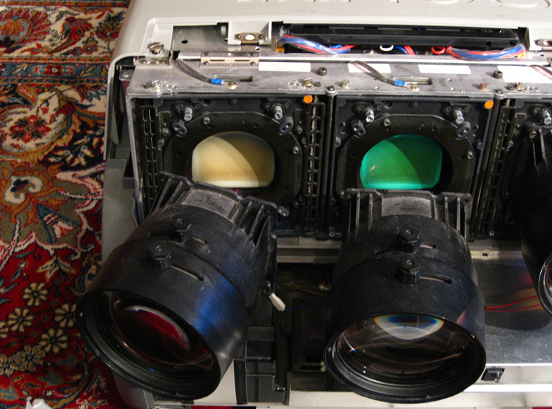

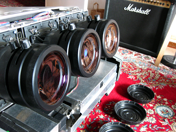

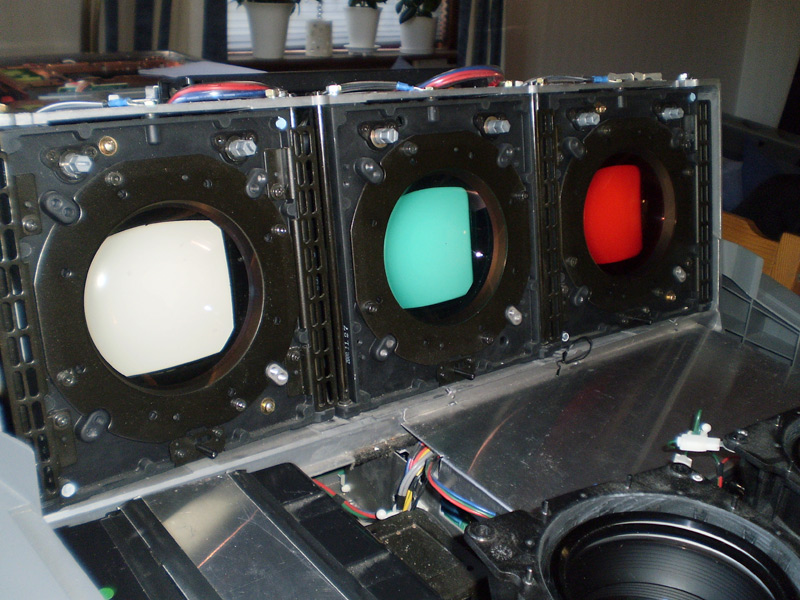

ElTopo wrote:
Are the HD-134 so much better ?
I did not try the standard but i like the look of HD-135 and they sure can give a good focus of the phosphor. Laughing

Yes, yes we do like those lenses. If you got a set of HD-18 lenses and c-elements you'd want to sell, let me know I am looking for a second set right now! Smile
