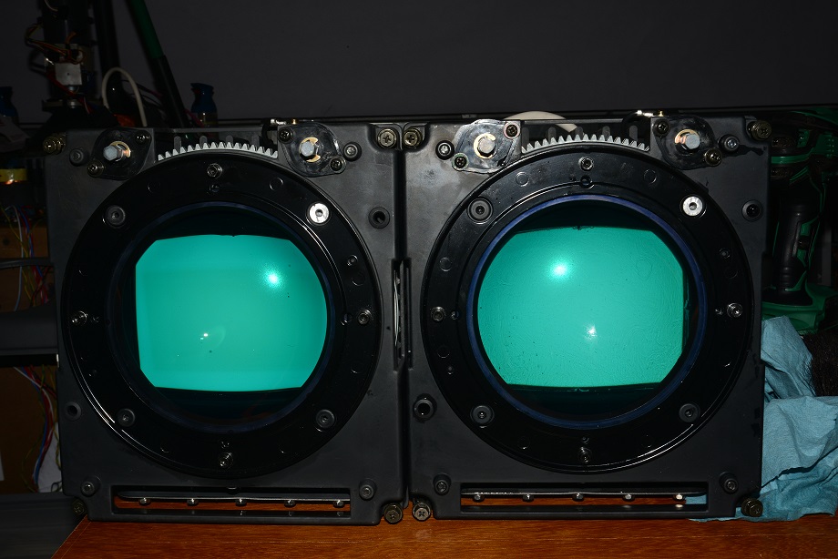

Tonight I replaced the last worn tube in any of my running G90s.
This shows you how picky I am about tube condition.
The tube on the left is being replaced due to wear. The tube on the right is new, or in new condition,
and is going into G90 no. 3.
As of now I have three G90s all with tubes that are that good. Unit 4 is a "parts unit" unless I score a YA board for it
at a good price. I'd rather put it back into service than scavenge it for parts at this time

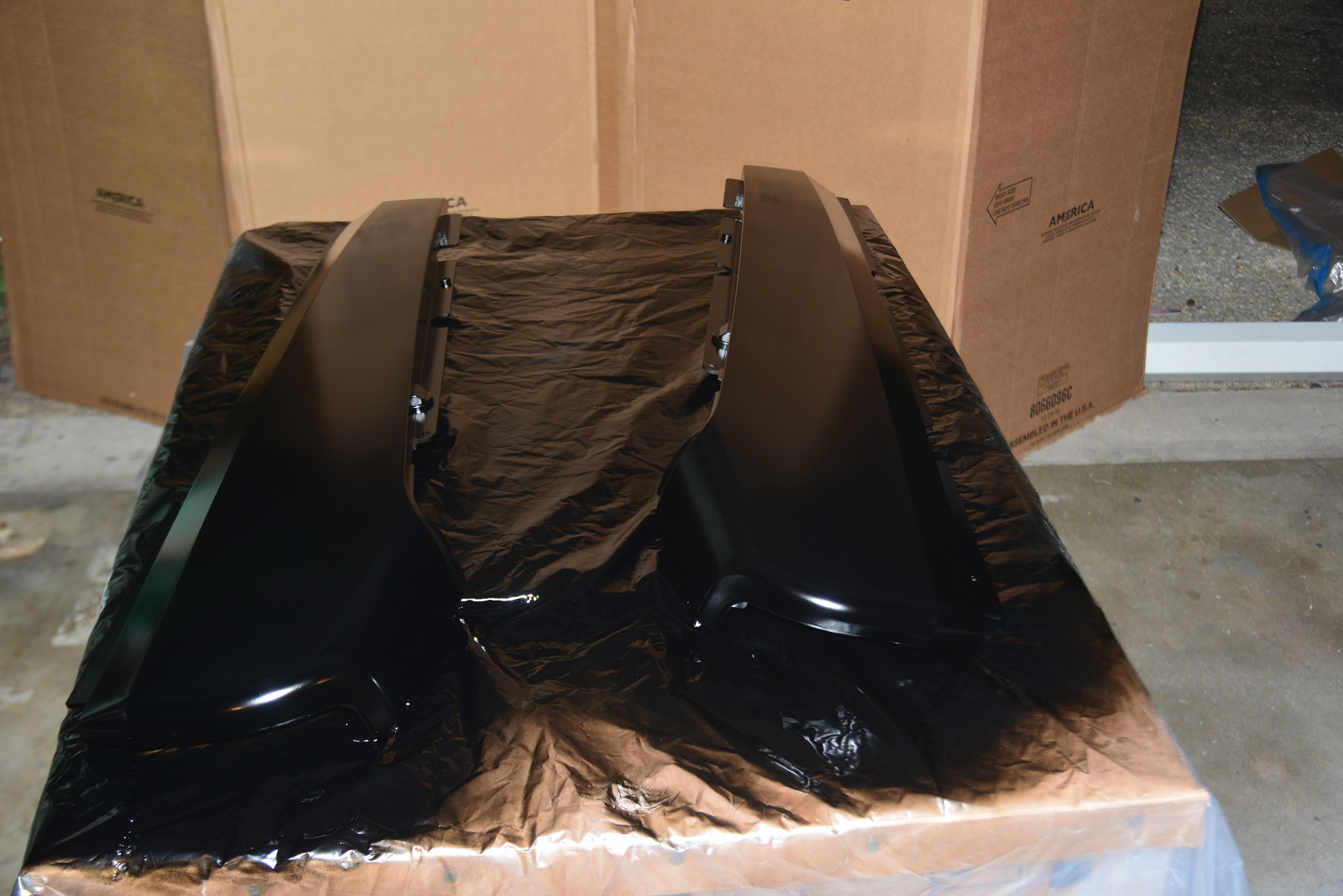

OK, I'm painting a G90 case set.
I'm doing the bottom section in full gloss black, and I'm doing that painting job myself.
The upper section is being done in the purple you see here, and that is being done by a professional because the top
cover needed bodywork to be ready for a full gloss finish.
As of the time of these photographs being taken, I've only done the black basecoat. The gloss clearcoats go on later tonight.
Clue 2: Top color.
 Filesize:  94.02 KB
 Viewed:  9369 Time(s)
Clue 1:
 Filesize:  467.11 KB

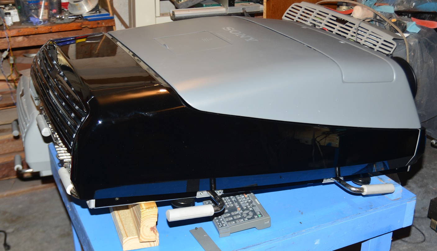

Posted: Sun Jan 22, 2017 11:36 pm    Post subject:
Stage 1 of the repaint is complete. The repainted top cover should be back in my hands about Tuesday.
So here's a photo of the chosen recipient of the newly repainted cover set, as it stands right now.
I'm rather pleased with the work so far. I'm doing all the prep and paint work for the lower case parts, including the flat sanding, compounding, and polishing. But the top I'm leaving to a pro due to the fact that the top needed a level of bodywork that I'm not confident I can deliver. When you can't do it right, hire someone who can.
 Filesize:  324.98 KB
 Viewed:  9161 Time(s)
Posted: Sun Jan 22, 2017 11:38 pm    Post subject:
Yes, I will be blackening the gap between the lower front cover and the sides. I may do something about those grey handles, too.
