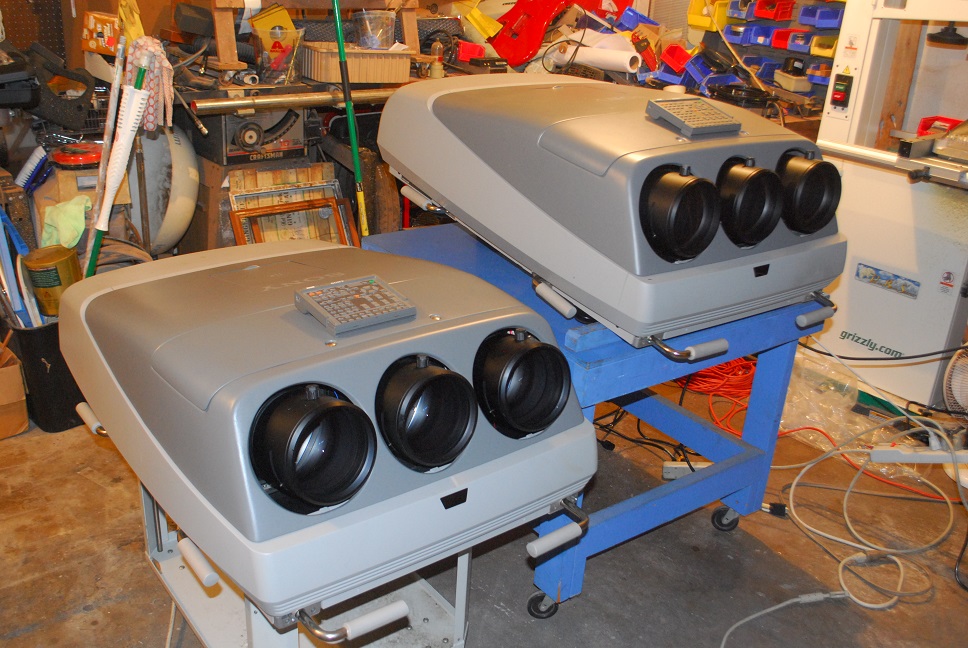

Posted: Mon Dec 05, 2016 5:12 pm    Post subject:
The twins. (Almost. One has the Faroudja option, the other has the HDMI input card. )

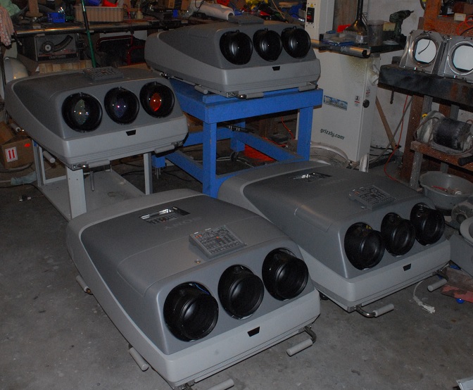

Posted: Sun Dec 11, 2016 4:42 am    Post subject:
The disease continues to spread...
