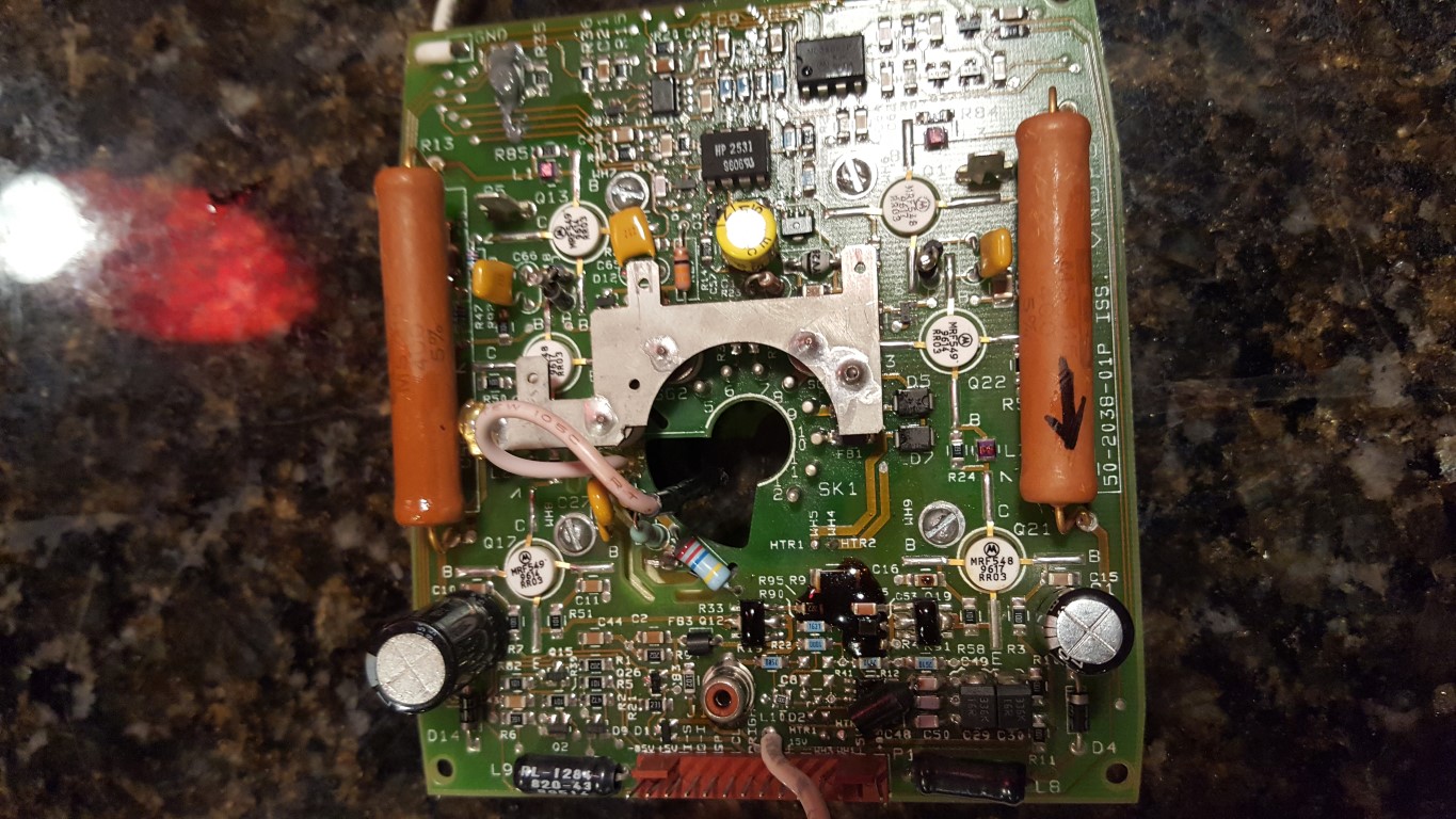

Hey gents,
Recently, my green tube stopped turning on when powering on the unit. I traced the problem to the neck board by swapping the green and blue VNBs and the problem followed the neck board. These are MP-modded VNBs, quite a few years old now.
One of the caps on the neck board looked suspect, so I replaced it. This worked the first time I fired up the projector, thought I'd solved the problem.
But the next day, the tube did not turn on when I powered on the unit. After 10-15 minutes while searching the forums, the tube suddenly fired up, good picture.
So at this point, I've replaced both caps on the neck board, and re-flowed the solder traces on the two large resistors. The problem persists.
Any other suggestions as to where to look? I'll likely re-flow the RCA connector next. (*replaced stock VNB picture with my actual VNB)
Thanks!
Scott

Posted: Wed Sep 07, 2016 9:32 pm    Post subject: Re: Marquee neck board needs to "warm up"
No, they are not modified by me. The only VDC modified neck boards that I've done are still in my possession.
Posted: Fri Sep 09, 2016 10:51 pm    Post subject:
Look at the 33 ohm Resistors and check the solder joints on those. Also the pic you're showing is the newest style neck board. What year vintage is your PJ? Or Give the Part number of the VNB.
Posted: Sat Sep 10, 2016 2:31 am    Post subject:
The photo indicates a board number of 65518-01 Rev A, which would make it a 50-270340-01A board.
Posted: Sat Sep 10, 2016 2:41 pm    Post subject:
I'd suspect a cracked SMT resistor or solder joint. This is something that needs to be attacked with a scope or meter, randomly swapping parts will probably make things worse.

Posted: Sat Sep 10, 2016 5:18 pm    Post subject:
Appreciate all the help guys, I've replaced the pic with my actual VNB in the first post.

Posted: Mon Sep 12, 2016 3:51 pm    Post subject:
When I zoom in, the end of R33 (the end of the resistor closest to the socket opening) looks a little dark/toasty, doesn't it...It might just be the bad lighting in the pic, but I'll start testing the resistors with the meter tonight.
-Scott
Posted: Mon Sep 12, 2016 4:06 pm    Post subject:
So you have actual MP modded 338 cards instead. That is a WORLD of difference from the newer 340 cards.
Putting up the wrong photo was really very misleading. "Hey, I've got a problem with my Chevy!" and you post pics of a Ford.
Resolder those big resistors, all four connections. That's routine.
I see that the 549 transistor in the lower left has been torqued. That's a little bit scary. Those leads are fragile. Without messing
with that, do take a moment to carefully inspect the leads for cracks right where they enter the body of the transistor.
How long ago was this card modded? There may be a date code on the big black capacitors which will give a clue. What is that date code, if there is one?
I'm asking that because capacitors have a limited service life. If they're more than 10 years old they should be replaced.

Posted: Mon Sep 12, 2016 4:40 pm    Post subject:
I'll check the transistor leads and test all the resistors. The mods are over 5 years old. I've already replaced the caps a week ago - one of them was a little ballooned and tested out of spec, so I replaced the caps on each neck board.

Posted: Wed Sep 21, 2016 2:26 am    Post subject:
Well guys, this is interesting. I've tested all the thru-hole resisters, re-flowed the solder on as many components as I could and tested the capacitors. Everything specs out ok. The filament light looks just like the other tubes.
The problem follows the neck card, as follows:
When I fire up the projector, the tube is either very very low output, or completely off. If I gently tap the back of the neck card with the handle of a screwdriver, the tube comes to life and the pic looks great. It doesn't seem related to the RCA cable connection, as I have tried jiggling the RCA separately but nothing changes - it seems to need the "tap" to move the card slightly. It almost seems more like the socket connection itself is flaky - doesn't seem to matter where I tap, as long as the tap moves the neck card a little bit on the tube.
I tried spraying some De-Oxit into the socket holes on the card to no avail. I also tried crimping the G2 Bias connector a little to make a stronger connection, but the symptom persists!
Any other ideas, or do I just leave a screwdriver near the PJ?
-Scott

Posted: Thu Sep 22, 2016 1:47 pm    Post subject:
Thanks for the tips guys. I tried re-flowing the socket pins, and took a look into the pins with a glass but couldn't really see anything out of sorts. Unfortunately it didn't solve things.
It may still be a component - I tried to hold the board still while I tapped the components and it seems like the tube kicked on and off more when I tapped near one of the capacitors. I've checked and rechecked the solder joints, as I recently replaced those caps, but I'll keep trying.
I even took a close look at all the SMT resistors like Curt suggested, but I'm not sure if I have the "eye" to catch anything less than an obvious problem on those tiny things.
Barclay, thanks for the suggestion of the cold air shot - I'll see if I can figure out how to try that - unfortunately its a tight fit and the components on the neckboard face inward - I'm not sure if I could shoot cold air with any precision, but I'll definitely have a look - thanks.
-Scott

Posted: Fri Sep 23, 2016 2:52 pm    Post subject:
I tried the cold shot, but it didn't cause any immediate change. I tried chilling the caps and the resistors, but it didn't seem to have any effect.
If I gently (and carefully!) "wobble" the neck card back and forth on the tube neck (using an index finger to gently push the large resistors alternately), it seems like I can make the tube cut in and out.
So strange - really points to an intermittent socket connection, doesn't it? Maybe I'll try moving it over to the red tonite to see if its a "better" fit on the red, but I don't have high hopes.
-Scott
