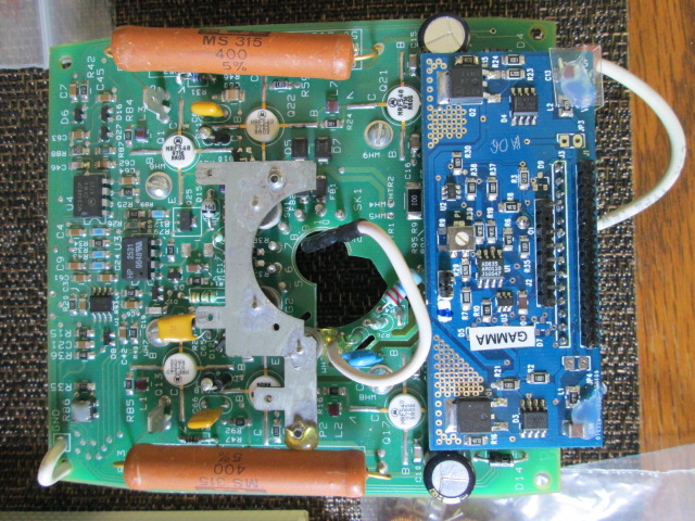

During the work with the ULTIMATE VNB-DB I managed to measure the output speed of the VNB.
The VNB was modified so the whole input opamp circuit is bypassed, and Q19 was directly driven by my pulse generator. Q19 was replaced with a faster transistor, a 2SC3613 (3,5GHz). On the picture the K output is shown, with no apparent load, only the FET probe (~1pF), the output is 60Vpp, the rise time is 3ns on picture. After correcting this with the self rise-time of the generator and the scope we get 2.6ns rise time out of the VNB, that roughly equals 135MHz clean sine bandwidth at -3dB roll off.
I'd like to note here that one should NOT confuse these numbers with pixel clock and so on, the rise time have real meaning, which is well defined.
So far this is the fastest rise time out of a CRT driver I've ever seen.

I was in hurry with the testing, so I haven't made any photos, but if nothing else I'll record the performance when I build my own ULTIMATE VNB-DB next time Smile
In this case the performance is only limited by the neckboard, while testing the board I could not detect any bandwidth limitation on the ULTIMATE VNB-DB board even at full output drive, but my measuring setup is bandwidth limited to around 250MHz so this is not surprise. But this also means the VNB itself limiting the bandwidth. There is a posted neckboard rise time, that measurement was taken on one of the neckboard's used for this project.
The gamma neckboard is for the blue, yes, the gamma circuit BTW is the same as with the AD835 version VNB-DB.

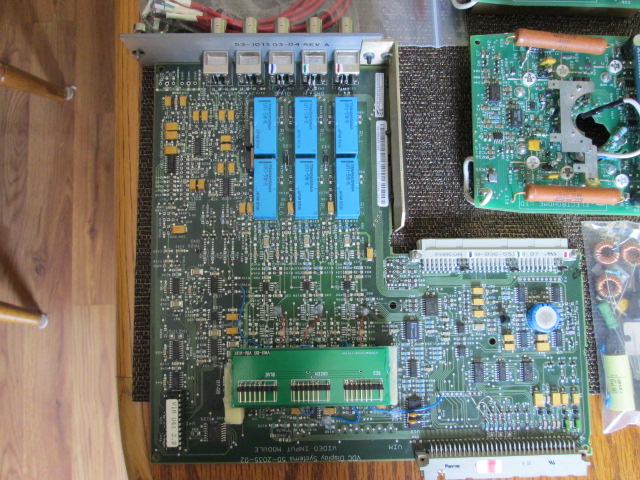

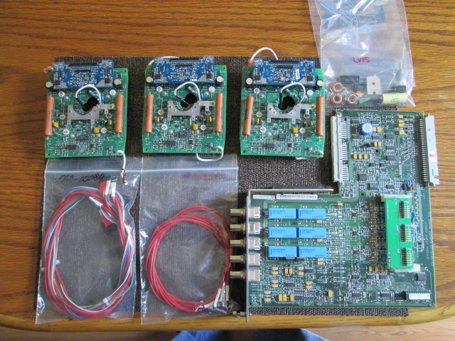

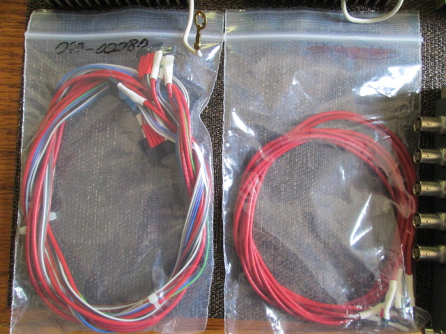

Some pics of the package sent from Gabor. I hope to have the projector up and running in a couple weeks. You'll notice that there is not any gobbed on crap covering his secret mods!

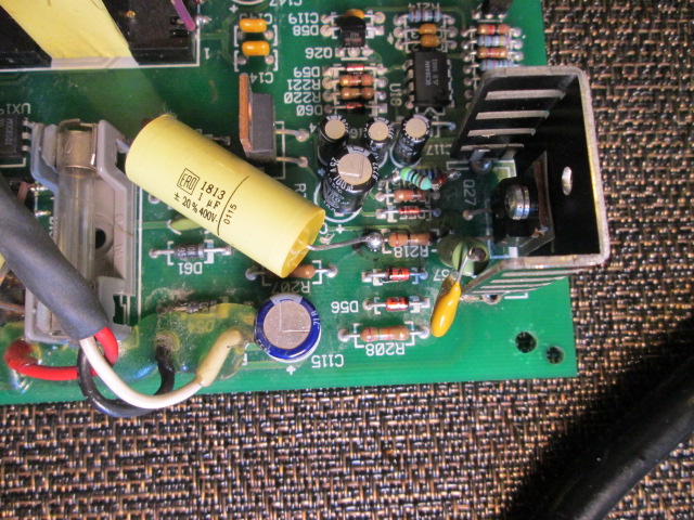

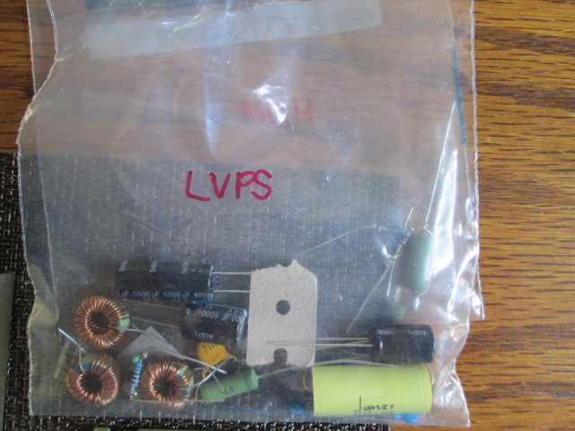

Solder work done on the LVPS and HDM.
