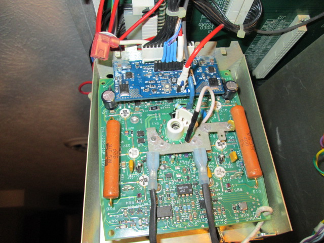

I have a ground wire (White-top left hand side) in the pic which the old boards did not have and I do not see a tab for the quick connect. Any ideas where to secure?

Every neckboard came with those two grounding cables from factory. The one you ask should tied near the VNB power connector, there are two tabs on the lower part of the cage, one is even visible on your picture, between the red video cable and the corner of the VNB power connector...
Also make sure to connect the G2 lead to pin2.

Thanks.
Just making sure to install as Ehome did.
