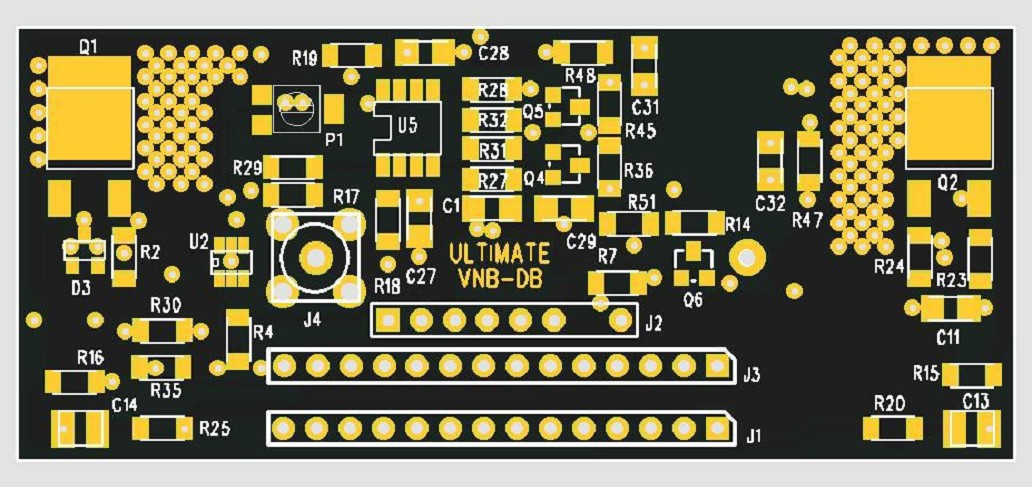

The ULTIMATE VNB-DB featuring the AD834 multiplier on a black 4 layer gold plated PCB, and gold MCX RF connectors and so on, planned to be a limited edition only 3 sets to be produced of which one will be available on the market.
 Filesize:  143.74 KB
 Viewed:  19783 Time(s)

Posted: Mon Apr 03, 2017 4:44 pm    Post subject:
One step further again Smile

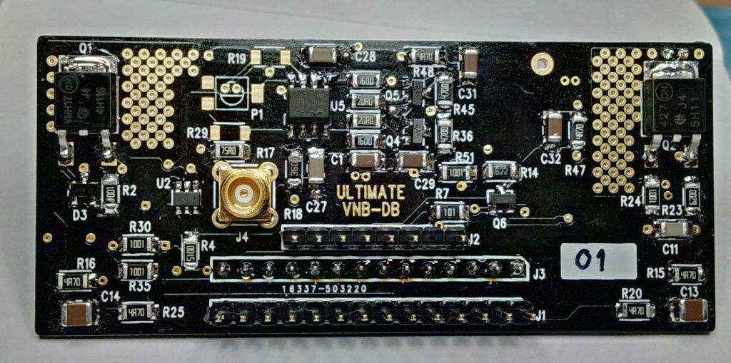

Posted: Fri Apr 14, 2017 3:35 pm    Post subject:
I just finished with the assembly of the first ULTIMATE VNB-DB, the tests start soon.
Assembled Ultimate VNB-DB
 Filesize:  128.46 KB
 Viewed:  15843 Time(s)
