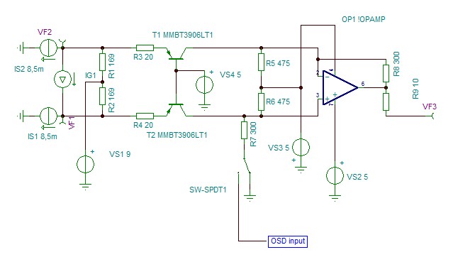

Here is the simplified version of the AD834+Z circuit, it is by far more simple than the previous idea, although here the switch is involved into the signal path to some extent as R7 and R8 should be kept in balance at any circumstances.

Posted: Thu Jan 12, 2017 12:53 pm    Post subject:
gjaky wrote:
After all it turned out this gamma concept is essentially the same as what was made in the Barco 909 -which I did not understand for a long time how/why is it working… It is a popular trick to disable the gamma on those barco boards but there the input derived signal was switched by conventional multiplexers, with only 4 fixed settings and even the resistance wasn’t kept at a very low levels so they had to peak those dividers
It was a good idea to do it that way, and I'm with you in that I never could figure out how it worked either. Limited with only four settings, but the bigger problem was here as you also indicated:
also in the barco the gamma is made in a separate AD835, that made a difference in signal chain integrity between green and the other colours as well
On your design you seem to have gotten around this and when I was modifying that same board I removed those gamma stages.
And with your design not having or adding another circuit in the chain, it's a win all the way around. Especially knowing how difficult it is to keep 1920X1080P intact and as true to the source as possible.
I admit this later gamma solution is not tested in reality yet, but the new PCBs are already under manufacturing, and I expect to have them in two weeks or so. Worst case the gamma feature can be disabled, not many projectors have usable gamma feature if any at all…
Hey, that's what its all about, and why it takes so long to get these stages right. Turning theory into reality is the challenge. And so far, you're on a roll. I remember well, the many PCB designs I got in the mail and at the end of the day, I was back designing another.

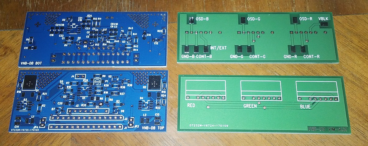

Posted: Wed Jan 18, 2017 6:05 pm    Post subject:
So the postman came...
Blank VNB-DB Boards

Posted: Wed Jan 18, 2017 6:44 pm    Post subject:
Did he ring twice? Laughing
Posted: Wed Jan 18, 2017 7:09 pm    Post subject:
I don't know, my wife took over the package... Very Happy
Posted: Wed Jan 18, 2017 7:16 pm    Post subject:
Awesome work!

I put together the AD834 circuit like above (AD834+Z_simple.JPG) on a blank XG-VNB PCB, it seems the simple idea works quite well, the switch does not seem to interfere with the input signal.

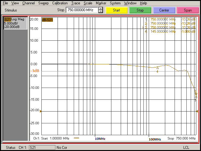

We measured the bandwidth of the circuit at work on a 9GHz Vector Network Analyzer as well. The circuit was tuned relatively convervatively for bandwidth, it uses 2SA1765 PNP transistors and CLC449 opamp. the output shown below was recorded at 2V amplitude. As can be seen, it remains within 1dB up until 250MHz, then falls a bit, but leaves the -3dB point finally slightly over 500MHz...
AD834 VNB-DB concept with simple +Z solution.

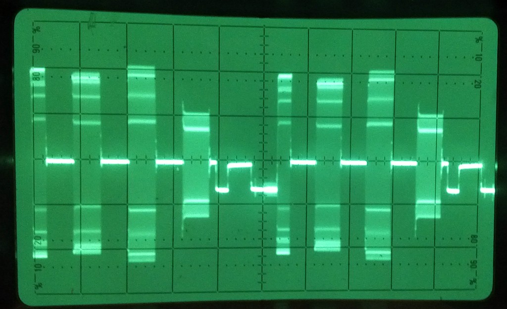

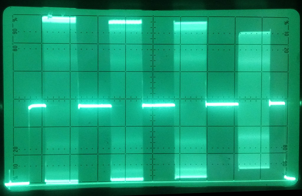

I decided to post some information on stock VIM boards I have here.
The goal here is to demonstrate their bandwidth that actually reach the VNB.
About the measurement rig: The source is my trusty old Asus GeForce 6600GT videocard in an appropriate computer, The card was set to output 1080P 72Hz, the test signal is a multiburst signal with 4, 3, 2, 1 on:off pixel sequence on gray background.
First the output of the videocard was measured after 3m of conventional d-sub to RGBHV cable, fisrst I tested how this signal looks on my oscilloscope:
You can see some roll off towards the right side of the scope screen, ideally all "box" should be equal in amplitude. Nevertheless the roll of as calculated is about -0.3dB between 1:1 and 4:4 pixel pattern, this implies the imperfections of the DAC output of the videocard, my oscilloscope's finite bandwidth and the cable's attenuation, it is what it is.
This signal was then fed to a bone stock 02p VIM from 1998, the contrast was set to maximum (but I did not care to max out the drive under white balance settings). The output of the signal was observed on oscilloscope with using the original ~60cm mini RCA cable (which is a Belden RG-179 coax on my machine) as interconnect, so this is the actual signal that would normally reach the VNB in stock conditions:
Here as you can see the output at 1:1 is rolls off quite much, down to about the half of the amplitude than the other boxes, this corresponds closely to -6dB roll off, this of course includes the imperfection of the input signal too. There is some peaking at 2:2 (not seen at input!) as it has higher amplitude than the 4 and 3 pixel wide sequences. But generally the uniformity of the boxes are similar to the input signal.

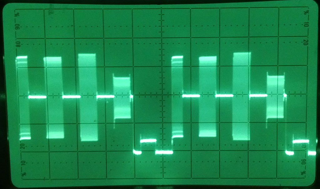

Just for fun I tested an old (1994) M9000 03p VIM that uses AD834 analog multipliers and HFA1100 opamps.
Here the bandwidth is not better not even by a tiny bit. What it is worth noting that there are bands inside the "boxes" those were not seen at the input, those mean reflexions/disturbances in the output signal generated by the VIM itself, I checked the signals in more detail and the pulses have a really ugly shape, this board produces very high distortion!
Tomorrow I want to perform this same test on my VNB-DB board's output.
Stay tuned! Wink

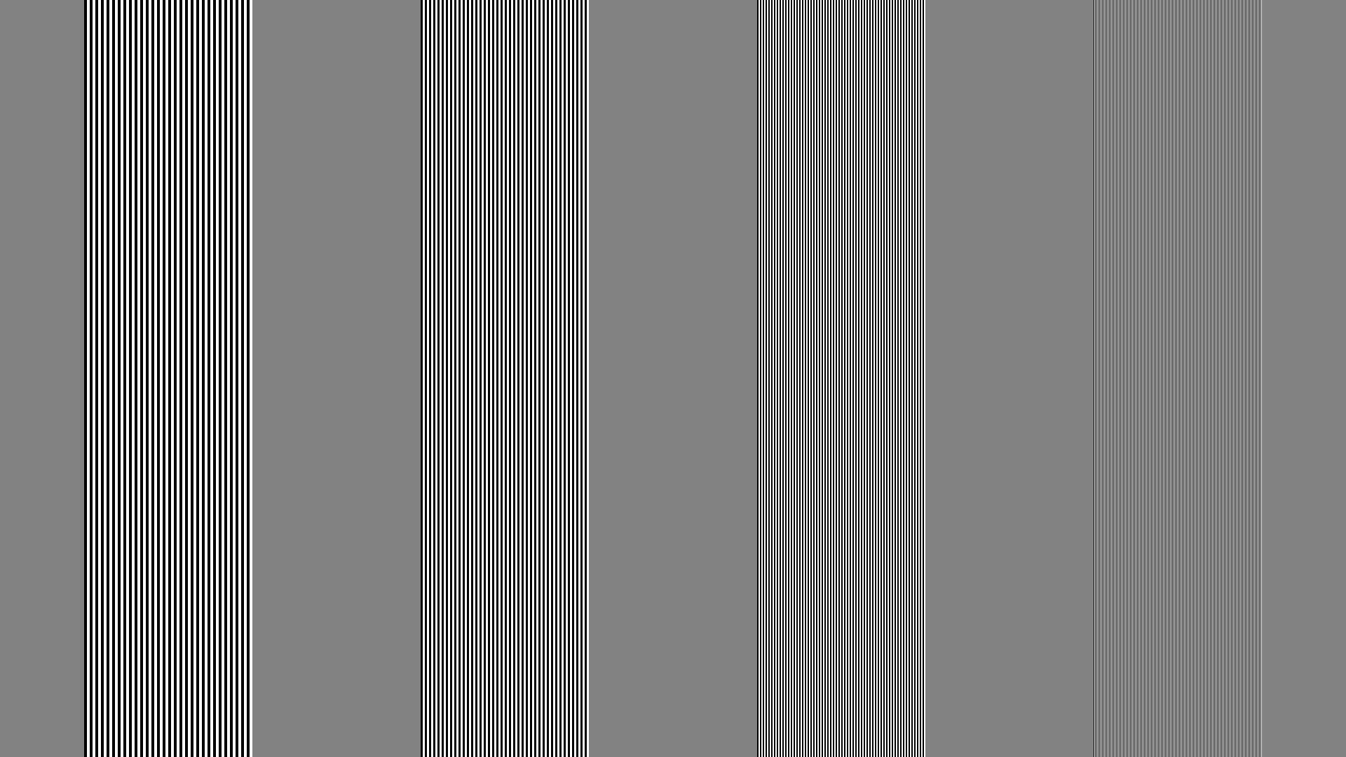

Would you mind sharing this test pattern with me?
I'll do then the same with my system to see how it looks.
regards,
Ron.
barclay66
Joined: 27 Jun 2011
Posts: 1304
Posted: Wed Feb 01, 2017 8:26 am    Post subject:
This should be the corresponding file...

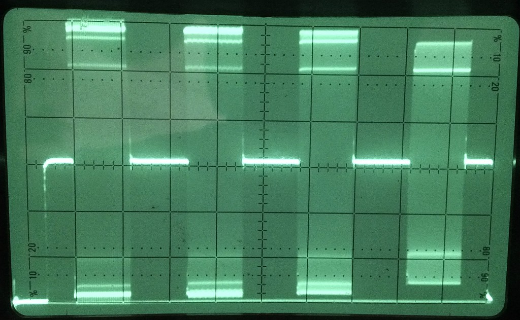

Posted: Wed Feb 01, 2017 4:50 pm    Post subject:
So I finished the first VNB-DB on the newest PCB.
The first good news is that the gamma correction is now working as it was intended -without affecting the bandwidth.
But lets look at the bandwidth of the VNB-DB as it was promised.
The settings are the same as yesterday (1080P 72Hz), here also there is obviously some roll off, but after doing the math this gives -1dB roll off only (of which -0.3dB is directly can be addressed to the input signal). I want to note here that the rule of thumb definition for the decibel scale is that 1dB difference is the smallest change in the signal what an observer can detect.

Posted: Wed Feb 01, 2017 5:02 pm    Post subject:
That's not roll-off, that's normal when using a Multiburst pattern @ 1080P.
When doing multiburst at that bandwidth, its best to go dual probe/display (before/after). Showing them both at the same time one above the other.
