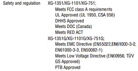

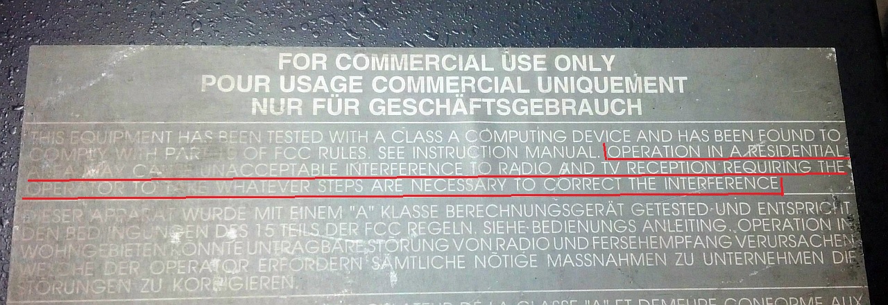

I am glad you bring up this FCC stuff. I don't know if you ever bothered to read the sticker in front of the Marquee. See picture below.
Indeed a running Marquee interferes with my FM radio on my desk, despite its strong shielding. But guess what, the NEC projectors does not harm FM reception, moreover they are passed on residental rules as well without lead shields... For that matter, when I worked on the XG project I didn't have to chase down chassis noise to operate the VNBs with daughterboards.
In the end it was possible to run the daughterboards in the Marquee after all, the fact that the Marquee is generating much electrical noise in its stock form can not be an excuse for not using delicate circuits.

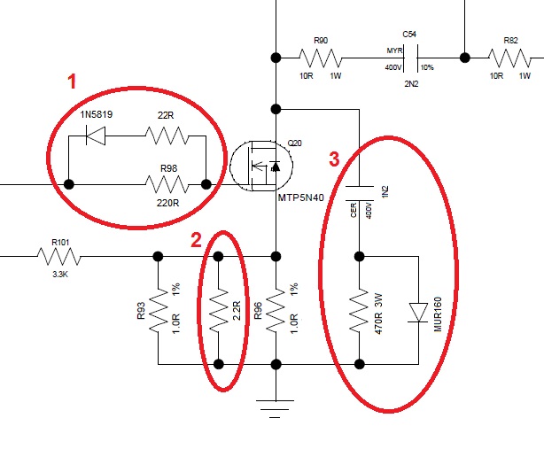

Here is some useful info.
On the picture below you can find a part of the latest VDC HDM's schematic, the circled parts are sign the difference from a standard old HDM. the most important part is the Circle 3, that serves as snubber for the switching FET, this way reducing the electrical noise into the chassis.
Circle 2 is I think standard for ULTRA HDMs.
Circle 1 is smoothing the switch on characteristics of the FET.
All parts can be found at DigiKey.

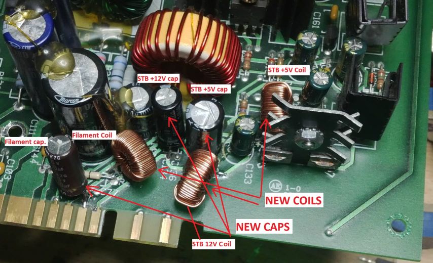

Also here is a picture about the LVPS modification. I found some nice 220uH toroidal coils in the local electronic shop, those were much smaller than the 100uH I initially tried, the current rating of these coils should be greater than 1A. For better filtering I added three caps as well (1500uF 10V for the filament and 1000uF 16V for the STBY +5V and STBY +12V), all low ESR capacitors (organic caps more preferred).
There is not much space inside, so the traces must be cut for the coils. There is no good place for the filament cap so it is best to install close to the output connector, there are several ground vias at least.
The two separate pins (far right) on the LVPS connector goes to the HVPS (warning live when plugged in!), then the second big part is for the various boards.
-The filament + is the second from right.
-I simply installed the STBY +12V 1000uF cap on the C134 cap
-I installed the STBY +5V 1000uF cap instead of C135
-I installed the STBY +5V coil close to the 5V regulator, I cutted the trace directly at the output of tha IC.
-The STBY +12V is the first for mthe right, there is plenty place for install that coil.
