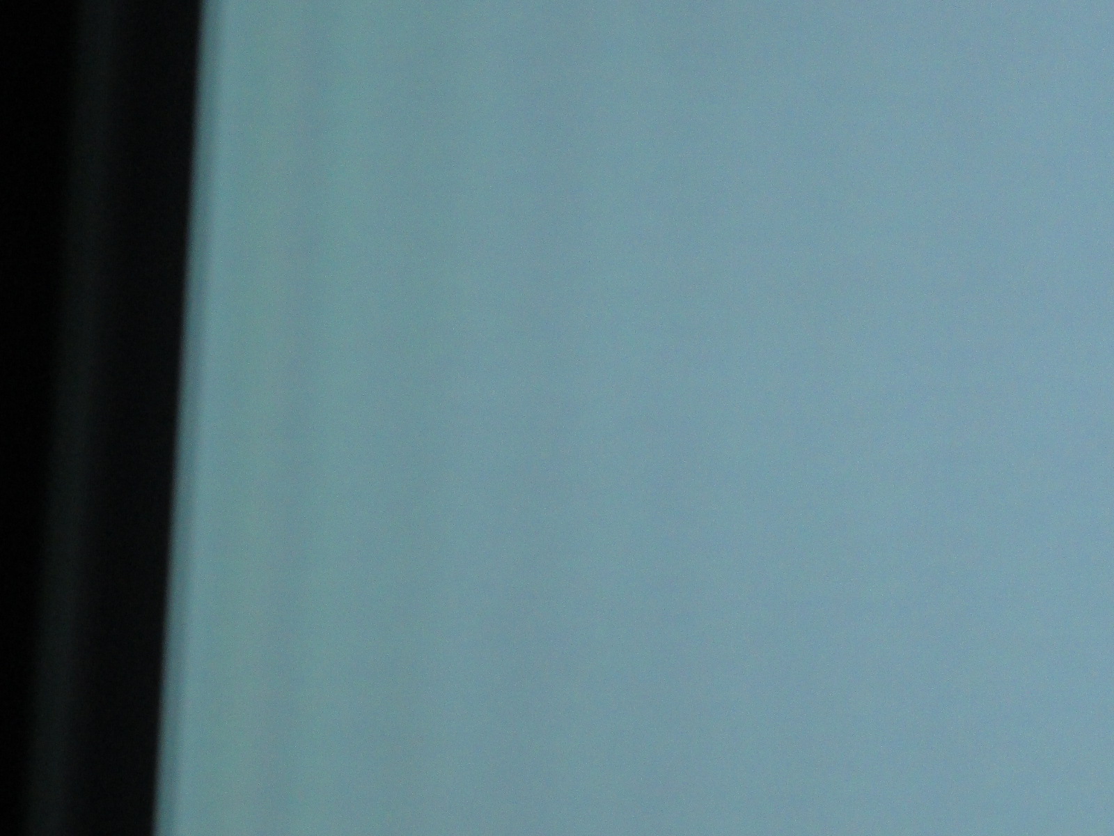

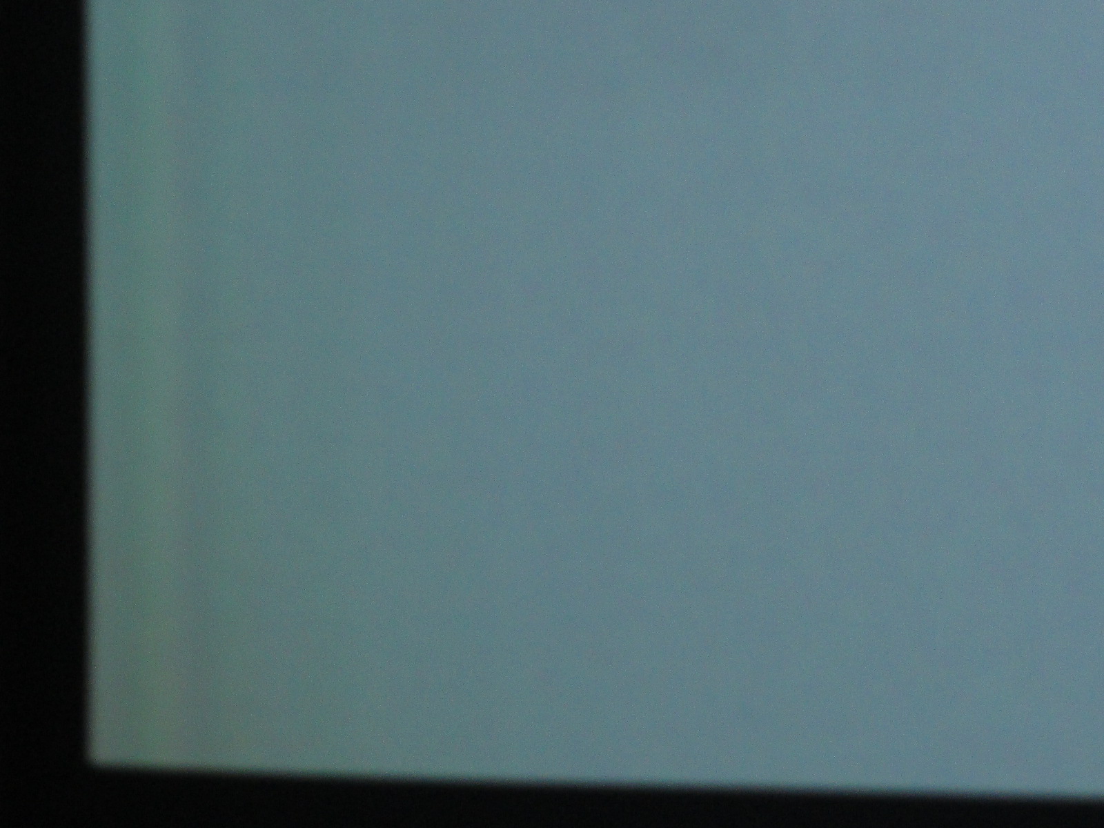

Here are pictures of the left hand side with the vertical bands. I can see very faint horizontal banding, but is negligible compare to what is shown.

That's ringing, it's in the deflection yoke system, and I have yet to see a Marquee that doesn't have it to some extent.
It's scan frequency dependent. The higher the scan rate, the more noticeable it'll be, and the space between the bright and dark areas will become smaller.
Is there a fix for it? I don't know. I think the ringing could be damped but the fix might only apply to a narrow range of scan frequencies.

Thanks Chris,
I can play with the timing if that is a viable direction for a fix.
