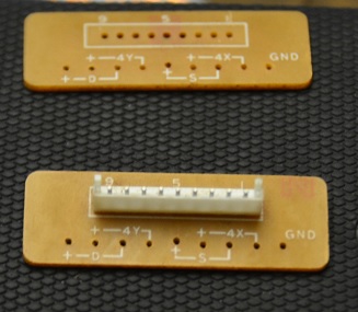

Now, you want to REMOVE THE WHITE CONNECTOR. Use desoldering braid or a solder sucker, and get the solder off, and carefully remove the white connector.
Why? Because this is MUCH easier and more reliable than any other method. Even if you have a cable with the mating connector on it, and it's long enough, it's still labor intensive to adapt the other end of the cable to plug into the focus board. But you can do that if you want to. I just don't bother with that.
Refer to the first photo. It shows two of these little connector boards, one with the connector still on it, one with the connector removed.
These boards were taken off yokes that were extensively modified, years ago. I do NOT recommend that you completely remove your boards from the yoke assemblies. It isn't necessary.

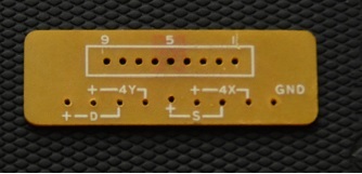

Now is a good time to look at the board carefully and make note of the markings on the brown side. They are very informative and will guide you in attaching wires where they need to go.
Refer to the photo of the connector board all by itself, clearly showing the markings.
From RIGHT to LEFT, that's pins 1 to 9 in that order, you have:
Ground (we will not use this wire)
4X- (4 pole astig winding, X axis, - wire)
S- (Static focus winding, - wire)
4X+ (4 pole astig winding, X axis, + wire)
S+ (Static focus winding, + wire)
4Y- (4 pole astig winding, Y axis, - wire)
D- (Dynamic focus winding, - wire)
4Y+ (4 pole astig winding, Y axis, + wire)
D+ (Dynamic focus winding, + wire)
We'll worry about the astig windings later.

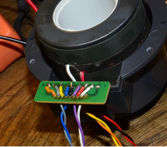

So, how to attach these wires? Strip them back, stuff the wire through the hole, and solder them?
Actually, no, I don't recommend doing it exactly like that because these little circuit boards have fragile traces,
easily lifted and easily broken. I've had WAY too many of them break traces just from the stress of light handling
after trying to attach the wires in that method.
So what I do now is I use a small drill and DRILL OUT THE HOLES, to a size that allows the wire WITH its insulation
to pass through. The wire takes a 90 degree turn and then is soldered directly to the solder connections on the
other side of the board. Refer to the photo showing the colored wires attached.

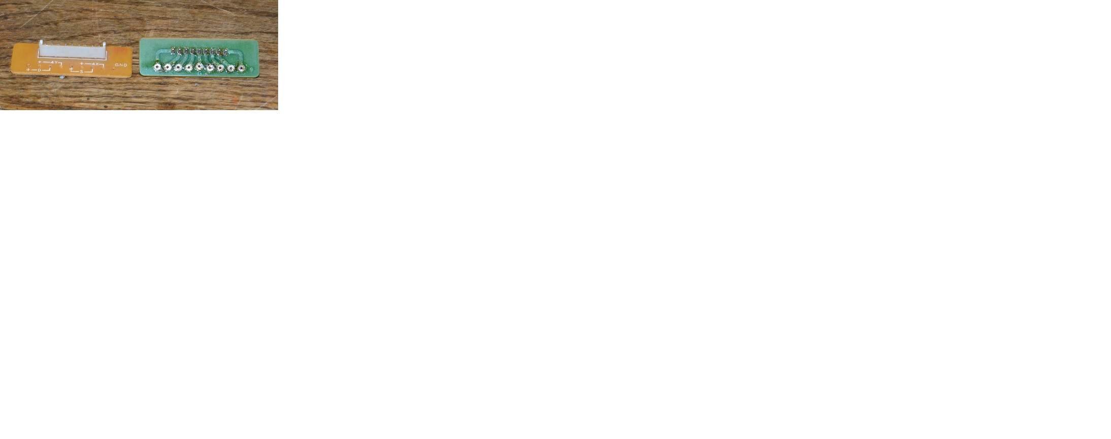

There's a fourth photo showing the back and front of the boards. This is there to show you that the wires run straight across without crossing each other. They're one for one, ground is ground at 1, 4X- is the second wire, S- is the third wire, etc.
For the astig windings, blue and grey is one pair, purple and white is the other pair.
Attach them as per the photo.

it draws too much current and can't be run in the green CRT channel because the HDM will complain. (Only the green
channel of the HDM has a current sense circuit. So I can run G90 deflection yokes in red or blue, though even then, the raster is still too wide and the HDM needs a mod for that, too.)
Focus retention with varying contrast levels has so far been excellent using the 3203 yokes.
So far I'm not so happy with the 3212 yokes. They work but they're "subtle", not giving me the range of focus that I expected. Those are a work in progress, while I consider the 3203 yoke to be mostly a success. I'm not going to say that there isn't more room for improvement and optimization, but I find that they work well IF they're wired up correctly and all the phasing of the wires is correct.
That's enough for one post!

 Filename:  yokeconnboard1.jpg
 Filesize:  89.69 KB
 Downloaded:  360 Time(s)
