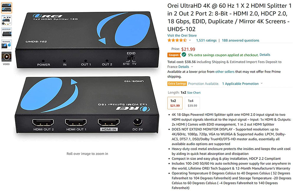

Craigr, thanks for your quick reply and please bear with my limited knowledge.
After doing some research, I found this 18Gbps stripper https://amzn.to/3mY2Wvm and the guy in this video https://youtu.be/kaawM-Kw85U?t=470 (watch from 7min50) says that it bypasses HDCP 2.2 at 4k@60fps.
What do you think about it ? Thank you.
It looks promising. What country are you in? If you have one shipped to me I can test it and then ship it on to you.

Well, never mind on sending me one. I just ordered one and will try and find time to test it next week. I'll post back.

I just tested the unit I received from Amazon and it DOES NOT strip HDCP 2.2.

I have received my copy of the UHDS-102 18Gbps and all I can say is that it strips HDCP 1.4 (I connected the input to an HDCP-protected 1080p cablebox, and the output to an ElGato HD60 capture card, and it works).
I don't have a 4k device so I wasn't able to test HDCP 2.2 stripping but I trust you, CIR Engineering.

That sounds easily plausible, and also quite likely based on your findings.
Unfortunately, I no longer have the unit so I can't clinically test your findings. However, if it's working than it's working right Thumbs Up
