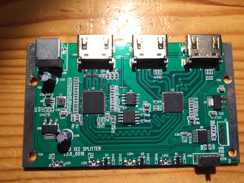

barclay66 wrote:
The model described by Craig can be found in Europe under the Ligawo brand. Model Number is 3080001. Just ordered one from eBay...
seems as if I'm lucky! The current Revision of the Ligawo splitter is completely identical to Craig's model.

Thumbs Up
