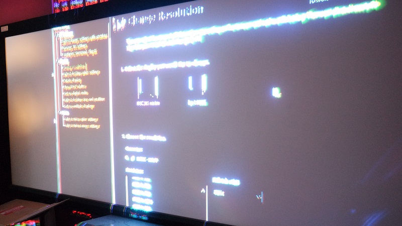

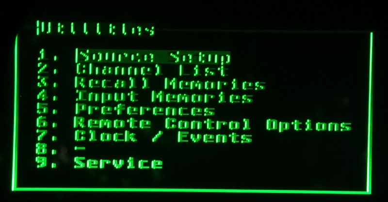

This never was about trying to use the VIM to its full potential. You've stated several times in the past that the VIM is one of at least three components in a fine-tuned video chain and that mixing it with stock boards or other mods would most likely result in anything but a fine picture. Rest assured that I was completely aware of this. My single goal was to verify the strange results that thewolfman had experienced regarding inverted colors and odd-looking menus (examples below). Having the VIM tested in a controlled environment -even without modified neck boards and Moome card- did certainly deliver enough results for anyone knowing what to look for.
And as You wrote that this VIM has a much lower video level, the difference in brightness is explained and just part of a normal behavior.
Well, I think that we now can rule out that the VIM is responsible for the effects seen on thewolfman's screen shots, especially since replacing Q2. I even would go further and say that the VIM is now working just as it is expected to do. Maybe even better as the menus appear undisturbed.

Thank you Jorge for your testing and fixing the Q2! I'll PM you about shipping details and a little something for your efforts.
But the board is still unacceptable in my eyes, with being to bright and pale now, as shown in the Jorge's images. But we worked out a plan on some changes on the exchange board, so thanks to MP as well for working with me on making this right.
You can't use his setup to make that determination. There are too many variables required. You can't just insert a VIM and display an image.
The propose of his testing was to look the distorted text and check Q2 to see if it was shorted and could cause the a dim image. If changing Q2 did not effect the image, then Q2 was ruled out. Using that VIM on his neck boards was not a good test to determine i the image was DIM. that version boards as I've also explained to you ARE not as bright as other boards. So in comparison, they would be dimmer, but at the same time, the only way to see what's what, would require the neck boards and Moome.... but that was not why the VIM was sent to him by itself
That same video chain in my Marquee the G2 levels were near 50 bright 50 contrast 75
