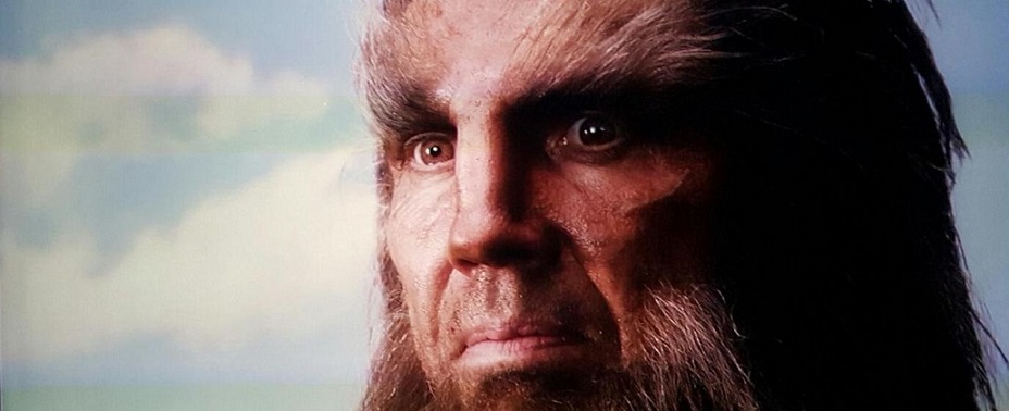

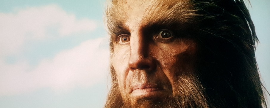

BTW
Took a screen shot from my phone with one 909 running compared to a JVC HD750 AKA RS20
Dunno why colours look odd but it was taken from my phone.

What shot is the 909 ?
Barco Cine 9 the one and only
huggy
Joined: 02 Aug 2008
Posts: 927
Location: Melbourne,Australia
Posted: Thu May 26, 2016 9:01 am    Post subject:
Top one sorry Very Happy

ElTopo
Joined: 07 Nov 2006
Posts: 1640
Posted: Thu May 26, 2016 2:38 pm    Post subject:
What are those yellow stripes ?
Which one is color calibrated Laughing

gregstv
Joined: 27 Aug 2007
Posts: 628
Posted: Thu May 26, 2016 8:28 pm    Post subject:
How does the stack compare with the JVC?
