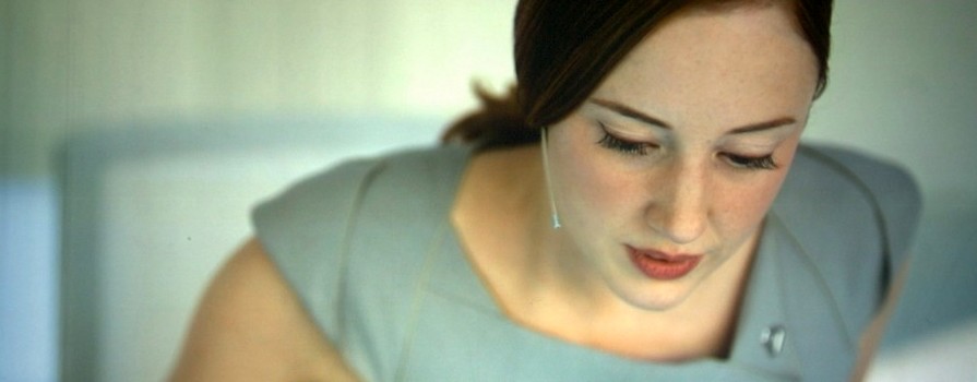

Posted: Tue May 17, 2016 6:04 am    Post subject:
ElTopo wrote:
What movie is that ?
The dressmaker
Proud owner of stacked 909's on a 12 ft wide 16:9 screen.

Posted: Wed May 18, 2016 11:57 am    Post subject:
Cant get camera settings right, any advice?
