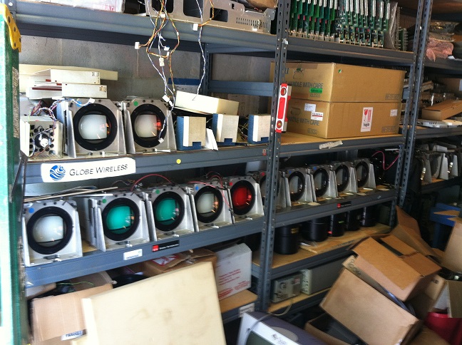

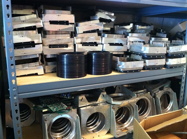

Posted: Sun May 08, 2016 9:36 pm    Post subject:
A few samples of what I'm dealing with:
 Filesize:  164.48 KB
 Viewed:  8398 Time(s)
 Filesize:  154.88 KB
Posted: Sun May 08, 2016 9:37 pm    Post subject:
I've still got a lot to do to get things better organized and more into the shelving. Space CAN be made!
