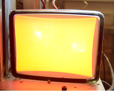

The red looks absolutely perfect. No visible wear or defects of any kind. Of course it's going to get potted up in short order.

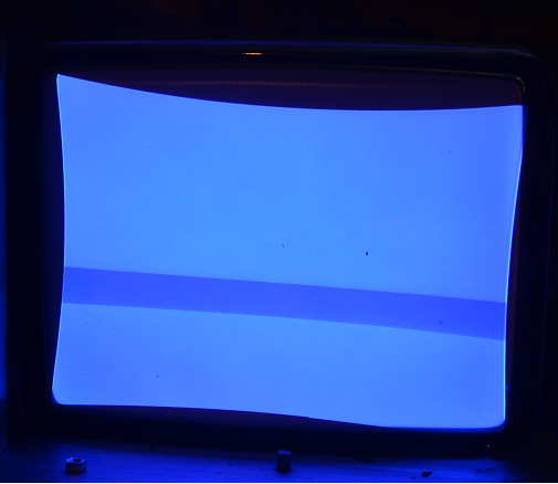

The blue appears to have been rejected for a phosphor flaw you can see. One tiny little black spot in the upper right middle area. This is very sensitive and fresh, G2 and drive levels needed for a good grey scale are very low as is typical of a new tube, and I believe that it is in fact absolutely a new tube still in its first hour of usage.
Would YOU be happy to find this tube in your projector? Or would you complain?

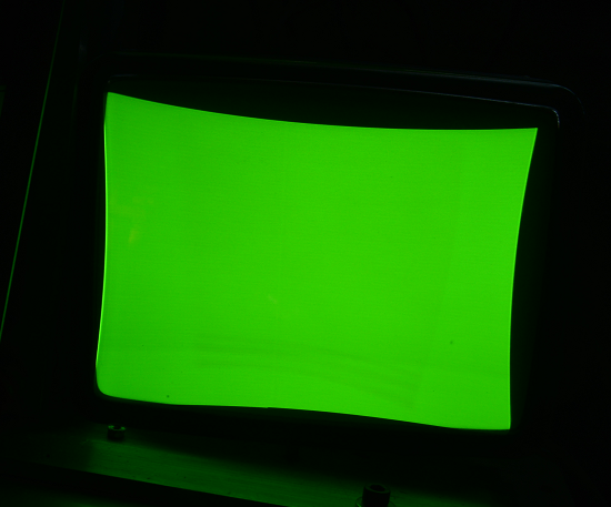

The green is also a very fresh-acting tube. Super low G2 and drive levels. But it does have some very slight pattern
wear. It's visible, but most of it would be outside a 16:9 raster area. I'm going to hold off on potting this one
until I've reviewed my other 8 greens. I suspect I have better ones.
My goal: Two perfect sets of tubes to convert my two 8500s to 9500LCs. The red one is good enough.
Is the blue?
Would you find the green acceptable for (A) movies and TV, (B), gaming, or (C) get that trash out of my projector! ???

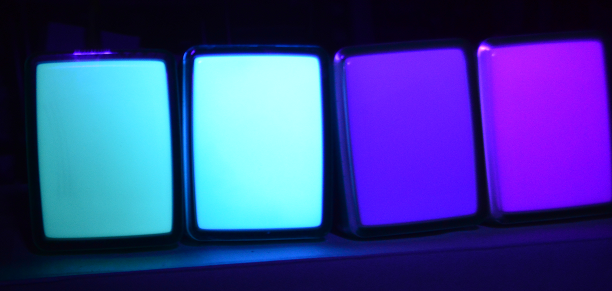

The first pic is a photo taken of several CRTs illuminated by a black light. It activates the phosphors and allows me to
see wear that is not visible in white light.

You can see that I'm trying to be pretty critical. You don't even see the wear pattern on the green unless you look at it for a few seconds. At least that's my impression.

Oh..the broad line in the blue tube is an artifact of the photograph. A longer exposure would have eliminated it. No such bar actually exists on the CRT face.
The yellow hot spots in the red are also camera artifacts. I have no concerns about the red. It IS perfect, and I can see absolutely no wear on it at all.

Red looks pretty good, green has a little wear. Someone can likely enjoy the green at the right price. Unfortunate that there is a dark spot on the blue, but possibly usable for someone.

I have been running a green tube with some ordinary wear for years, and I do not notice it unless something comes up all white or all green.

The spots on the blue tube are not visible with the tube turned off. It may be a condition that can be covered under VDC's warranty. I have made inquiries. Hoping for a positive answer.
What's really weird is that the "dead spot" glows just like the rest of the CRT phosphor when illuminated with the blacklight.
This indicates that the phosphor is being blocked by a contaminant inside the tube which is adhered to the back of the phosphor coating.
There is a slight chance that the blocking contaminant can be knocked off by gently tapping on the tube with a rubber mallet.
But before attempting that, I'll find out about warranty status. I don't want to risk breaking a tube that I can exchange.

My dwin has a blue tube with a wear pattern that looks worse then that green tube
I wouldn't complain about it as I have seen worse (try near or toasty tubes)

From my point of view, the red one is the only one that I would put into a PJ for sale. The blind spots on the blue makes it completely unusable (except for testing purposes where spot burn may occur). The green is somewhat tricky as it incorporates a psychological element. The viewer not knowing about the light usage pattern may not notice it at all during its remaining lifetime. The one knowing about or noticing it (depending on setup, content etc.) could feel increasingly annoyed. Even in situations where the actual edge between used and unused phosphor is invisible. At least that happened to me at the time I had to use a green which had a very light pattern. Once i had noticed it on a very bright scene, I got stuck into "scrutiny mode" looking for it whenever I watched a movie...

I agree on the blue with Barclay, I had spotburned tubes some time ago, and even if I can't make it out directly looking at the raster they were well noticeable on screen. Now I see not one but four spots on the blue, these are easily noticeable even on the bare tube, so they will be huge projected on screen.
Also the green pattern is way too narrow, it will be instantly noticeable in 16:9.

Sorry, I can't afford charity work. Besides, there may be hope for that blue yet. If I can get a warranty replacement, that's awesome. If I can't, the contaminant might be dislodged with some very carefully considered taps with a rubber mallet.
Personally I know I could live with that blue dead spot if I didn't already have two perfect sets of tubes for my personal projector. But I'd want a discount for it!

I wouldn't be happy with it, nor would most people I would think. You should sell it as is with a picture and description of 'phosphor defect that will be visible on screen - see pictures' or similar.
This would completely avoid any situation where the buyer can complain. If you include pictures and are honest about it, the buyer can't complain.
Let the buyer decide. Though I doubt there would be many takers. You never know however.
