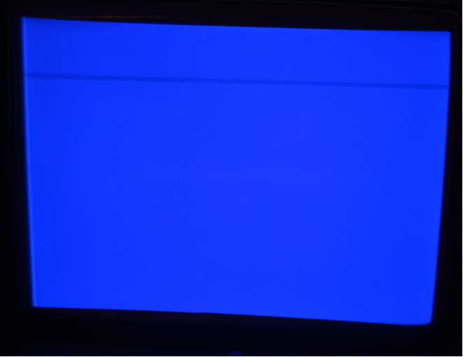

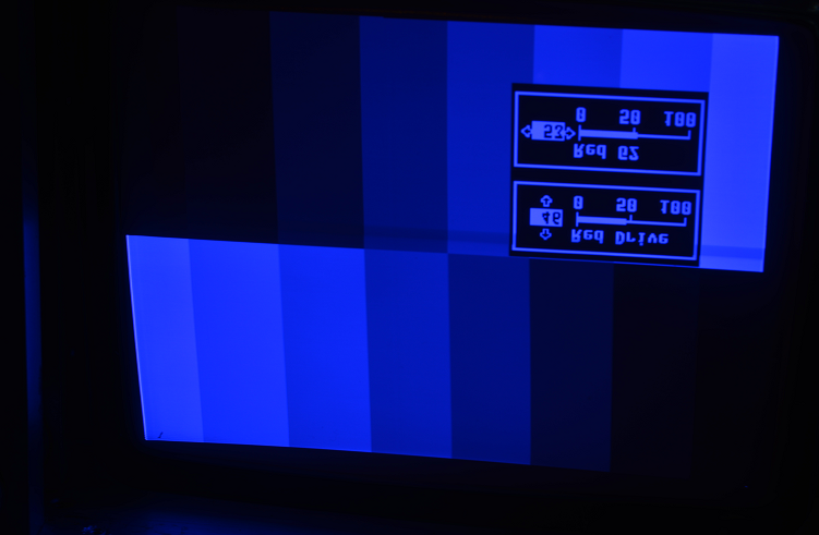

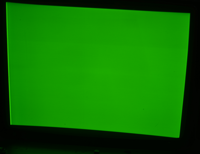

I've begun today's round of tube tests. The first green of the day is so simply perfect that it's gone straight to potting, no discussion or opinions needed. More later...
The dark band in the top range of the first photo is a camera artifact.

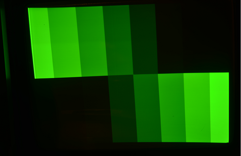

Third green, staircase pattern

Third green, full raster

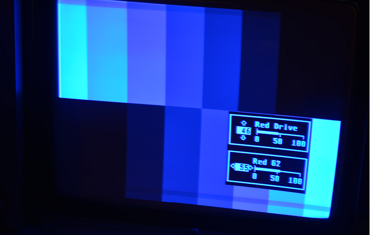

Third blue, staircase pattern

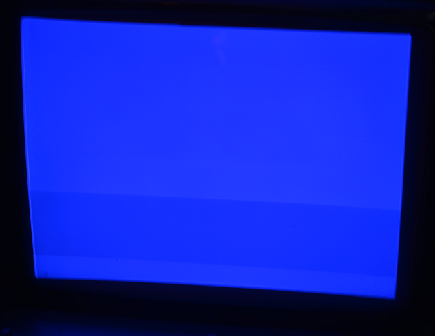

Second blue, staircase pattern
 Filesize:  388.57 KB

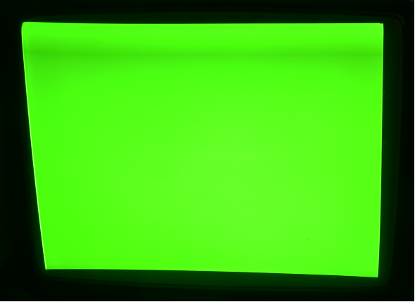

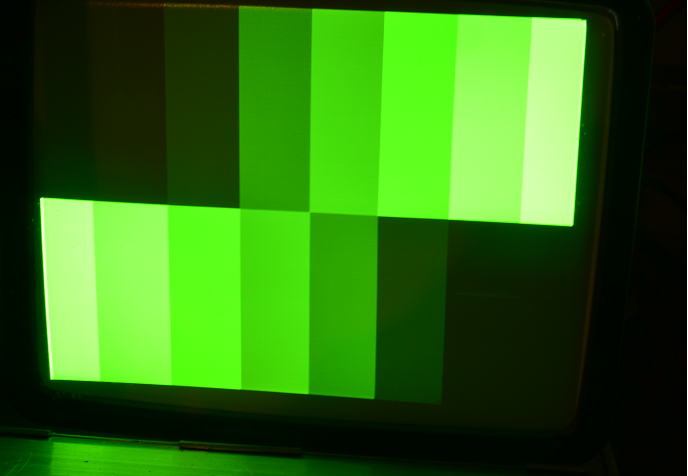

Second green, staircase pattern
 Filesize:  448.27 KB

Posted: Thu Apr 28, 2016 11:14 pm    Post subject:
It's a nice batch for today. Two blues and two greens tested perfect.
But due to my own fault, I damaged the vertical amplifier by accidentally shorting the VDM pins on the tube under test. No problem, I'll swap out the amp board with a spare tonight and then test some more tubes. I think there are two reds and one more blue to be tested in this lot.
The current tally of tubes that are definitely worthy of potting up is two greens, two blues, one red.
