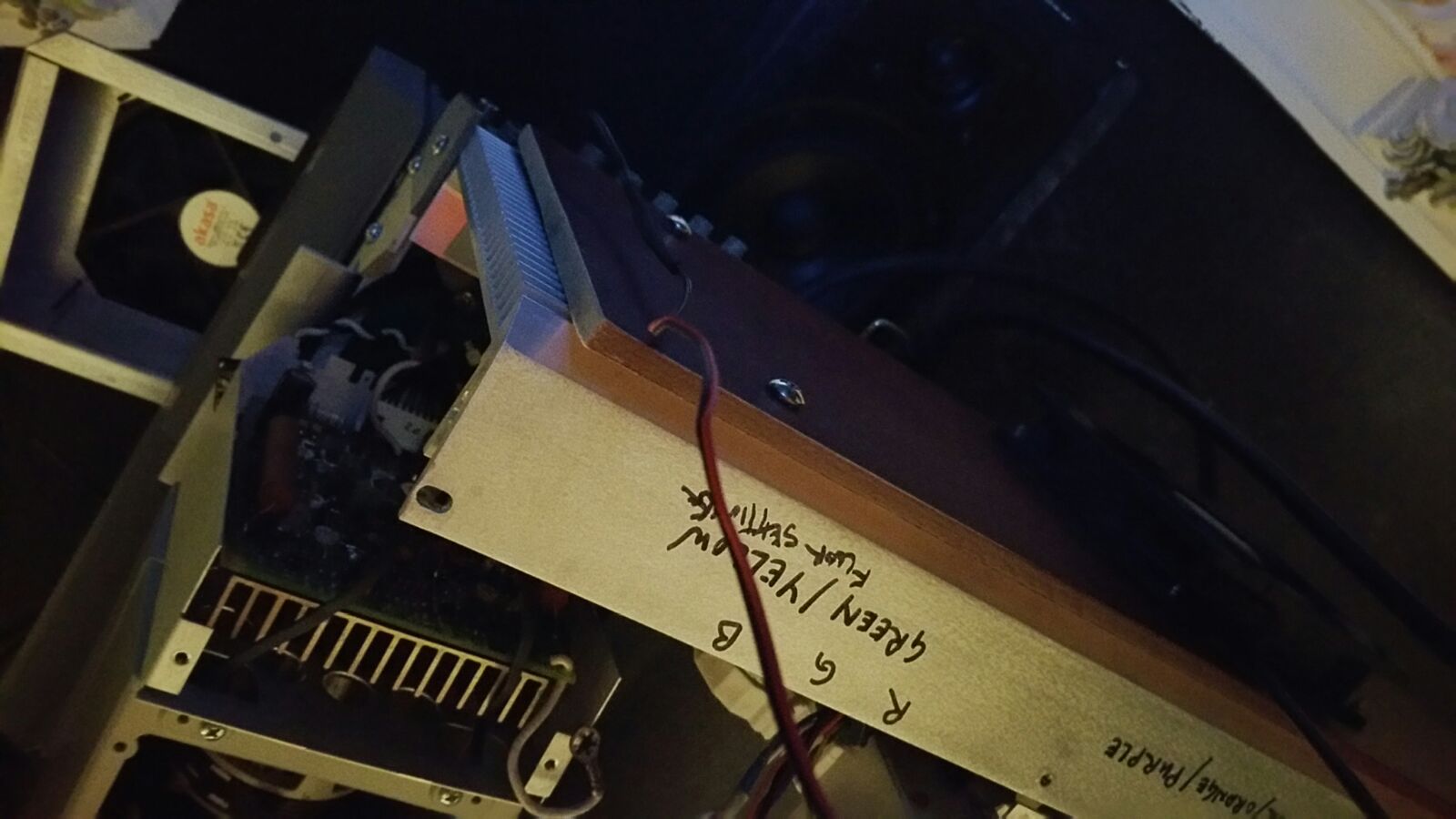

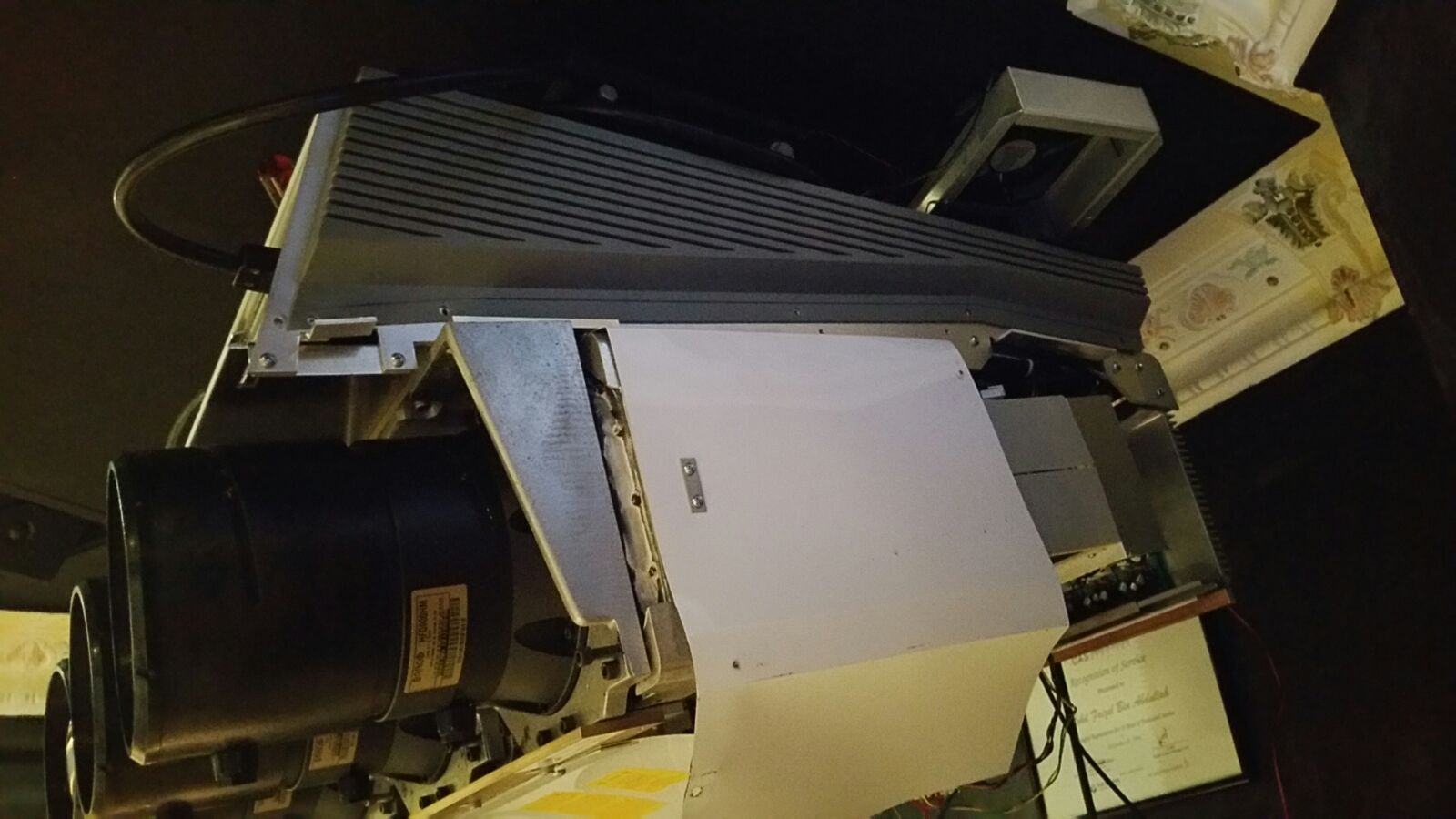

Thanks to everyone for your contribution and concern. The set that I got from Curt was perfect and I'm extremely thankful to Curt for selling me at a very good price eventhough the shipping cost is very expensive to Singapore.
Just for clarity, I made a mistake when I assemble the unit to the ceiling. Everything is perfectly new and there's no leaking on the bellow. What happen is that I made some modifications to the top 3 fans + another fan that I installed on the rear heatsink (it was very quiet with my existing Vision 1). After installation, I start the machine and found the fans were extremely nosiy eventhough it has the same setup with my first Vision 1. Due to this, I took my existing Vison 1 modified fans and installed it right above the projector and disable the fans in the projector. I did not realised that the fans did not actually cooling the HDM and that why it shorted it. Julian was spot on when he was curious on why the HDM overheat.
By the way, I will buy some materials during the weekend and hope that the new HDM can be repaired. It is way too costly to ship one back to Curt (US)and ship it back to Singapore.
Disable the modified fans fron the unit and place the existing Vision one modified fans on top of the projector.

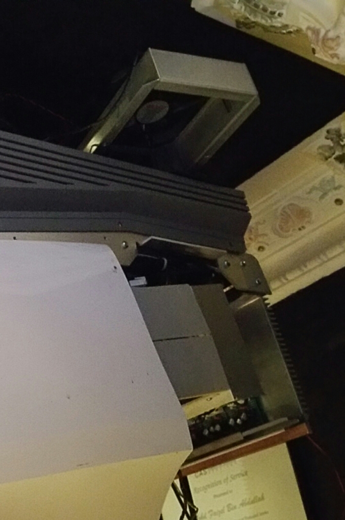

Oh, yes i do get the photo. You additionally use the original belly fans blowing down on top of the ceiling mounted pj?
They should be fitted tight to the chassis, the airpressure through those little holes in the sheet metal won't let enough
air pass through to cool the HDM and FGM.
If you want to discuss cooling, we should most likely use another thread, this one could get messy otherwise.

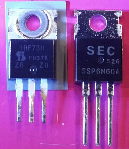

R93, 96 & R1001 - All are bad. I bought 1ohm resistors for R93 & R96 but couldn't get 1/3 watts. They only have 1/4 watts. Anyway, I have bought them and do let me know if I can replace them.
As for R1001, they only have 1/4 watts and not 1/3 watts. Can I use this value of 1/4 instead of 1/3 watts?
R62 - Good - no need to replace.
R91- Good - no need to replace.
R98 - Bad, schematic drawing indicate as 10ohm but actual resistor colour code as Red Red Black Gold which is 22ohm. Anyway, I have bought 10ohm 1/2 watts as per drawing requirements but not too sure whether I should buy the actual resistor on the board. May need you to advise me on this.
As for IRF730, the shop doesn't have the exact mosfet but recommended me to use SSP6N60A (526) instead but I'm not too sure whether it's compatible.
I will wait for your advise before I proceed with the repair. If not compatible, let me know so that I could purchase them from Element 14 but it might take awhile before I could get them.

Don't use that transistor. Check ebay for IRF730 or get one somewhere else.
The one you bought has different specs.
If you found a 22Ohms resistor as R98, replace it with a 22 Ohms. Do not use 10 Ohms,

As mentioned in my upper thread (photos above), the real rootcause of the issues is known. It's due to my negligence of testing the external belly fans and placing it on top of the projector which did not provide cooling to the projector. During this testing process, I disabled the belly fans inside the projector (see photos above).
I didn't realise that the direction of the external test fans that I placed on top of the projector did not provide cooling to the HDM or the focus board.
I did the test in order to understand why the existing fans is so noisy and to make comparison with another set of belly fans from my 2nd set vision 1. In conclusion, it's not an existing overheating problem that I don't understand but the reason above is the root cause. Hope this explanation is clear enough.
