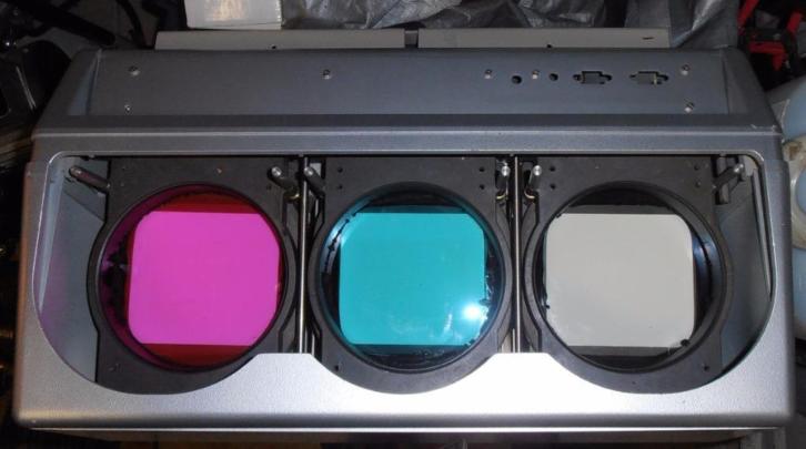

i whas wondering a barco graphics 801s is the same as a graphics 801. I'm able to buy a graphics 801 for a steal only it's defect because it will start up but won't light up only light fosfor illumination, but the machine part's are ok i guess. my barco graphics 801s is a ok machine only it's defenetly used and on it's last breath so i whas thinking swapping the tubes of the 801
and putting on the good set of hd8 rev b lenses and using the spare parts if needed.
anybody?

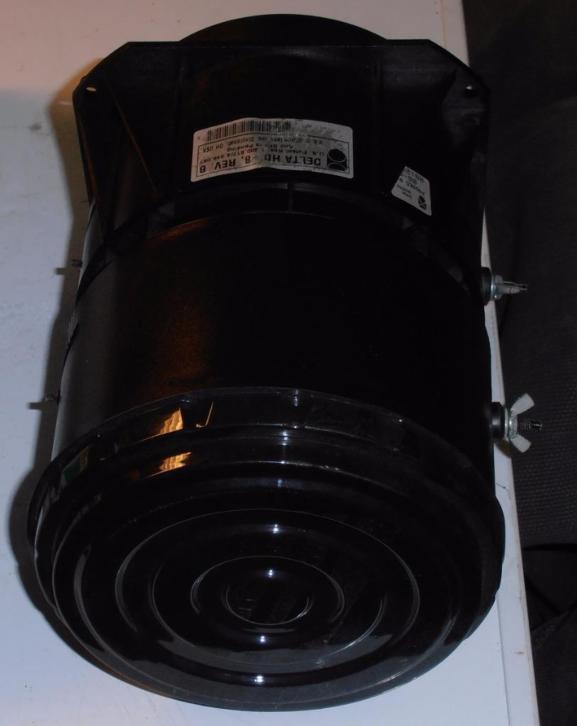

HD8 REV. B

No Wear or Burn at all
 Filesize:  32.62 KB
 Viewed:  24747 Time(s)

Yes, same set, same tubes, but from the pix you post, the front IR/RS-232 board is missing.

If you could use some HD8B, I have two sets of them in perfect condition and I am in Germany. So not much of shipping costs i think.

and did you mean HD8 Rev B? i got those with the set that is comming in.

When replacing tubes, you can always leave the glycol in.
But look very closely onto the tubefaces and check for yellowing of the glycol. It mostly happens on the blue tube.
Also check for white flaky particles in the glycol or corrosion of the aluminium surface.
If everything is ok, you can leave the glycol in there.
The tubes on your picture look good, but nothing is better than a close critical look.
The glycol is sealed in a flat "aquarium" in front of the tubeface.
You won't spill or damage anything, that container is tight.
I meant HD8 Rev. B, yes. Just in case your lenses are scratched or otherwise damaged.

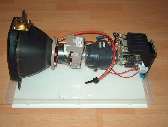

so they come out like this picture? and then swap it i guess Very Happy
swapping the beast

Yes, exactly.\
Once you remove the top plate over top of the tube/lenses, it will be easy to see how to take each tube out.

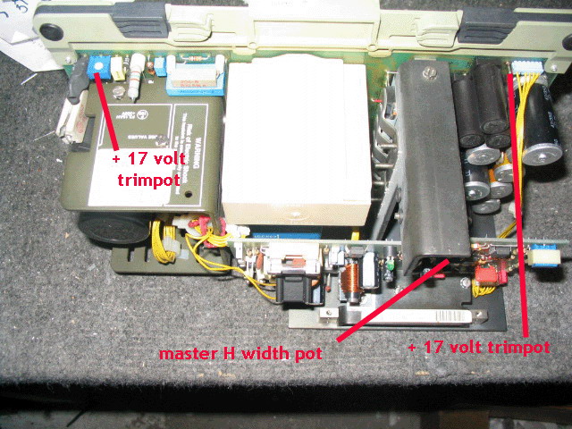

i just received my spear part barco and it comes with new/old stuff one thing i did is replacing this board just for fun to check if it's all working in my barco but some questions arrived:
on my board there is no white block. only a plate and some new shiny stuff. and the master width pod whas set on my old board to compensate with some width isseus. now that i put my new card in the same width remains? the board also makes a lot of noise when in heavy scenes on blu ray.
i also replaced all lenses with the best of the bunch because my old ones where scratched then i needed to do some light convegence now everything is fine but only the picture isn't really clear on the right side?
is this all a clear case of dumb assesnes on my part? or is this a case of some good knowhow? Embarassed

i figured it out tested all the cards from my new one in my old one and filtered out the bad ones so that means the falty cards resulted in no picture in the new one Thumbs Up
i'm whas able to replace the falty cards with my old cards and voila picture!! so i got two barco's now Smile

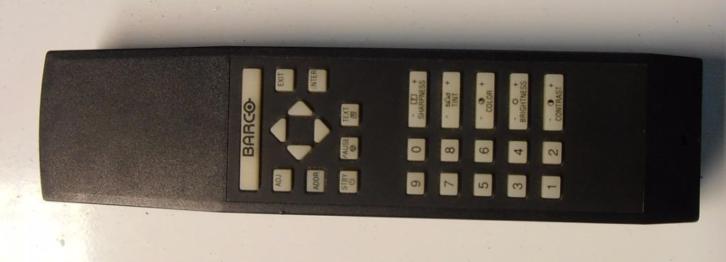

got myself a rcu error when testing my new bg 801 how to solve? no responce from my remote and a red light comes on saying rcu error Shocked

Aren't these RCUs internally wireable? Did you try it wired?
Regards, Julian

yep, did it with the back rcu and it worked!! only the rcu with infrared doesn't work you can put a audio jack cable in the front of the projector and wire it to the back of the rcu but it doesn't fit?

I've never used the front connector for the RCU on mine, sorry.
Did you try playing with the protocol switches on the processor board?
Maybe something is configured wrong there.
http://www.curtpalme.com/Barco500_Layout13.shtm
Could be that the remote is set for the wrong projector adress and or protocol.
I don't have the remote control here to check, so i think you should take yours apart and have a look.
Regards, Julian
Posted: Thu Mar 24, 2016 3:10 pm    Post subject:
hold down the ADDR button, and press 0,0,0. That resets the remote to the 0 address, and it shoudl control the projector fine. Sometimes the RCU changes addresses, even when you change batteries!
that worked for me great! Thumbs Up
