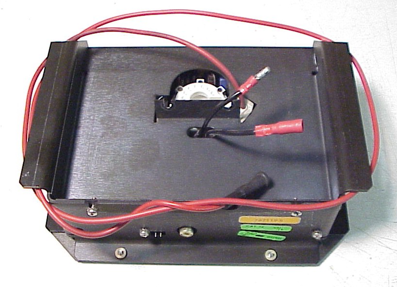

Posted: Sun Feb 28, 2016 11:03 am    Post subject:
redfox001 wrote:
Vpj08b on the cine8 809 and version vph06 on the earlier I am afraid 75MHz or so
image by Radio Head, on Flickr
They are nothing like the above. See attached picture below.
R7621195

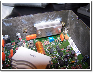

I believe the same neck board was used for the 1200 and 1209 the only variation was for Sony or MEC Tubes.
This is a shot from Greg Eisemann where he has changed the VPA13 for a VPA18. There are two of these in this amp type.
Greg Eisemann
 Filesize:  37.13 KB
 Viewed:  13822 Time(s)

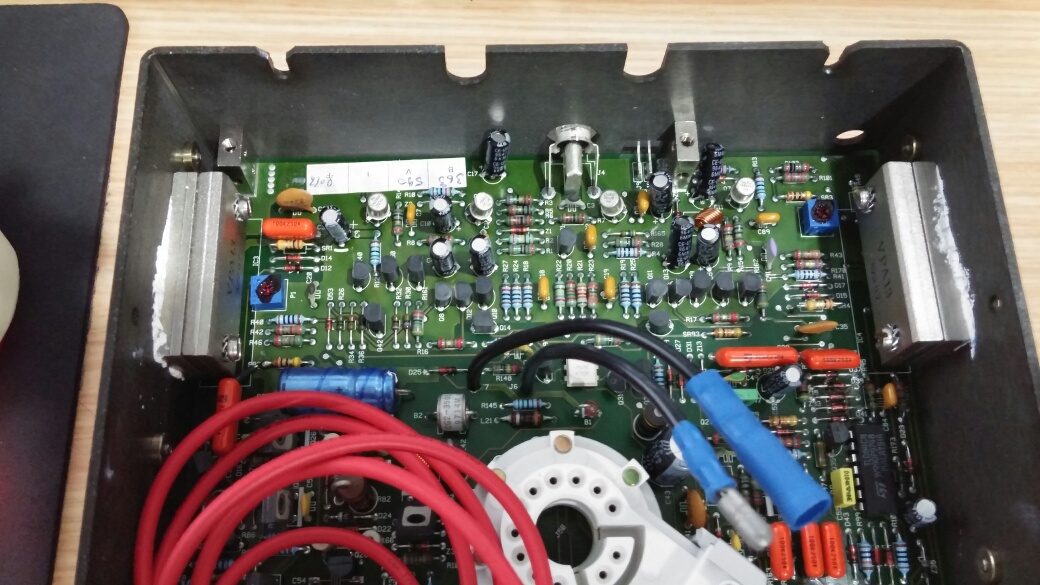

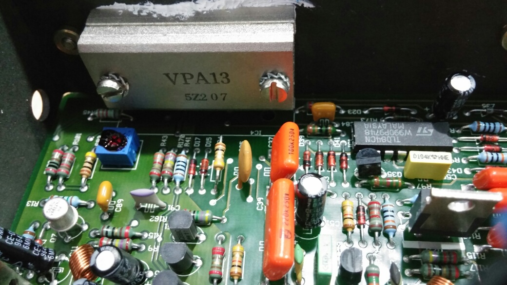

Posted: Mon Feb 29, 2016 8:08 am    Post subject:
Here is what I have. The part number is R7621191.
 Filesize:  227.65 KB
 Viewed:  13810 Time(s)
 Filesize:  236.26 KB
