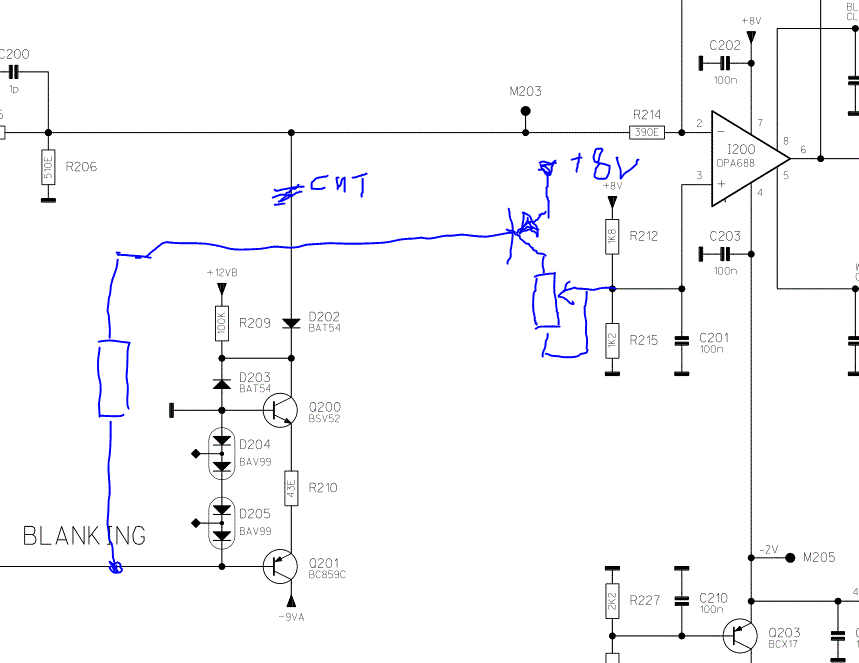

Might be an idea to use a scope to see what is happening there?

So the retrace lines should be very bright
OK, -9 at the input of the OPA means +8 at the output. This voltage gets inverted again by the 2. stage. That means FULL cut off. The ABL loop thinks "Oh, no beam. Must turn G2 high". Notice that the negative rail is -2V while the positive is +8V, so -2V ist the max. negative voltage that the op amps can provide.

Ok and -9 at the input of a 5166 dropped on the opa means +8 at the output too? Or was this calculated with offset and limitor?

I thnk I get you. Seems not so very complicated after all. The inverted opamp has a negative amplification. But we must let the blanking go to -5 V or so to get it operating with a 5166.

The +8 volts would be the "unclamped" voltage that appears on the output when you pull the inverting input to -9 V. So for your placement op amp, yes. In the original circuit it would be the voltage you set with the black clamp pot.

My idea is not to pull down the video to -9 V. Instead we can pull up the noninverting input via an adjustable pot. This will have the same result, but now we can adjust the blanking voltage without the need for clamping.

The offset is 3,2V the blanking 9V minus offset is 5,8V and that is close to the blacklimiting vallue set by p201.
So that means removing the clamping should not change so much?

I don't understand this calculation....
Anyway, the OPA is a voltage feedback amp.
This is the circuit i suggest, it might work:

About the calculation on the + input of the opa there is a voltage devider givind a voltage of 1k2/(1k2 + 1k8) * 8V = 3,2V
That has to be added to -9V giving -5,8V time minus for amplifying -1 gives 5,8V right?

Now that voltage is limited to the adjustable black limit at round 5V so what we have to do is change the blanking voltage to something like -8V to not need the limitor on the opa?

Ah, OK. There is the noninverting input, i forgott that.
My first tought was also to reduce the -9V, but maybe thats not good because the blanking switch is not well isolated from the input and this may affect stability. Not sure. Using the noniverting input also has the advantage of removing the blanking components from the input.

Ok that seems even better. I must say that in one discussion we have solved a lot of problems with the neckboards very good!
I am thinking that replacing the hfa1100 should be done even before anything else because it is much easier and migh give the same benefit in bandwidth.

I am not completely sure my calculation is right. Inverting opamp with offset. Looks like a differential opamp. V out = - V in + V off ? Would make it 12,2V

Oh, you're right... Anyway, it would be 8V.
