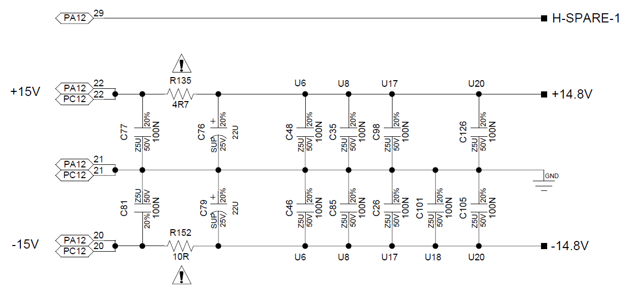

Yes CM, let me add that it could be a good idea to add a little resistance sometimes.
Depends on the voltages and currents involved, but it can be helpful.
A good cap parallel to the supply voltage and a fraction of an ohm in series.
http://www.2pif.com/images/low-pass-filter.png
If the results are not good enough, you can simply use multiple stages.
It's not too good for a high current/ low voltage supply, but it could be useful at .. let's say the 390V input of the HVPS.
Since the guys who developed the projector knew what they were doing, they added some (usually) 1 Ohms resistors directly
to the voltage inputs, then the caps.
Their second purpose is to act as fusibles.

Hm, those resistors are not for current limiting only. They act as a low pass filter together with the caps.
I've been playing around with a linear output stage for my fan controller/ regulator and since I'm using bipolar transistors now instead of mosfets,
i nee clean DC at the base of those transistors. Two resistors in series on + (440Ohm and 4k in my case) and a 2.2uF between them to ground serves well
if staing under or at 2mA. The trick here: By adding resistance, you'll agree that you can take the ESR of the cap out of the calculation.
It's effect will be neglectable small. You'll end up with a perfect flat DC like from a battery. Important is that the first resistance is bigger than the second.
If you're using a cap that has lets say 0.2 Ohms, you could use resistors with 0.5 and 1 ohms.
That transfers it into a more usable dimension for higher current applications.
Something else not anyone knows: It's always good to add a small ceramic or film caps, especially if you're dealing with higher frequency noise.
Those smaller caps have better high frequency filter performance, in particular the often overlooked ESL.
That's what they did in the above picture. And that may be why id didn't add any caps to my projectors yet.
I may be in the future, but it's not simply "the bigger the better", like we agreed above.

Next step was to use voltage references instead of resistor dividers to gain stability.
Switch mode power supplies tend to be a little bit finicky when you start changing load circuit impedances very much.
I'd do nothing in there besides de-noise the outputs and see how the voltage drops on different load situations.
Otherwise you'll end up in the "everything's except the oscillator is oscillating"- situation.
(gasp!)
Should i advise you not to do this because you could spotburn your tubes? Very Happy Very Happy
So it's going to be time for me to dig out the manual and a calculator and start figuring out the resonances and required component value changes.
Sounds like fun.
Regards, Julian

I have a "sacrificial" tube assembly specifically for use in testing ANYTHING relating to a change to a deflection system.
I run it by itself, with sense jumpers placed on the motherboard to fool it into thinking three good neck cards are connected.
If I don't burn up that "sacrificial" tube then when I'm done with my testing I could sell it. It's a pristine, brand new condition 8" red LC assembly from a Marquee 8520. Just one scratch on the face of the C element, which you would never see on the projected image.
