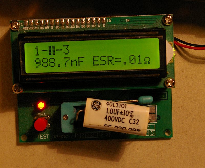

I have to disagree here, I think the only advantage there is the extra capacitance. I can't imagine four caps in series overperform this ESR...
 Filesize:  93.72 KB
 Viewed:  6897 Time(s)

I think he made some good points in what he posted. But I'll go further, because you mentioned previously that you needed 8 each for the HVPS alone. You list the cost of each of those 20uf 100 vdc wet tants to be $125.00 each. for a total of $1000.00
Going back on what I had said previously, what would be the reason for putting those caps in there, and what would be the end result from this upgrade? I know where you want to put them. The two 0.47 uf 600vdc capacitors that filter the 390vdc supply for the HVPS. I like to first add that whenever you see that small of a value capacitance as the filters for a device or circuit, higher capacitance filtering is not needed or necessary there. That and include the dual inductors in both negative and positive, also indicates a filter network. As such, its goal is for a specific frequency window or range of filtering. If more would be needed, it would be based on my experience either similar value caps both above and below that listed value.
Something like this:
In parrelel to each cap, one each or any combination of the following: 0.1, 0.27, 0.68, 1uf of same class of cap
Adding capacitance to far out of that range would normally not be necessary.
The magic in working with caps is finding out the right values necessary to better filter the device or stage. And that usually would have an end result of finding the right GROUP of caps to add. I know you see and read about it a lot, but in these circuits, the improvements are not made when higher cap values are used. It's usually made when similar of smaller values are made to target the frequencies of concern. We're so used to shot-gun cap upgrades, when simply adding more capacitance make things appear better. But I had learned over the years to develope a technique that would deal more with the un-wanted frequencies involved.
The HVPS is fine from my testing. The only problem area I've found was the G2 feeds to the neck boards. I have a fix for that one I can share with you and should be able to do it for less than $15.00 - and the end results would be quite noticeable.
