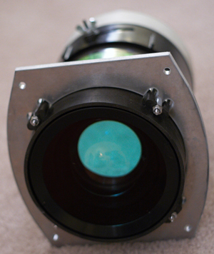

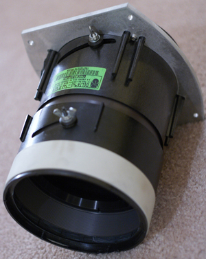

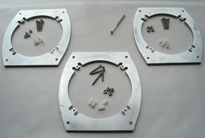

The adaptor plates are easy if you have access to a machine shop. I will need to remove one of mine and get the measurements for you. I should have a copy of the joust mod instructions somewhere. I just replicated what he did.
Added some pictures of the Joust plates.

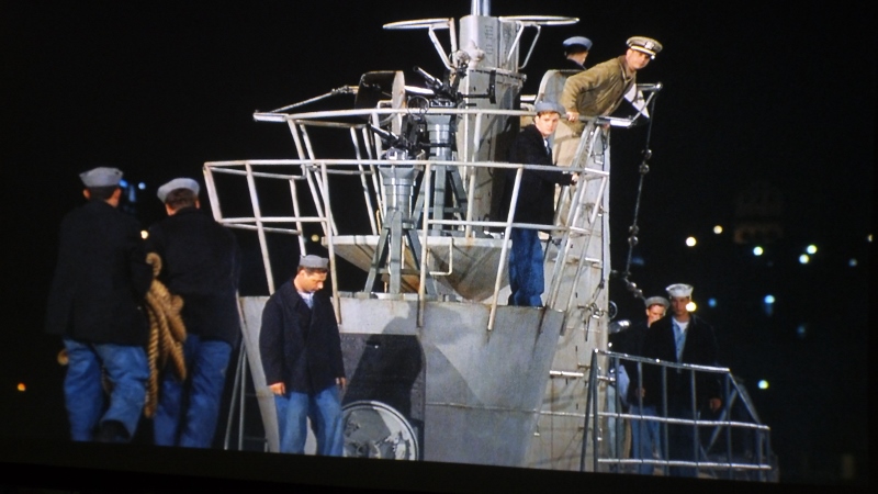

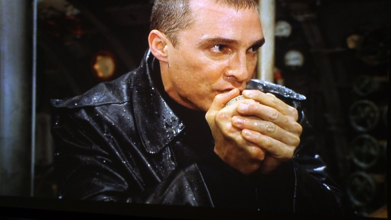

The 2 screen shots are with HD8 REVB lens. 1080p@60.
The colour is better with the HD144 but you drop a little brightness. Also your through distance is different with the HD144 lens.
If you can get a set of P16 or PT18 tubes they are sharper.
I don't have the brightness fluctuation that you guys are talking about, but I have lots of mods and have just about recapped the whole projector.

I used 16mm spacers and 6mm alloy plate.

I have the DXF file. PM me your email address if you need the file.
