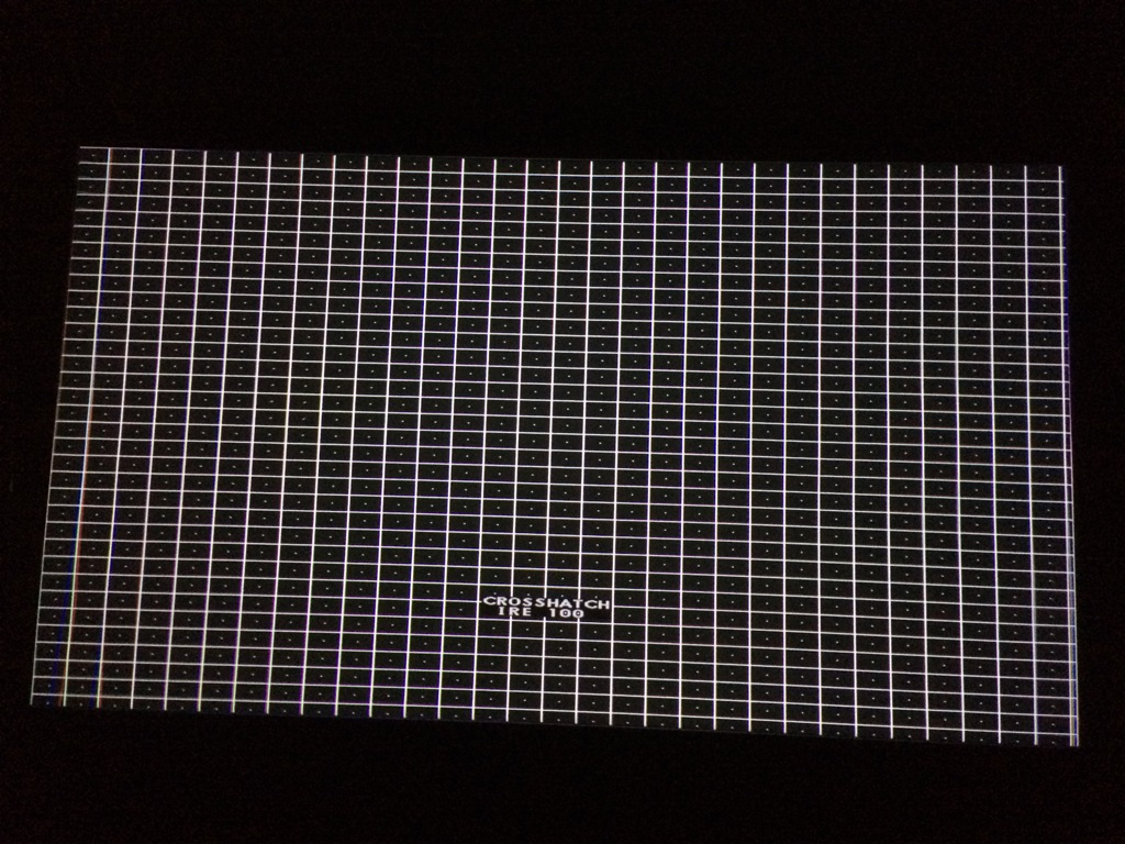

So I dinked around with the projectors a bit, and got the one more or less aligned. One thing is for sure, you can't mix and match digital and CRT. The motion artifacting is completely different between the two, and even a slow pan ends up in a blur, totally unacceptable.
These pix are taken from a handheld Iphone 4G, so they are far from great. even the 'good' projector has some issues in the bottom left corner. This is either a controller or convergence board issue. I did get the geometry pretty damn close though, save for a tiny 'hook' in the extreme left of the screen. The R and B convergence are out at the far left as shown as well. I've only used the 909 'coarse' convergence, and have left the 'fine' alone, save for aligning the green on top of the digital. No point in doing hours of alignment if I'm going to swap boards..
So the pix are as follows: This one is digital and one CRT together.

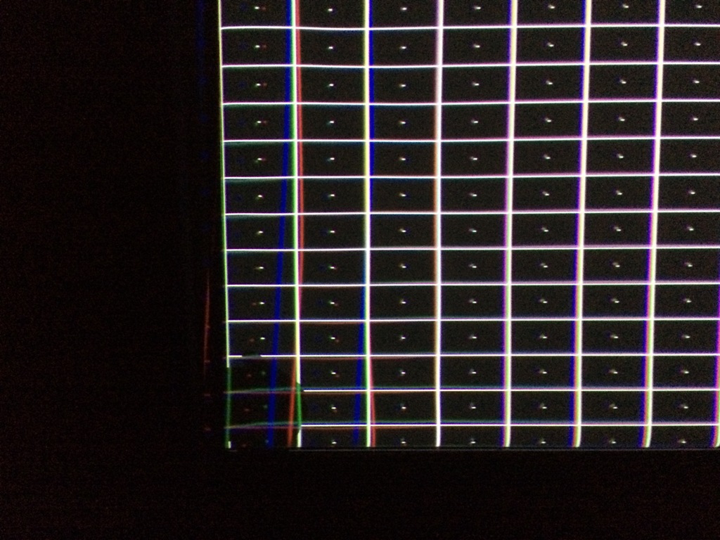

Posted: Tue Jan 05, 2016 4:14 am    Post subject:
Here's the anomaly on the CRT in the bottom left corner. It can be fine tuned much better than this with the fine convergence, but something is out of tolerance. I may as well chase it now (tomorrow)

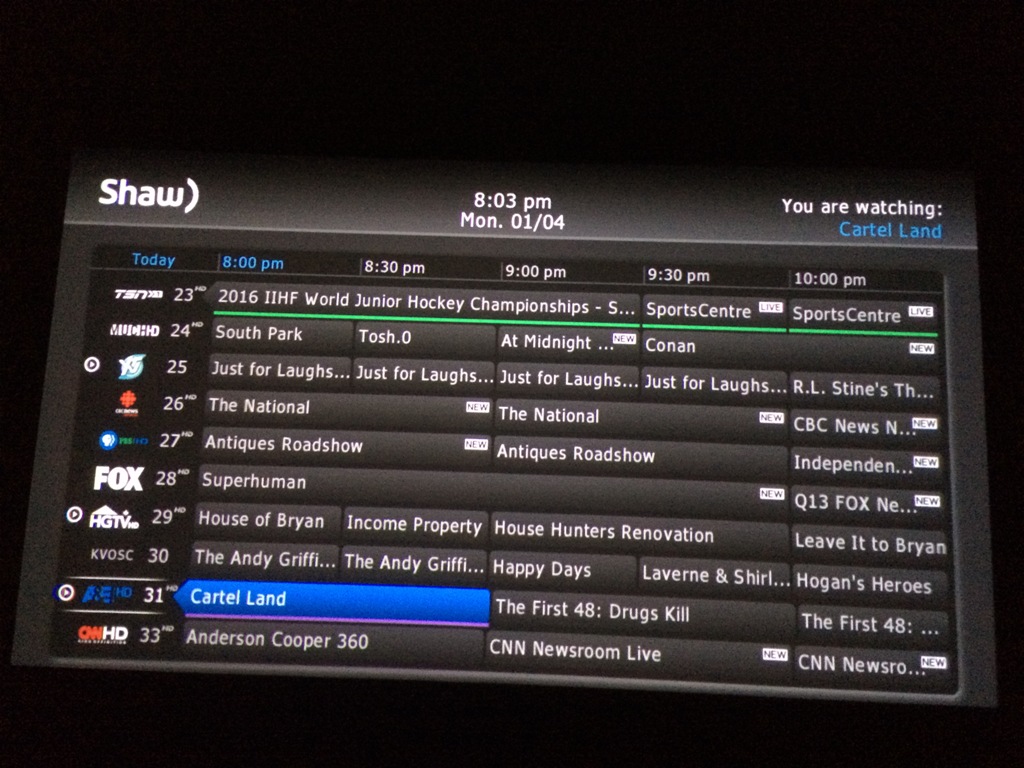

Posted: Tue Jan 05, 2016 4:15 am    Post subject:
Just the digital. BTW, it is a 1080p projector, a Sim 2 Domino D80. 4000:1 contrast ratio... I was wondering last night why it looked so good, and I also wondered why someone threw it out. It's at 1600 out of 2000 hours on the bulb, and new bulbs are $100 on ebay. I may as well pick one up. Thumbs Up

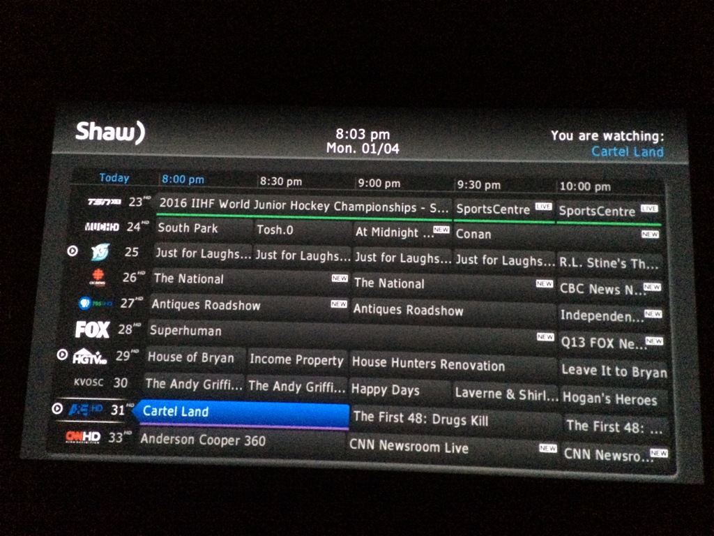

Posted: Tue Jan 05, 2016 4:16 am    Post subject:
Same shot, but CRT added. More brightness and punch, and the alignment is pretty damn good, even if it only took me 30 minutes. Now I'll watch the digital for an hour and a half, and will put the test grid up every commercial break, and will unmute the CRT to see if the alignment has changed. (color balance is a mile off between the two sets.. the Domino seems greenish, so I pushed the red and blue on the BArco to compensate. Ghetto! Mr. Green

Posted: Tue Jan 05, 2016 5:40 am    Post subject:
The second image with the CRT projector seems to have less artifacts or noise. It seems to be an improvement over digital alone or is that because I am looking at a screen shot.
barclay66
Joined: 27 Jun 2011
Posts: 1304
Posted: Tue Jan 05, 2016 7:50 am    Post subject:
The artifacts most likely are due to noise from the iPhone's camera sensor. The lower the light level is the more You will see it. Having two PJs throwing light on the screen will therefore reduce the noise in the picture. I bet that all of the noise in both pictures is produced by the iPhone camera itself...

Posted: Tue Jan 05, 2016 9:55 am    Post subject:
Oh that. I was thinking the problem was the isolated grid issue the second on that link.
Do you have the Blend option (mounted on control board) on these these 909's?
The problem you're showing here I'm familiar with. It should be correctable somewhat dealing with the left horizontal linearity settings in the menu. If not the H Deflection can also distort the image very similar to that
Posted: Tue Jan 05, 2016 2:41 pm    Post subject:
Barclay, you're exactly right, it's Iphone noise. Smile
So, after running the CRdigi stack (!) for 90 minutes, the pix was rock solid. Safe to say that other than the anomaly at the bottom left, this set is good to go.
Mike, I've seen this distortion on 7 and 8 series Barcos as well. I am going to do board swapping tonight to see where it's coming from, but not much work will progress with board swapping until I set up another 909 on the bench, as I'm pretty sure it's in the controller tray, either the controller or the convergence output board. I really need to 'scope' the output, and then it should be easy to track down.
I agree, you can fix it to some degree by playing with the key, pin or linearity, but frankly most of my settings are pretty close to 50, or at least between 40 and 60, so I need to find this problem.
