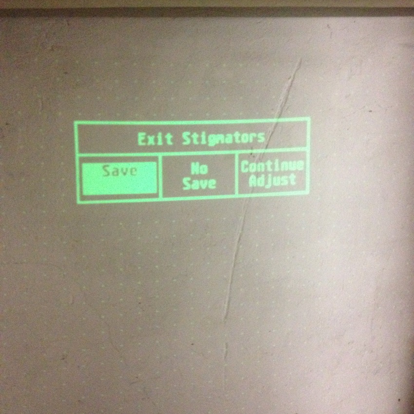

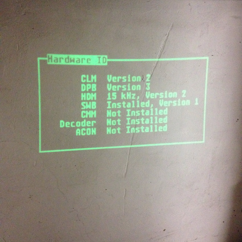

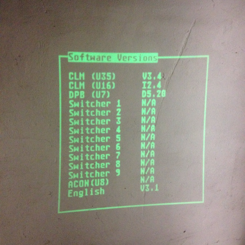

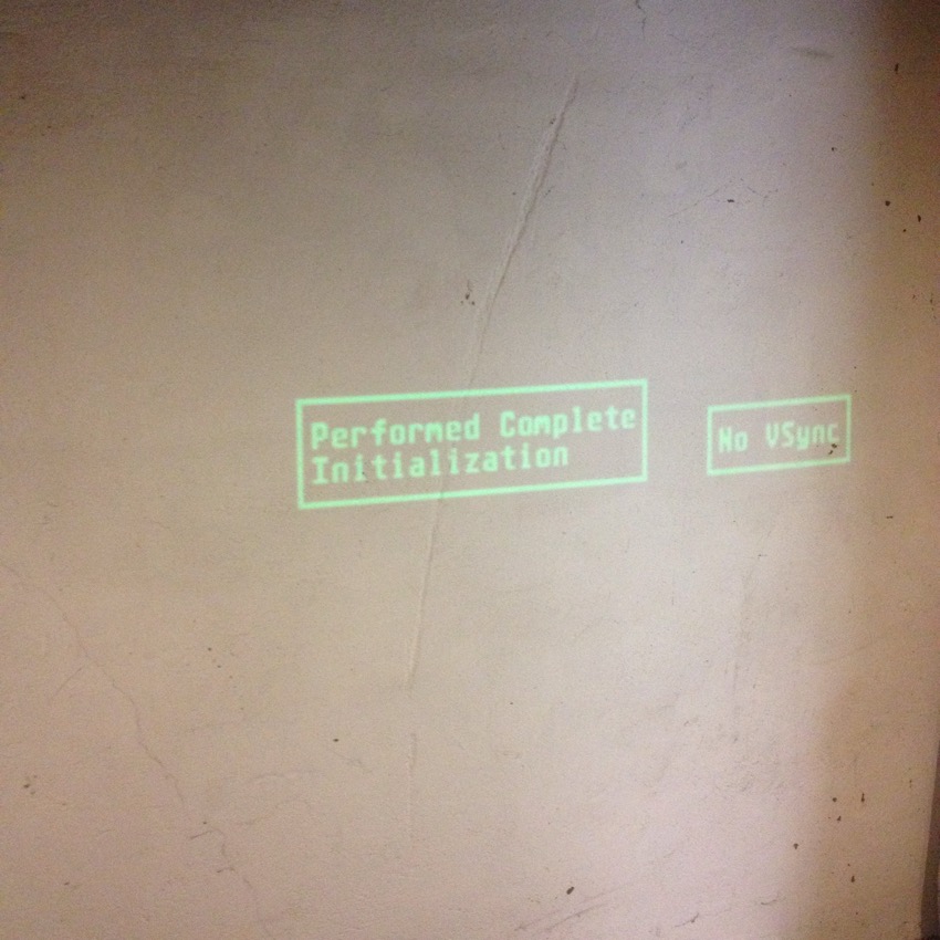

Today I have the re-initialization (50-2036-03p) made easy steps entered (without image and without RS323) after the restart, I had an image ...
stigmator are now also available Very Happy

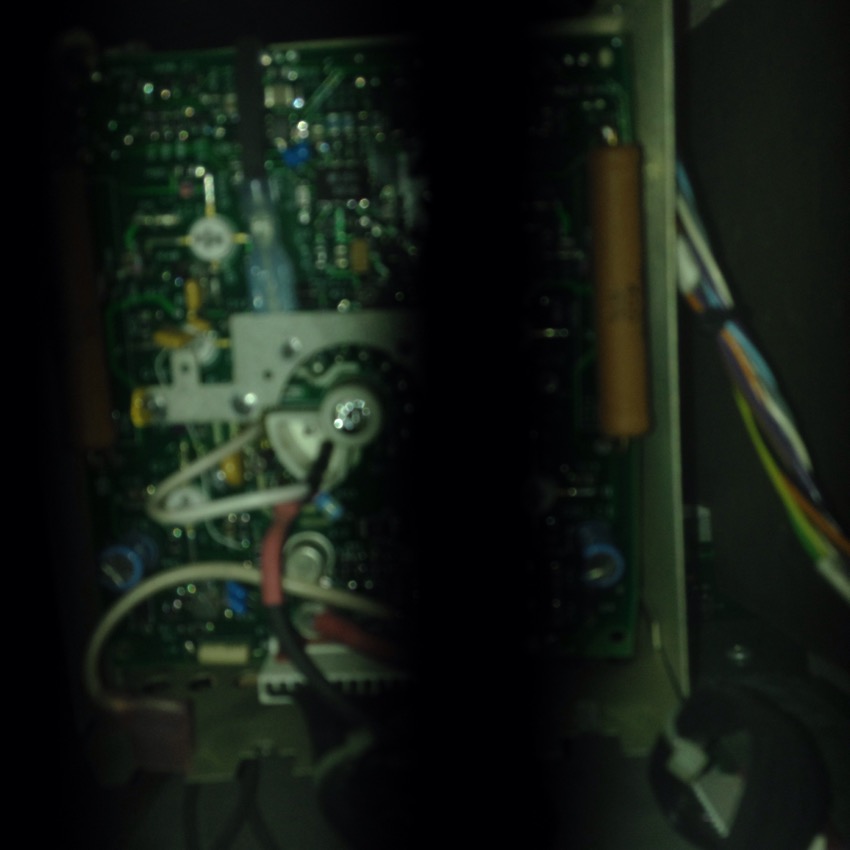

i found the hv shut down problem on the M9000 ... the G2 lead was connected to the wrong pin ... on all 3 tubes ?!
I hope the tubes nothing happened ... Curt writes in his FAQ if the G2 line is incorrectly connected to get a spot burn ... this it not so i hope the tubes are ok

Yes, wrong pin = spot burn but sounds like you got lucky. The HV will shut itself down if it senses and over-load, and with all 3 tubes running full blast it would definitely have over-loaded the G2 circuit.
Consider yourself lucky, wrong pin = spot burn almost every time. Anyway, you will knows as soon as you fire it up. If there is a black dot in the center of each tube then that is not repairable.

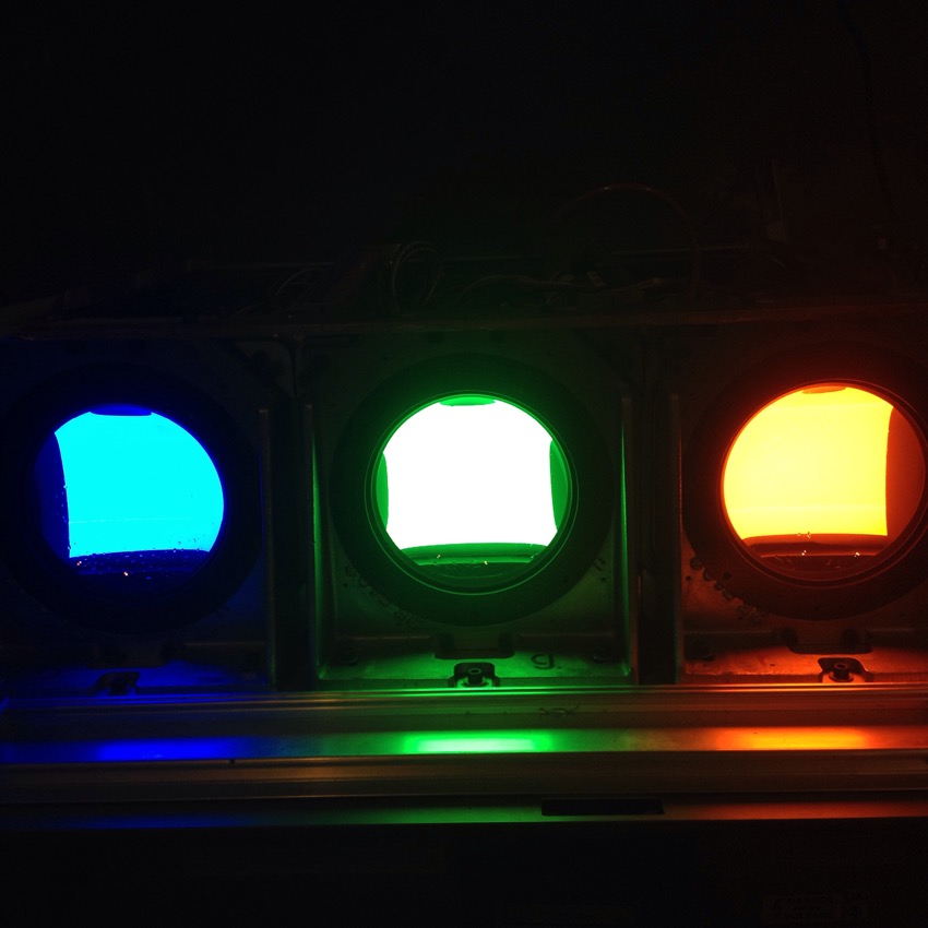

Today i Chek the m9000 put the g2 wire on the right pin an put all the old Boards from the 8500 in it
And we got a picture . No burn on the tubes Smile

your lucky, you basically have a 9500LC now. The new bellows is money well spent, we're all lucky Nash got those made or these machines would be boat anchors now.
