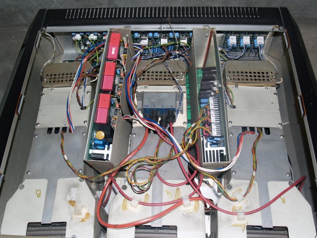

On the Web i found Some pictures how User add Fans on the Focus and hdm Board ...
Its no Glykol on the chassi ! I think the seller has found a small leak and put the Glykol out ! Tomorow i make more better pictures

Drags, look at all his pics, one Marquee is Black case I think( 8500 ?) and the other is a grey case ( 9000 ?) So look at both Stig amp boards. He said they are the same boards . Or at least I think he did ( language barrier)
8500?
9000?
both have the same type astig amp boards and they are the older style.

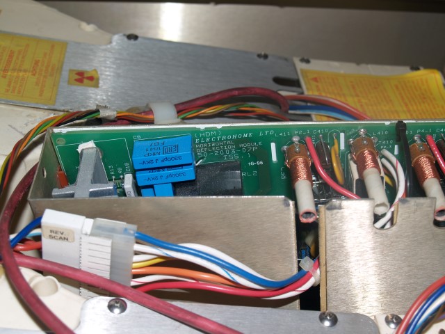

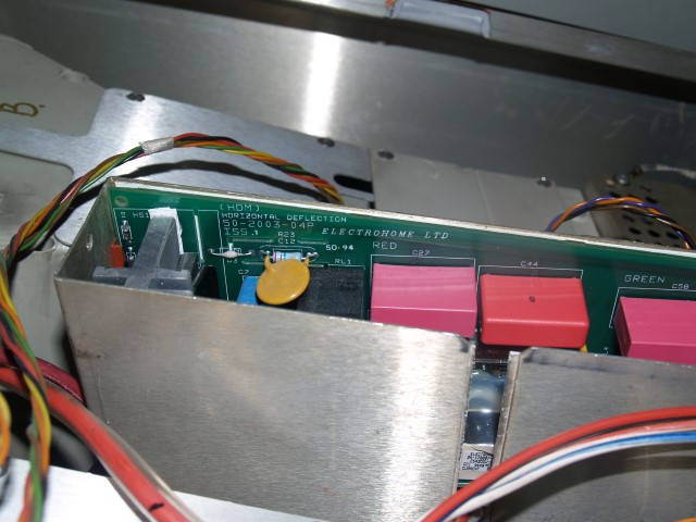

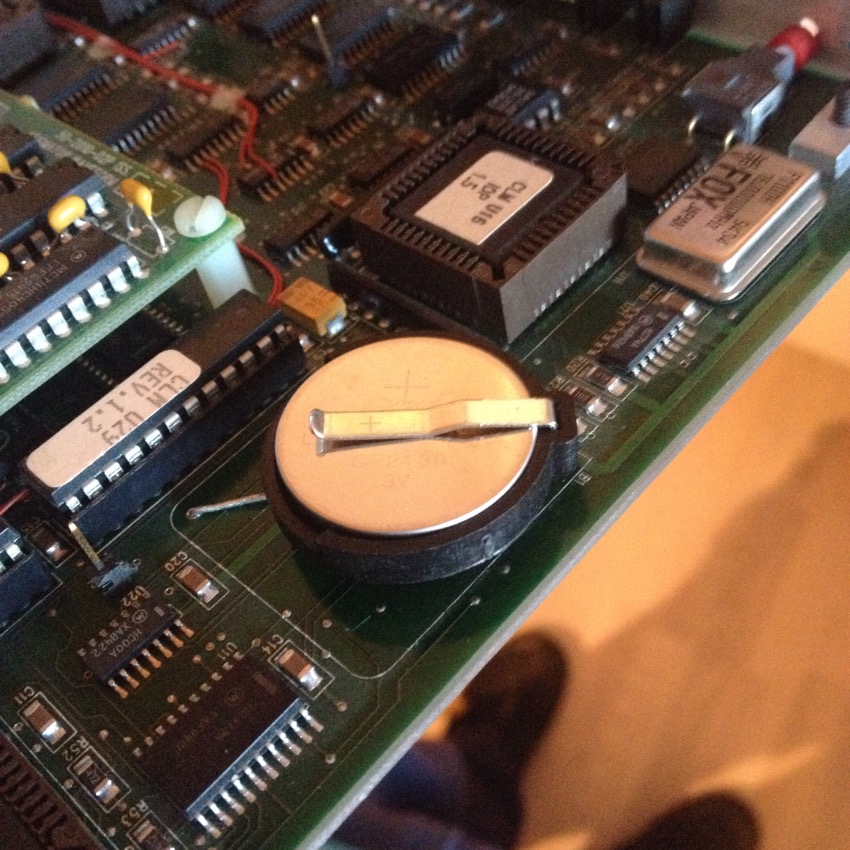

so today i install a new cr2430 batterie ... and make some pictures
the hdm have difrent layouts ...
The original renata 175-0 have 225mah the cr2430 have 280mah

8500

9000

As you already discovered the M9000 already have the newer HDM and it seems it has the new style CVA+VDM boards too, those are nice. This rises the question actually what else was replaced in that machine?
Posted: Mon Dec 21, 2015 6:20 pm    Post subject:
This is the old style HDM, which machine is this one in?
Martin86
Joined: 17 Dec 2015
Posts: 31
Location: Germany / Nuremberg
Posted: Mon Dec 21, 2015 7:23 pm    Post subject:
Its the hdm from the 8500

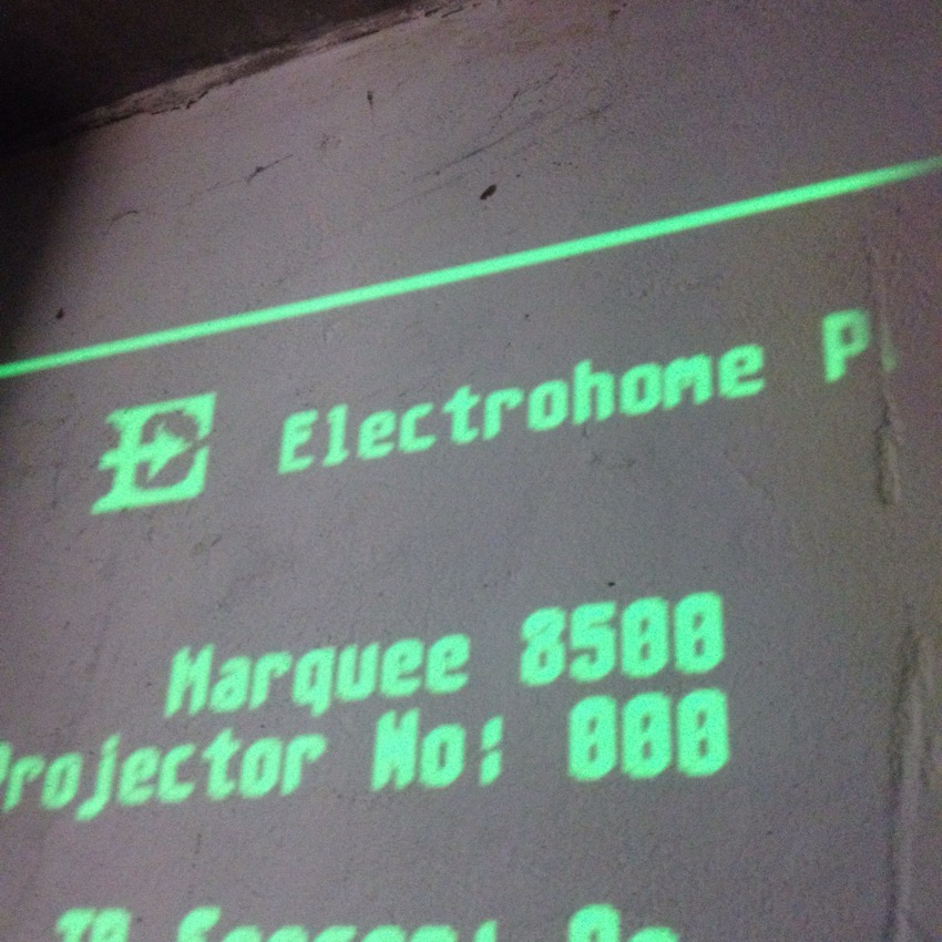

I think that 8500 has been cannibalized. Press the * button on the remote while the PJ is one to see which PJ it is labeled as. That info is saved on the Back Plane board and not easily swapped out.
Martin86
Joined: 17 Dec 2015
Posts: 31
Posted: Mon Dec 21, 2015 9:37 pm    Post subject:
Hello
* when I press comes Marquee 8500 .... well not so bad for both've paid 250 euro ... and I'm only 100 miles driven ...
cannibalized Thumbs Up Word of the day ... A friend said it would be a hillbilly tuned 8500 with downgrades improvement parts Shocked

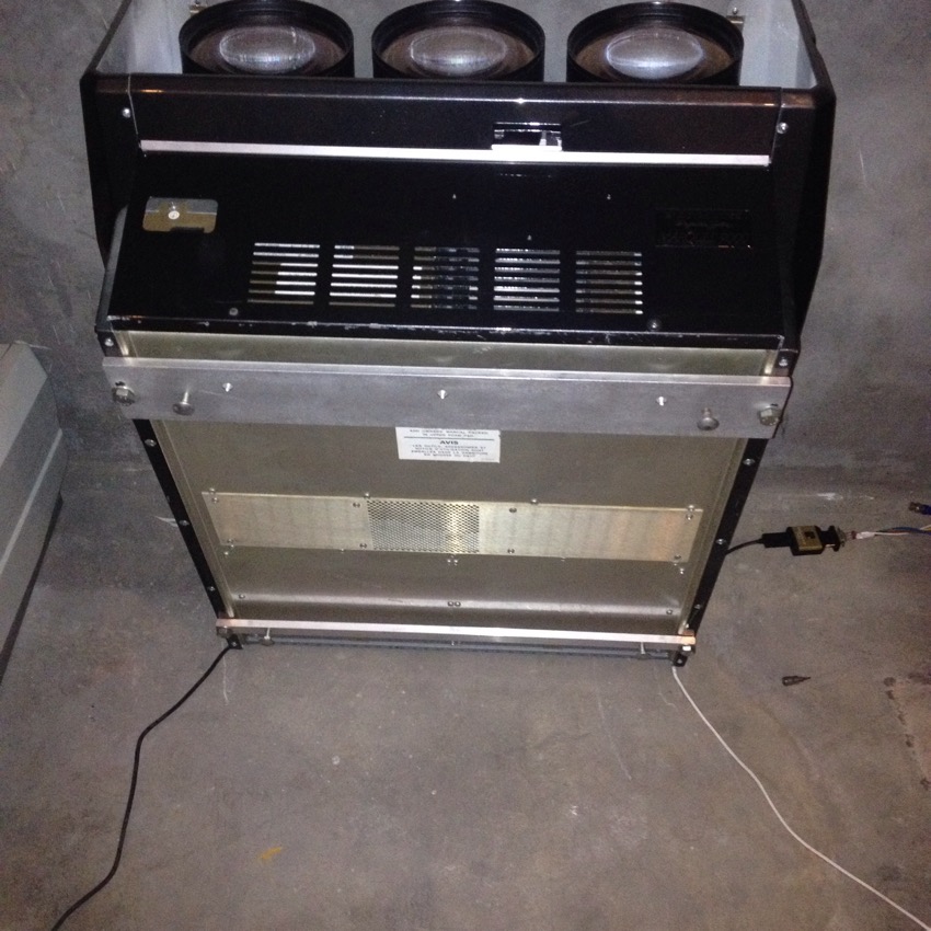

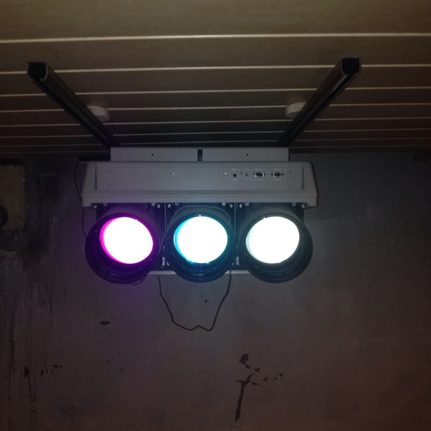

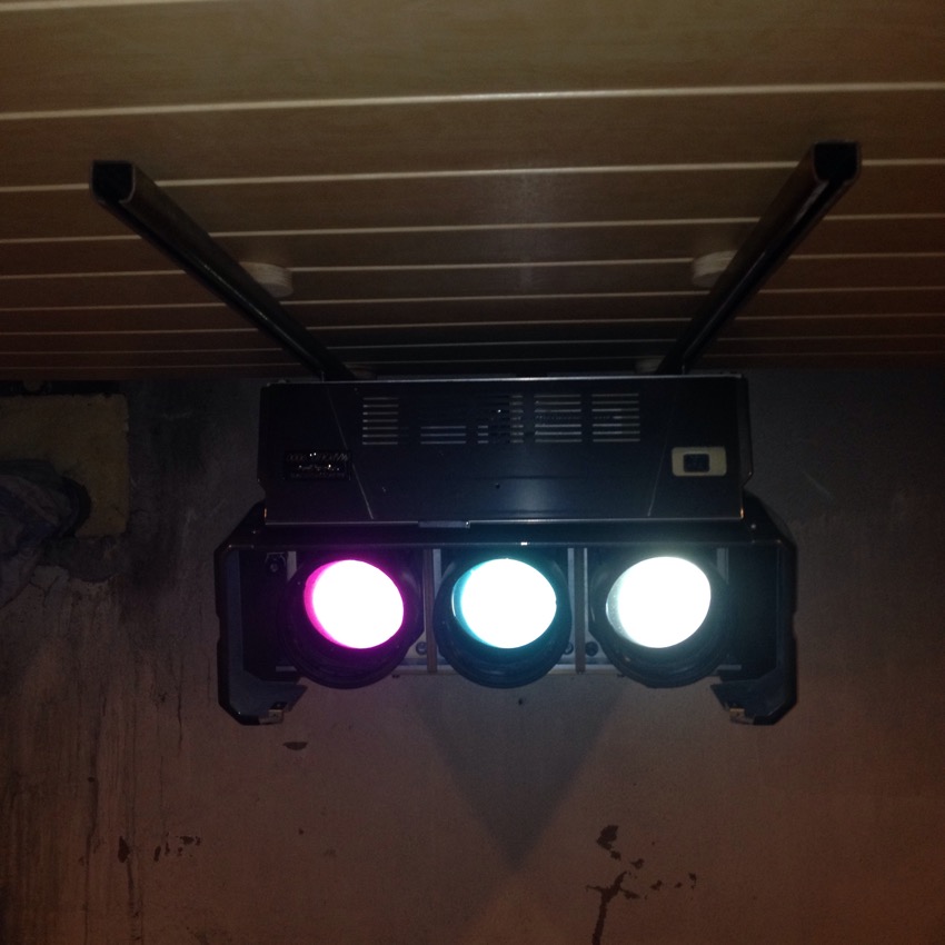

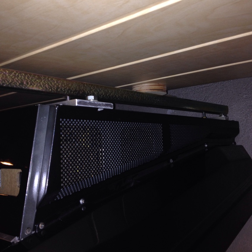

I put it on the celling ... And make two adaptors Thats the Marquee fits on my Barco "Rails"
