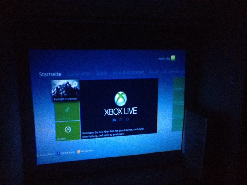

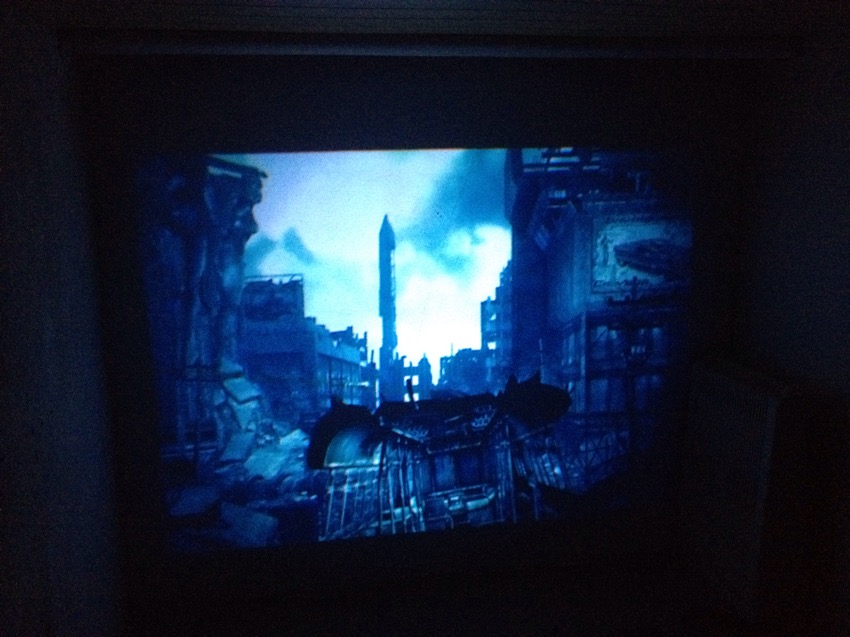

Hello my english is not so good 😂 But i have a Problem with my 8500 when i Change the contrast or tint the convergenc drift away and the tiny line go to big Lines ( Looks like the Focus poti on a Barco was not Right adjustment :/ Can anybudy help me ?
Posted: Thu Dec 17, 2015 11:59 pm    Post subject:
Hello
Sounds more like a focus or stig correction problem than a convergence issue, can you put up some before/after pics?

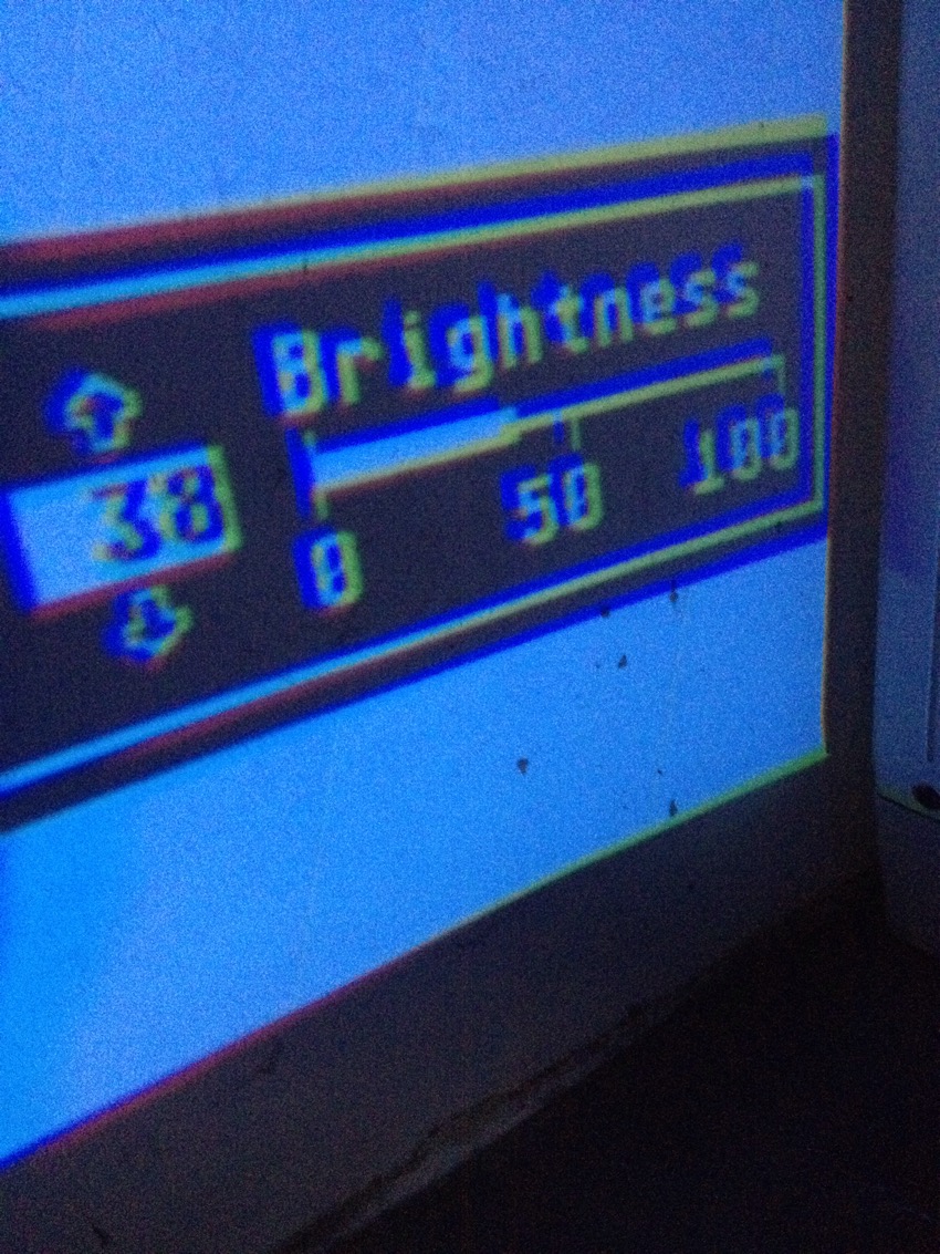

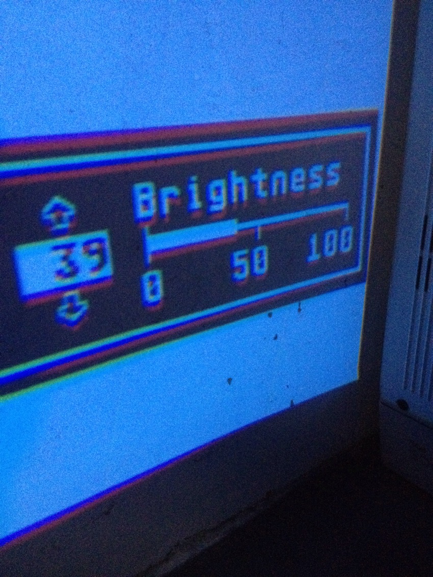

Posted: Fri Dec 18, 2015 9:29 am    Post subject:

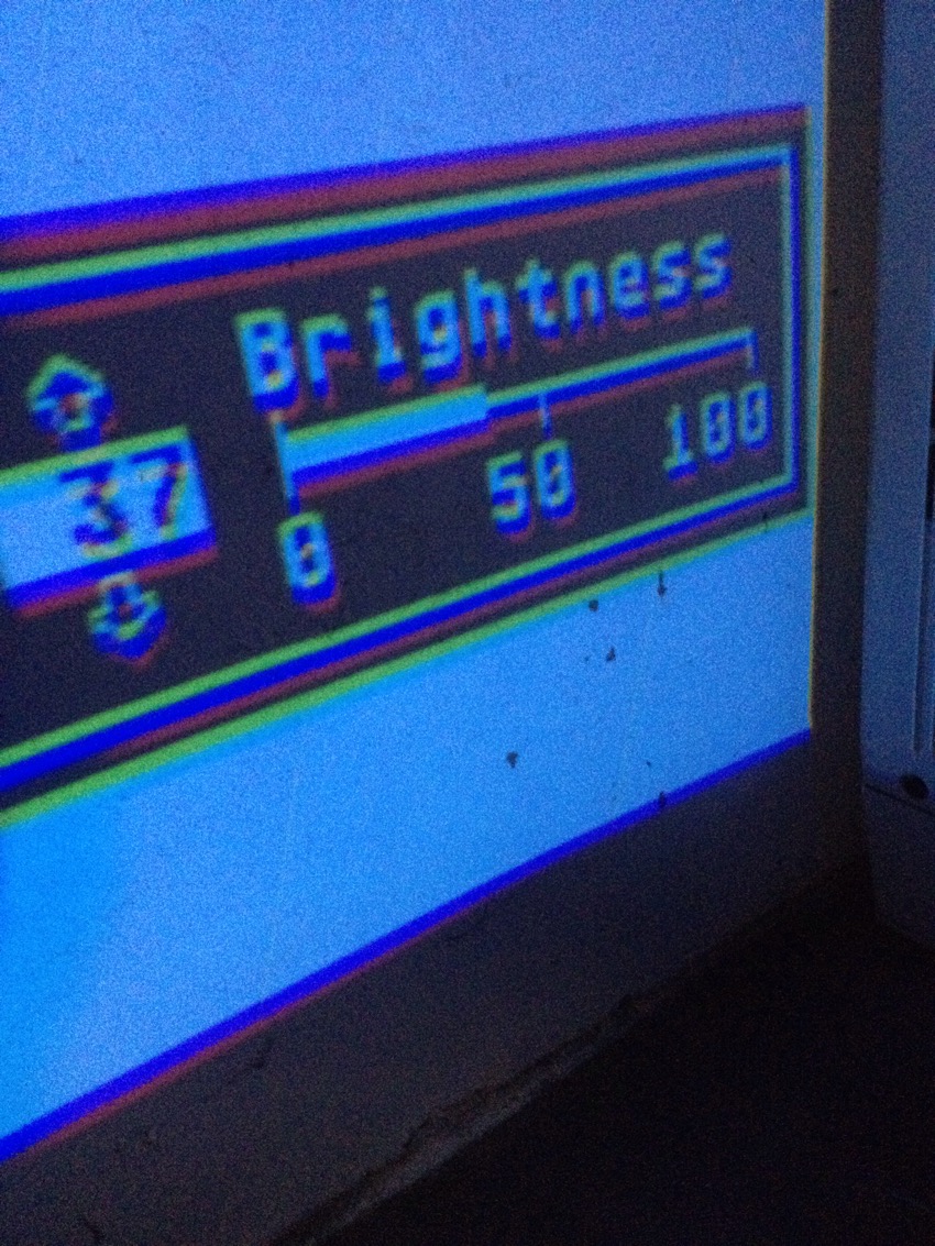

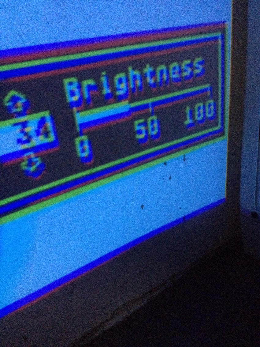

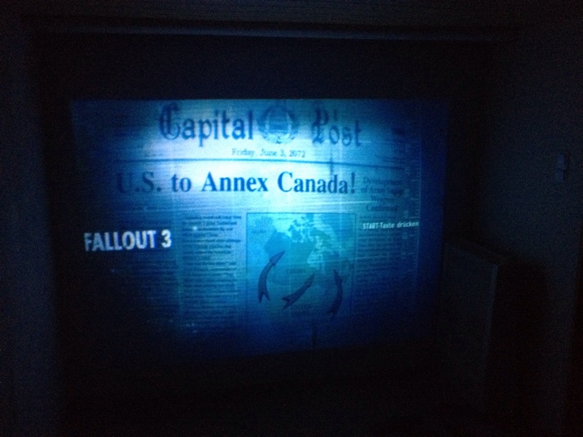

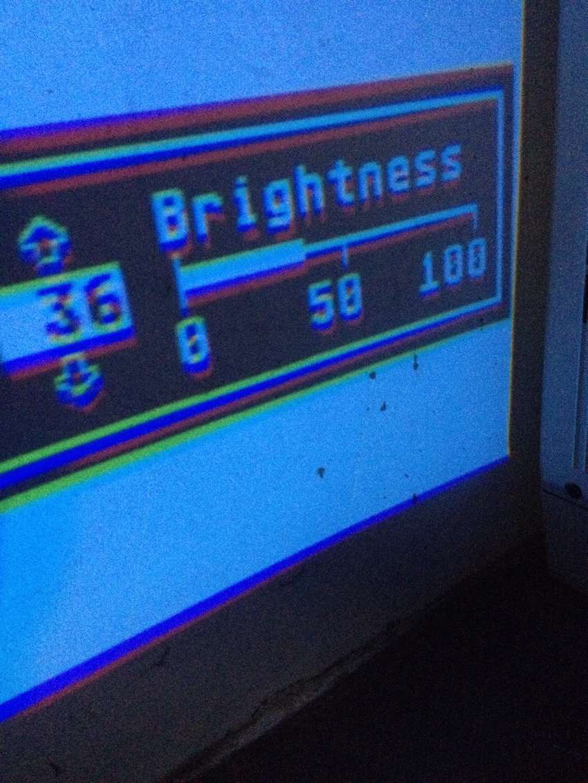

.... Its not only by changing contrast its drift's by contrast tint Volume brightness Sad i Hope the picture is good enough to See my Problem

is it consistent or does it "snap" back to normal occasionally?
This could be a number of issues, Focus board problem, Control Module/deflection processor issue, etc.
With power off , I would pop the cover off the Focus board (between Red and green tubes) and unplug the 3 white molex connectors (mark them for proper location). The machine will run no problem without focus board. Start machine
Then Ramp contrast up/down and see if problem is still there.
You can do the same for Convergence = back panel, center board (orange/brown wires)
and
Stigmator board behind red tube = (blue/purple wires).
The machine only needs Horizontal vertical boards plugged in to power up.
Just be 100% sure you plug boards back in correctly ( 4 pins to 4 pins, not 1 off to the side) , or you will blow that channel.

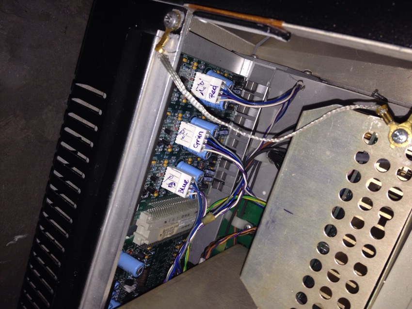

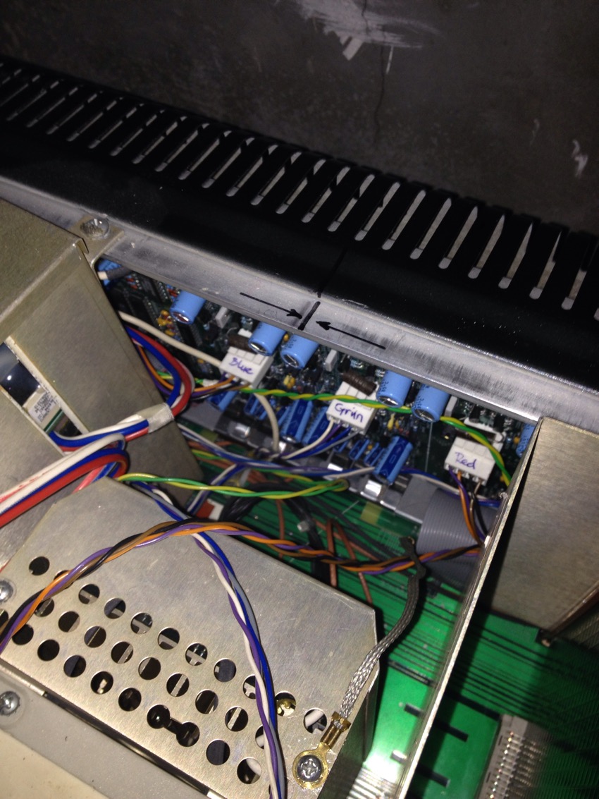

Posted: Fri Dec 18, 2015 9:27 pm    Post subject:

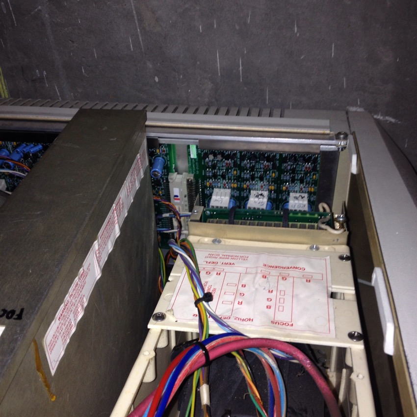

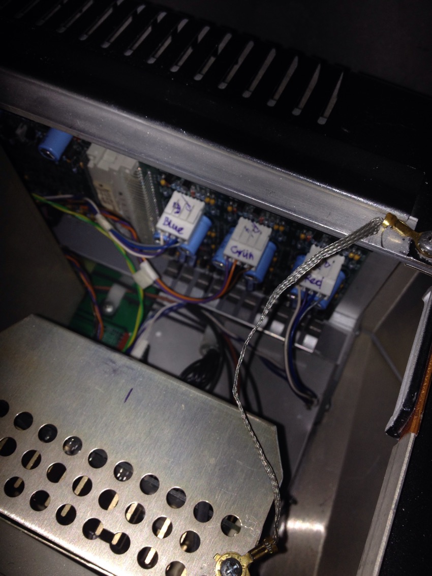

Hi Dragan, I've found the fault of, the idiot has connect the green confergenc on astig an the green astig on confergenc Very Happy that can not run ^^ the problem is fixed! and the image stable , note this is not a perfekt kalibratet confergenc Wink i think the green crt is not from this set ... the molex connector was wrong connectet an the ground wirer from the neckboard is not connectet to the chassi and hanging down to the bottom board ...

Ok my mother language is German ... The 8500 is Fixed i have found a molex connector from the green astig on the confergenc board and a green confergenc on the astig board ! im so happy ^^

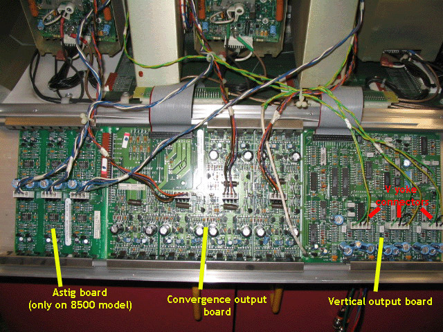

I After a review found that have the marquee 8500 and 9000 the same stigmator boards
in the setup and layout for marquee standing only the 8500 has this board?
See > http://www.curtpalme.com/images/Marquee_image03.jpg
I am so confused Sad

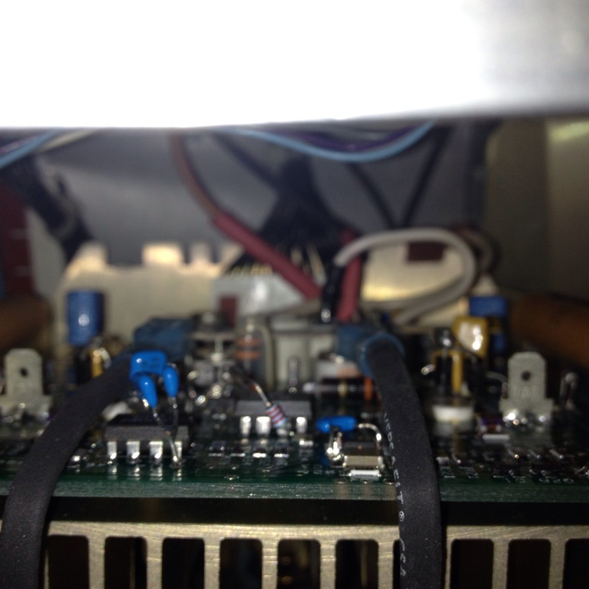

it is possible on the basis of the components to tell whether it is a 9000 or a converted 9500?
I've modifications found on the neckboards (extra resistors and capacitors)
which are tubes of Panasonic and have minimal Masks 8.5 thus still for many hours well

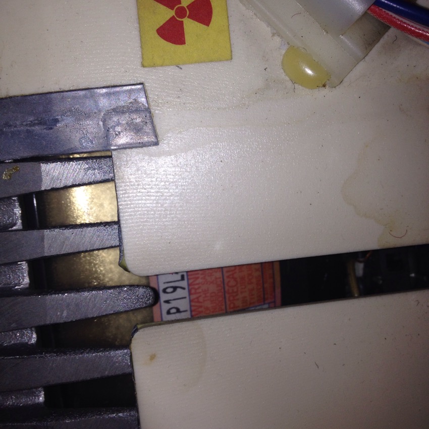

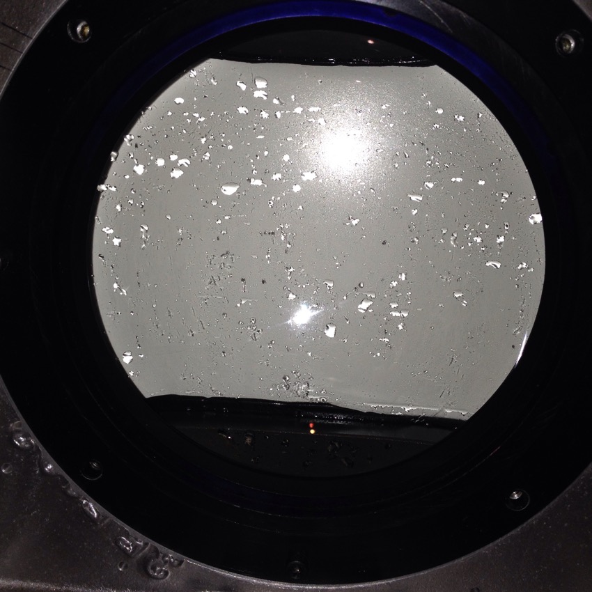

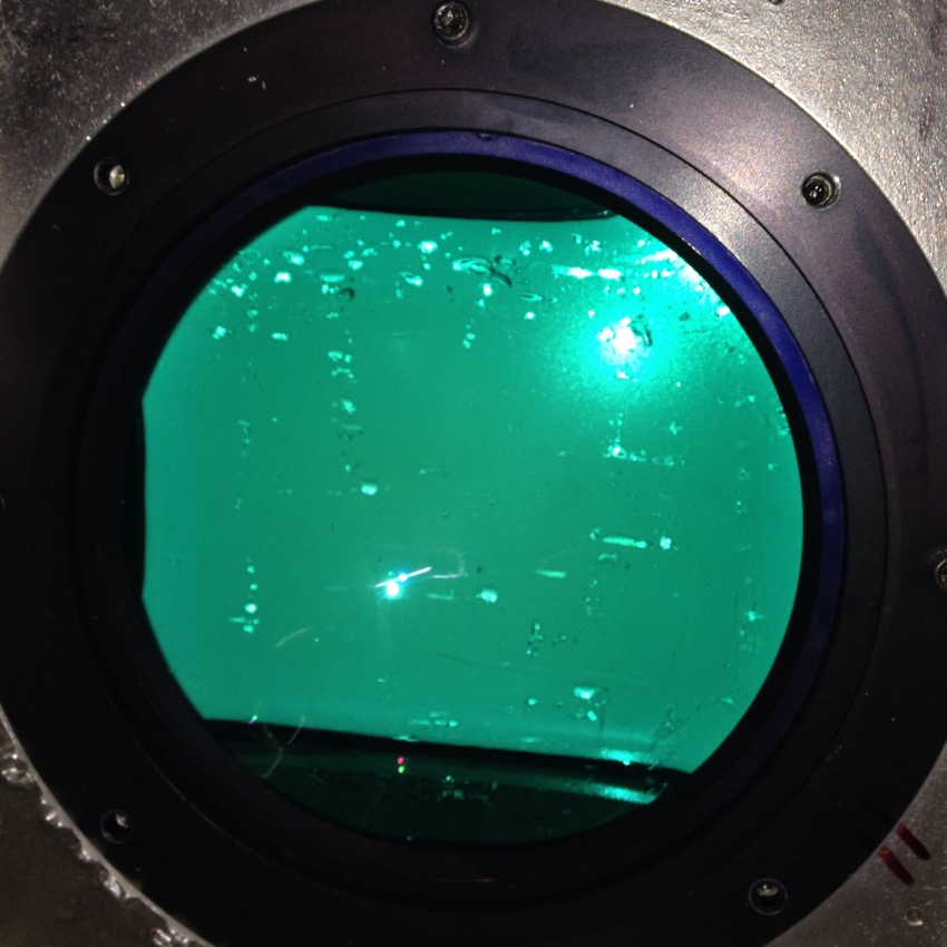

It looks like your 8500 has 8000 parts. The Astig board and Convergence board with the large Connectors that mate them together are from an 8000/9000 Marquee. Those neck boards may be older 8000 as well with a bunch of the tech updates done to them.
We would need to have abetter picture of the boards. Especially the HDM between the Green and blue tube. If you can pull it out does it have a metal box on the HDM anywhere? If it does its from an older 8000/9000 and will over heat when you try to do 1080p.

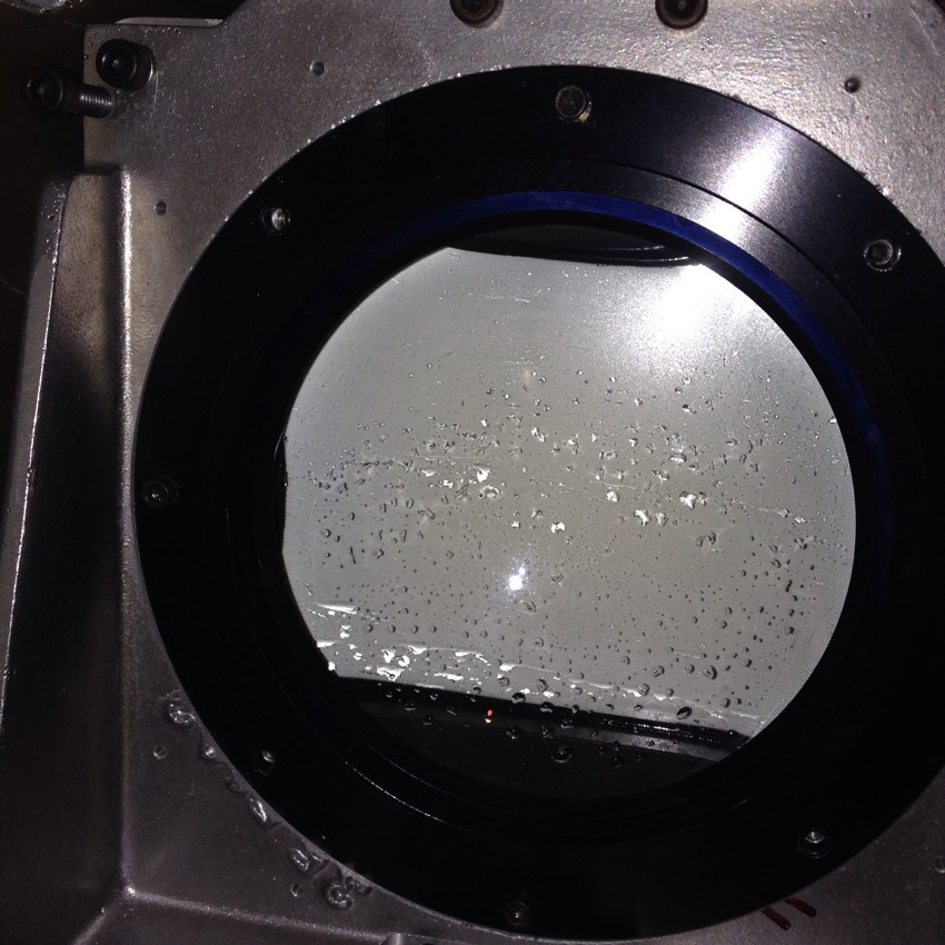

And those bellows do need to be changed, I have the ones you need to do a proper repair .
9000 had it, and 8500/9500 , did not come on 8000 or 8110
those exrea blue capacitors are not modifications, they're factory fixes to design errors. All this stuff was fixed permanently on 8500/9500.
yes, P19LCP is a Panasonic tube, but I see a lot of Glycol leaking. I would not put those in the 8500 chassis in that condition.
