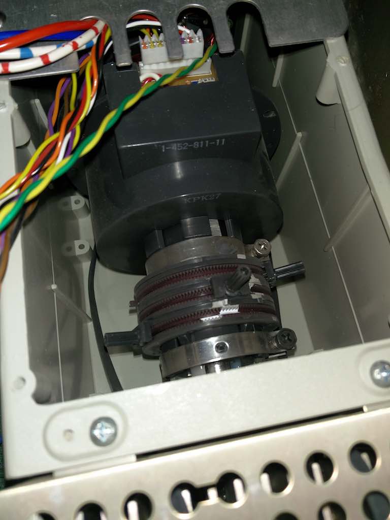

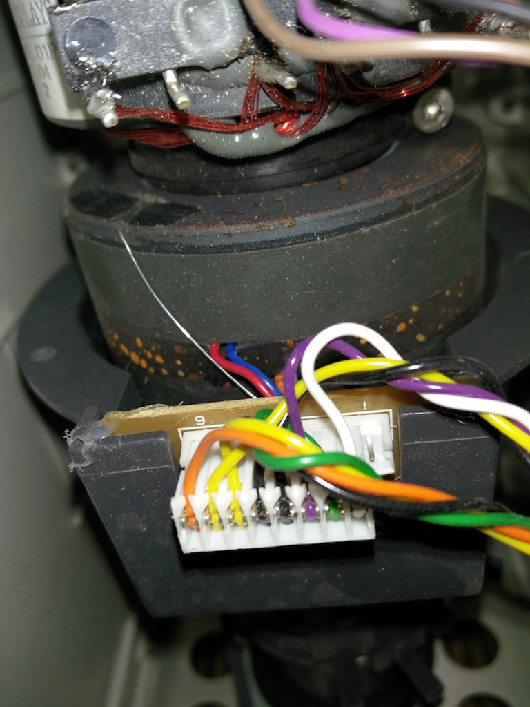

please take some photos of the focus coils, hose are the "Frankenyokes".
Don't worry about the glue and such things. You'll have to remove them, but it is easy. I can do a step by step guide if you need it.
And as you may know (about CRT projectors in general) it is always the best idea to set up the projector mechanically as good as possible
before you even touch the remote. That results in better picture and reliability over all.
You'll have to center the raster using the focus coils. No way around it.
Post the model number of the projector. It is on a sticker under the lens cover.

I am not currently aware of anyone who has successfully used G90 focus yokes in a Marquee. They're too different, to such a point that I consider them to be poor candidates and really of no benefit. As I recall, their magnetic and electrical parameters are WAY off and you can get better results from modified 1292 focus yokes which are also about the right length to be compatible with the Marquee tube magnetics.

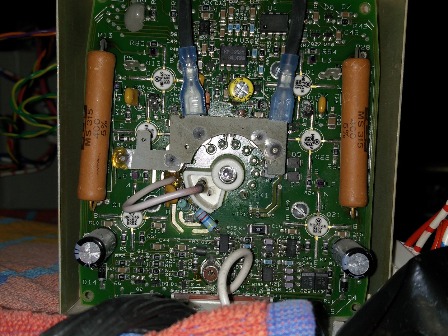

About the yokes, Uploaded some photos.
The model: When i press * it tells med that it is a Electrohome ULTRA 9500LC, the chassis says 38-P13095-AC and the backplate says Marquee 9501LC. This is a total mix:p
The green tube is indeed a P19LCP09HKA.

Yoke2
 Filesize:  166.1 KB
 Viewed:  10622 Time(s)
Yoke1
 Filesize:  60.56 KB

Oh, by the way, the RGB-input-card is modified "for better focus" with a trimpot and replaced caps. I have an original aswell. The tubes are all 9:ers:) No wear to be seen at all.

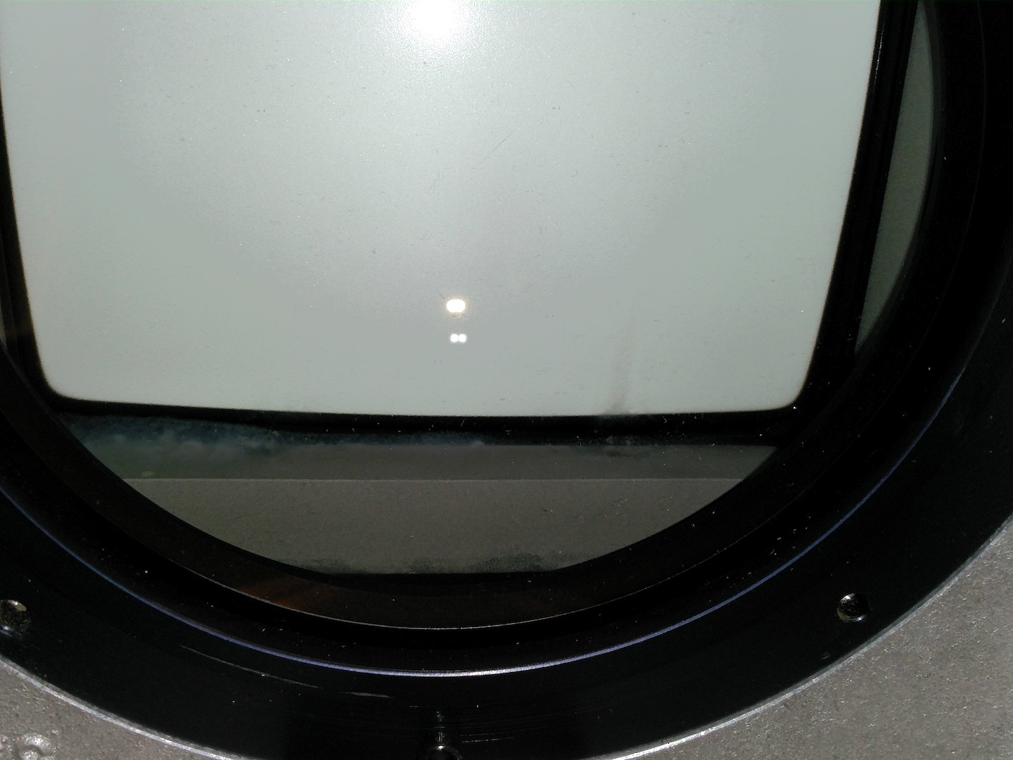

The glucol, on the other hand, has some junk at the bottom (under the picture so no issue, but still), the red and green LC-rubber are really squishy, the blue is still "pushable" but a little more firm. Is this a risk already or where do you draw the line?
No leaks so far:)

About the pictures of the yokes and all the different modelnumbers: Was it possible figure out what model and yokes i actually have?Smile
Edit: I just checked the pcb:s. Most of them has some kind of mod, the video-signal-cables seems new, there is a trimpot on the PS that i thought was a fan-speed but it was'nt and so on. Is there any way to figure out what mods i have and wich are recommended without sending the pcb:s abroad? I checked the list of MP-mods and i think that's what it is but then i see this small wires soldered here and there:P If i have understood the rules right, it's inappropiate to post photos of pcb:s here?

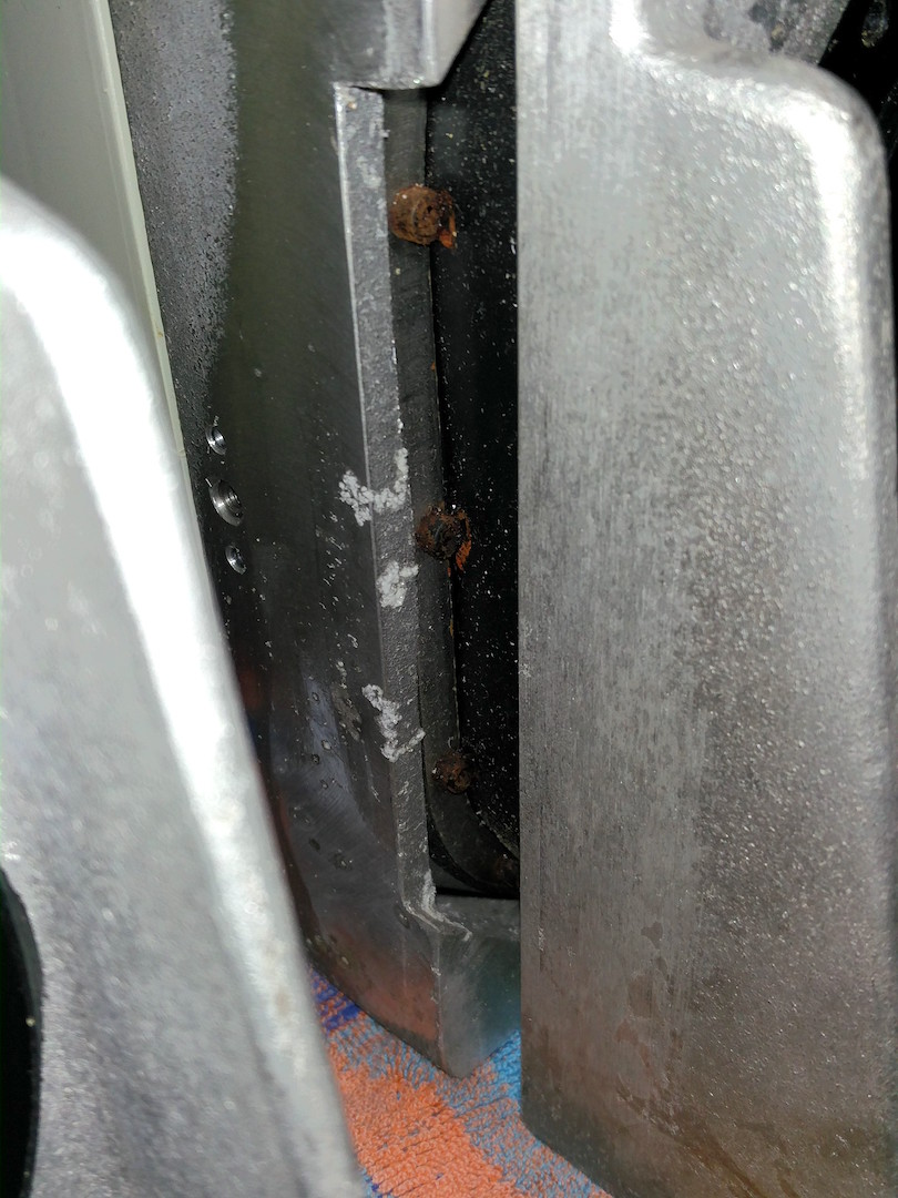

I Just took a closer look at the bellows (as close as you get without taking the tubes out of the PJ), it seems like the red tube are leaking slightly (or has been, anyway). it's a little bit corroded in some spaces (white crystals, like a leaking battery. a little rusty bolts). There is a screw that seems to be on top of the HVPS, that is a little corroded but it looks like it's been dried out. How worried should i be and what could i do? I was hoping to wait with this until i have something to replace with and the right equipment:(

Posted: Thu Dec 17, 2015 5:22 pm    Post subject:
Nashou's bellows ARE the thing to get. They are reformulated to last longer and not sweat glycol. While it's more work to replace the bellows, it's well worth doing.
It's also well worth it to completely clean the entire LC chamber, mask off the CRT face very carefully, and spray the interior of the LC chamber with black VHT epoxy paint, which will seal up the LC chamber to avoid chemical interactions between the aluminum chamber components and the glycol. While the originals were originally hardcoat anodized, sometimes that anodize things out and starts to fail in spots, particularly if you scrape the leftovers of the old bellows off. (Which is often necessary.) You want to keep any bare aluminum from contact with glycol. This will give you the longest usable lifespan of the coolant.

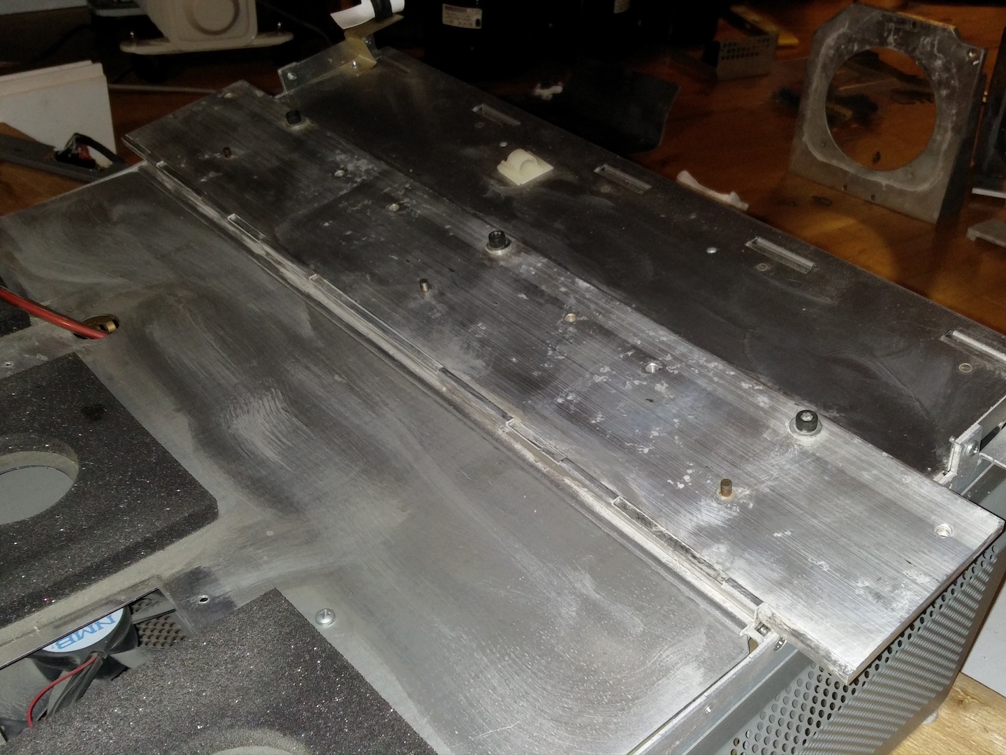

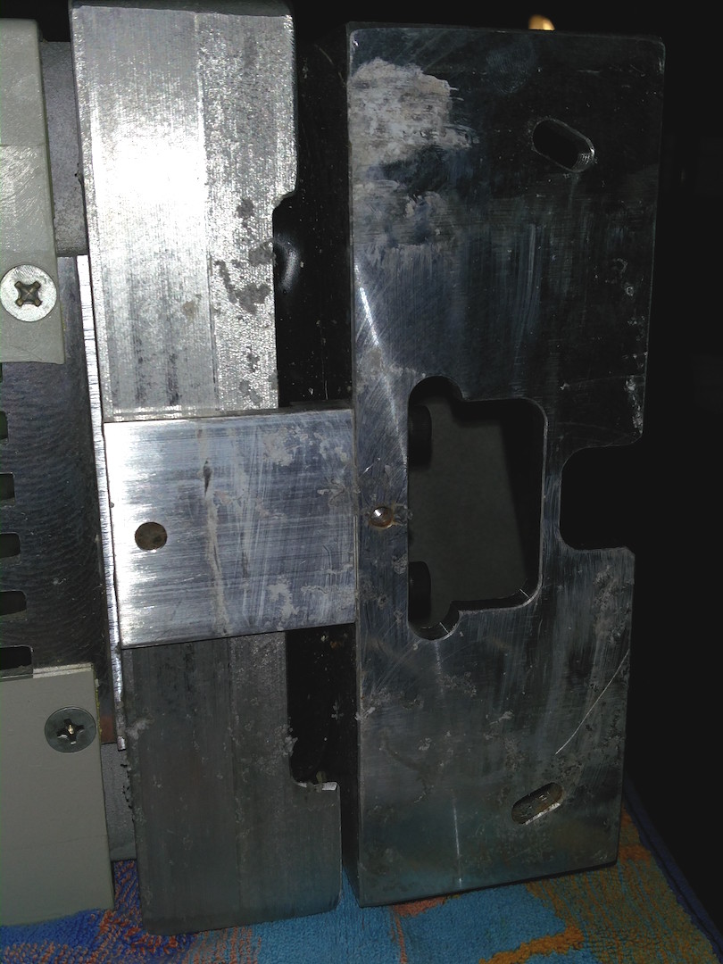

I've removed the tube from the chassis, fortunatley, the glycol did not get far (it stayed on the aluminium-plate that all 3 tubes are bolted to. I started by cleaning that and everything near it with rubbing alcohol. The tubes are waiting on a towel with plastic under until i have all the equipment i need (starting with new glycol as i now have found some fungus).
I think my HVPS has been trough some glycol-leaking in another chassis before (dry traces inside, no traces on the way in or even a way in to that part at all, took EVERYTHING apart just to check) Are the visible traces something worrying or is that how it will look after cleaning a pcb?
PS: I did touch the trimpot beleiving that i wold change fan-speed, (only down and back) but now i will measure and get it right before plugging in the heater-plug again:)

I'm not shure if this is the "bad" neckboard or a good with new caps on... Time to resolder restistors!

Leak from below
 Filesize:  204.38 KB
 Viewed:  10152 Time(s)
Leak, rusty bolts:(
 Filesize:  210.82 KB

Posted: Sun Dec 20, 2015 11:00 pm    Post subject:
Yes clean all boards and connectors no matter what. It will keep the Marquee in top running shape and performance.
I do not like shipping liquids over seas. I had tried it once and it got sent back before it even left the country. With a warning letter
attached. Some liquids need special license . I thought it was bull sh*t but whatever,
For the VHT paint let it cure foot at least a week before adding the Glycol or Ice Clear.

Thanks for the info!
It seems like i have some work ahead of me;) and i will doublecheck that the antifreeze-company have been shipping overseas before (and maybe check with the swedish toll aswell).
about the vht-paint: i should choose satin-black right? not blank.

Posted: Mon Dec 21, 2015 12:04 am    Post subject:
this is not good, look at the solder joints on top of the big Brown 400V resistor , how burned up they are. I'm not sure I would continue to use this , but if you do
At the very least you need to re-solder these resistors. I would also replace the the 2 AL capacitors below them. You want a 22UF cap with 160 to 200V voltage rating , radial LOW ESR capacitor.
Looks like someone already worked on these boards, really shocked they left those resistors like that.
