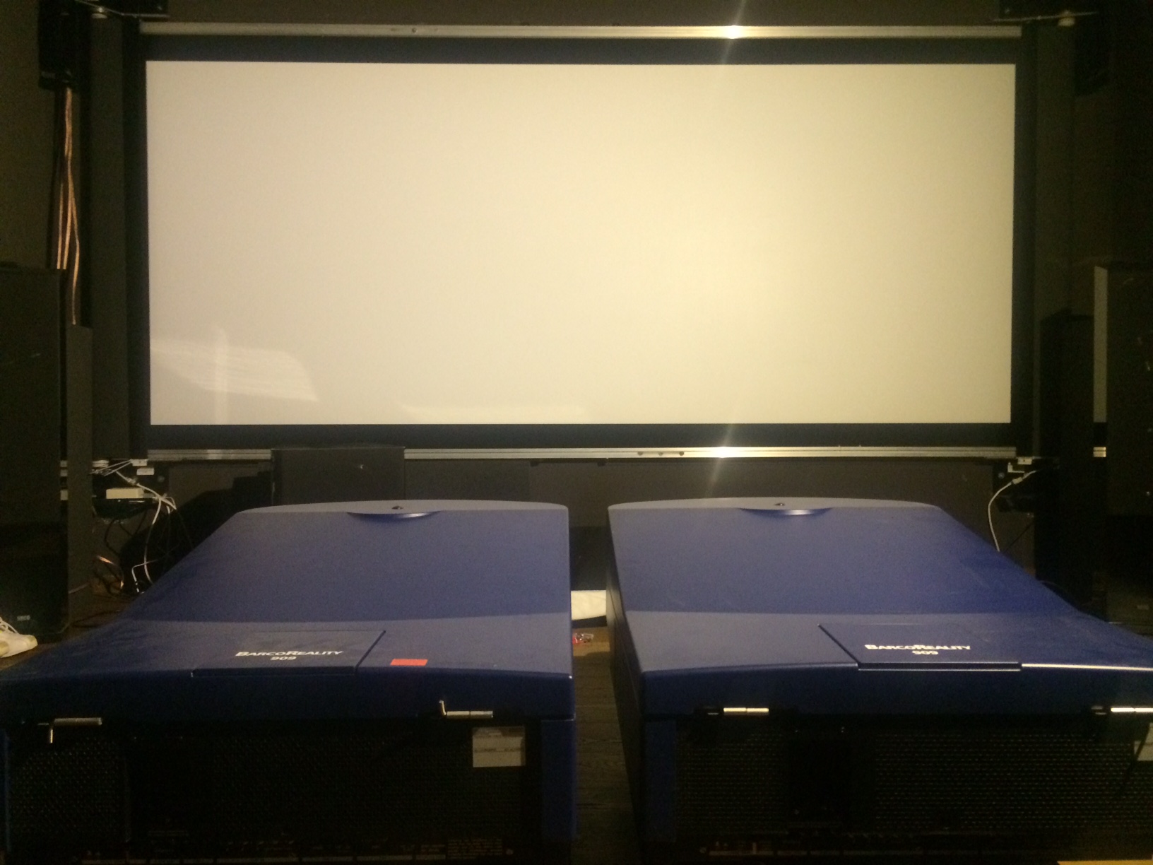

This would be my setup if i will ever realize it Mr. Green
Screen = 3,32m x 1,38m in cinemascope
2 x BR909/Cine9
Each of the projectors would project on a screen of 1,84m x 1,38m (4:3)
So i'll have an edge blend zone of 36 cm in the middle of screen.
cheers

Posted: Thu Dec 10, 2015 2:03 pm    Post subject:
Wow! that really looks super. Are you using the tvone for blending?
