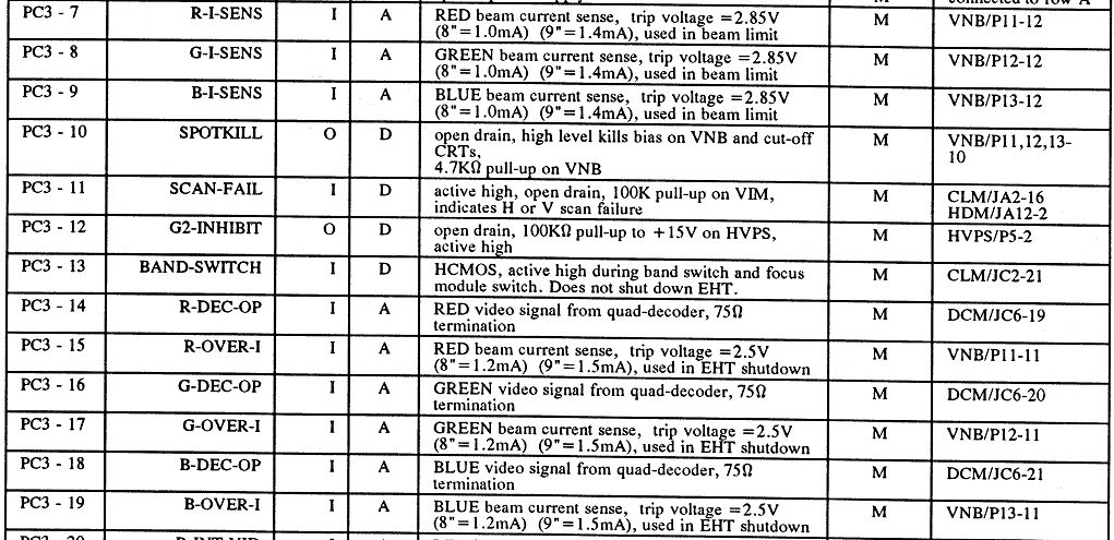

There IS information on over-I and I-sense signals, but strange enough they are listed in the VIM's section.
As I am tayloring the VNB in to my NEC, I'm quite up to date in the construction of the VNB Smile
Generally the brightness of the circuit can be set with the ofset of either Q12, Q19 (it driven through Q12 here), ideally the over-I or I-sense should not affect brightness, a different bias/gain setting of the brightness circuit probably would solve that part of the problem.

Posted: Thu Jul 23, 2015 8:35 pm    Post subject:
Thanks!
This data will help. Interesting to see that there is indeed a different setting of the potentiometer between the 8" and the 9" neck boards although they share exactly the same schematic...

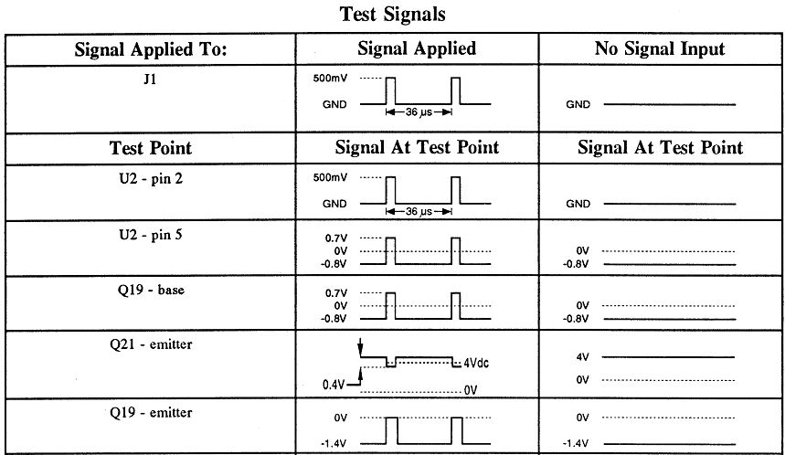

Posted: Sat Jul 25, 2015 6:27 am    Post subject:
koldby wrote:
So what would you suggest?
This is also just a theory, needs verification.
For example you should do these test steps attached below on the new style neckboards for comparison.
EDIT:
As I see the new board will give quite different readings... U5 in the new design isn't biased in either way, so with gorunded input it will have 0V on its output. Assuming there no voltage drop across R6, Q2's base is at 0V as well, Q2 being PNP its emitter is 0.6V above it's base, so with 0V input on J3, Q19's base is at roughly +0.6V. While with the old style neckboard it was at -0.8V, that is quite a difference and this have to be canceled out from the Q12's side to get the same output bias levels.

The manual suggest to apply -2V at U1 pin7 for testing (for old style VNB). With this and with 0V input the output K and G1 should rest around +/-78V *EDIT* respectively.

-2V at U1 pin 7 roughly means -1.4V at Q12's base, what you can translate then.
In fact the brightness has little impartance, I just pointed out that after changing from old style VNB to new style the G2/Drive settings have to be re set.
