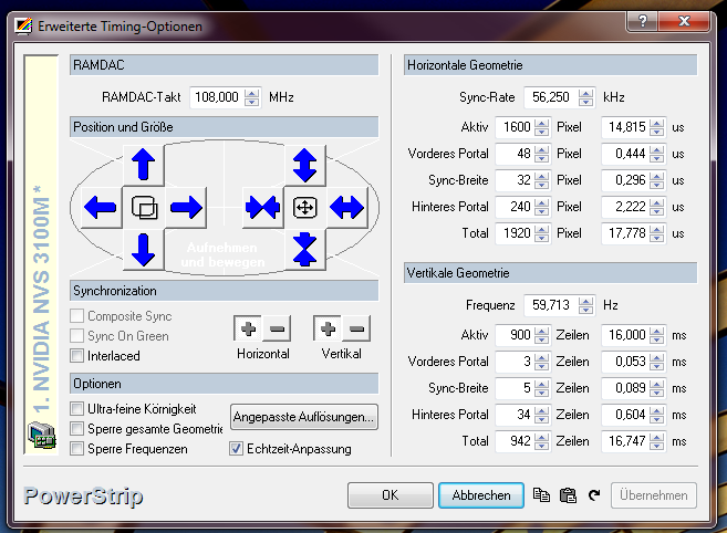

Posted: Thu Jun 11, 2015 8:24 pm    Post subject:
@winny: Thank you, had a first success with PowerStrip. (@1080i60) Now this is my working result. Can I convert my input signal to match this configuration?
PowerStrip working config
 Filesize:  91.46 KB
 Viewed:  6123 Time(s)

Posted: Fri Jun 12, 2015 8:00 am    Post subject:
'97 PowerStrip for the win once more! Very Happy
Sure thing, with a decent scaler like the VP30 you suggested earlier.
