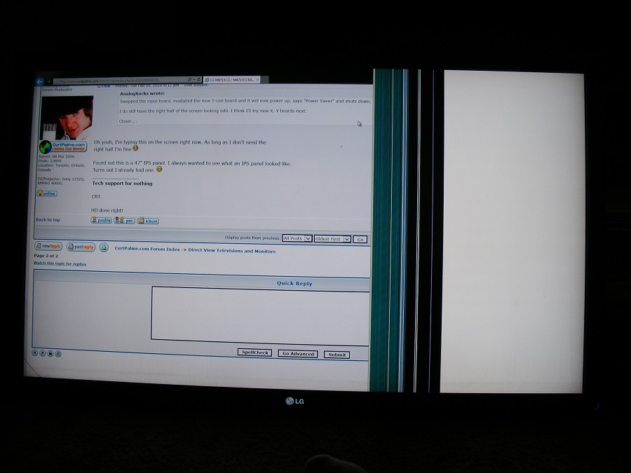

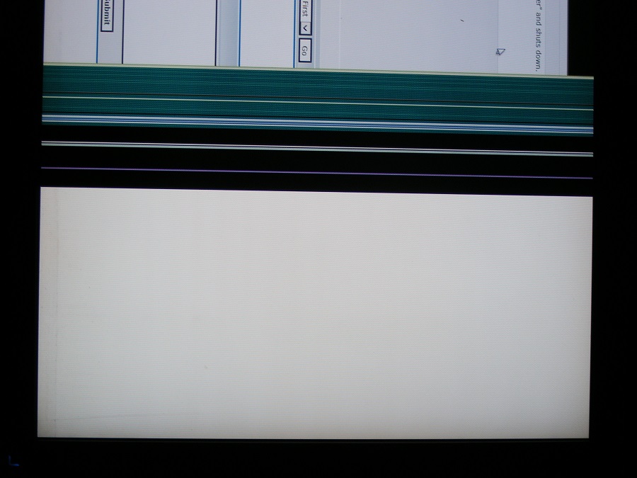

Swapped the input board, insstalled the new T-con board and it will now power up, says "Power Saver" and shuts down.
I do still have the right half of the screen looking odd. I think I'll try new X, Y boards next.
Closer....
Posted: Tue Feb 09, 2016 9:12 pm    Post subject:
Closer....
Oh yeah, I'm typing this on the screen right now. As long as I don't need the
right half I'm fine Laughing
Found out this is a 47" IPS panel. I always wanted to see what an IPS panel looked like.
Turns out I already had one. Very Happy

I'm now looking for the ribbon cables that go from the T-con to the LCD panel. Anyone?
Posted: Sat Feb 13, 2016 8:13 pm    Post subject:
Seems many people sell the boards but no body has the cables. Still lookin' anyone have an idea where to find one?
