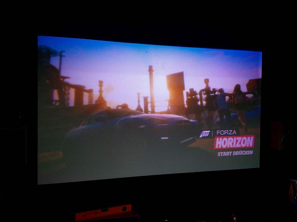

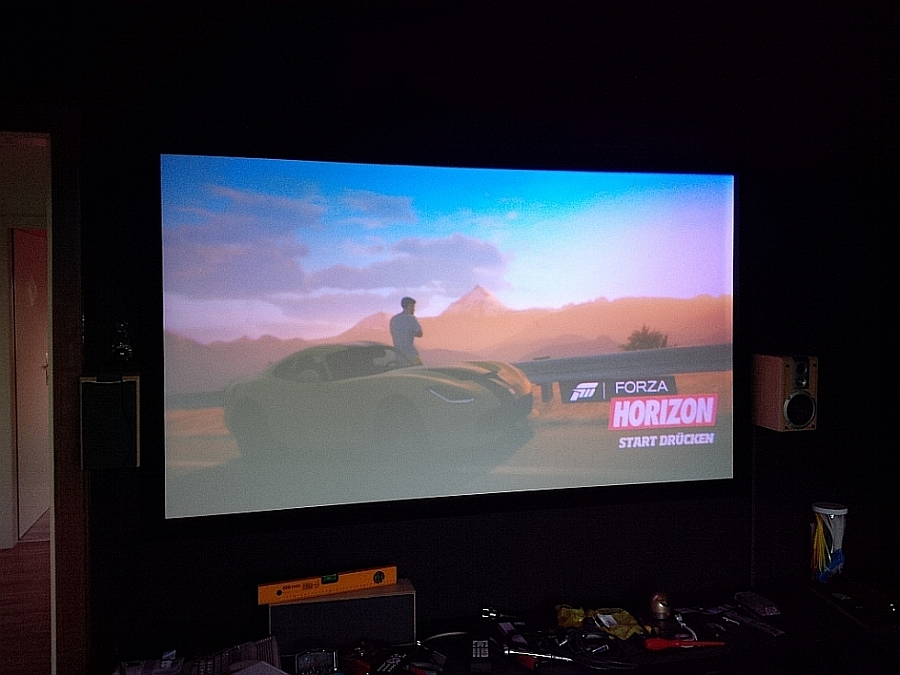

Posted: Wed May 13, 2015 7:18 pm    Post subject:
@everyone
All is finally good, seems the fury does have issues.
Connected via BNC/RGBHV today did a rough converence alignment nowhere near perfect ... but still..
Sorry for the crappy Quality will make some nice ones with my dslr soon.
In person it really looks nice already. My stupid phone camera added all the noise and overbrightness.
Xbox360 @ 720p to lumagen at 1080p/60 just for a quick try.
Will settle down for a 1080i or 720p anyway.
Cheers
Ronald
