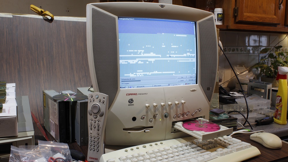

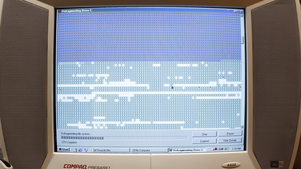

Looking pretty good so far, nice and sharp. Couple pics below to show it off. The first one shows the original infrared remote control pictured on the left of the PC Mr. Green

Posted: Fri Apr 10, 2015 12:05 am    Post subject:
Wow gold old defrag in Win95!
That's in nice shape, AND the remote too. Nice score!
