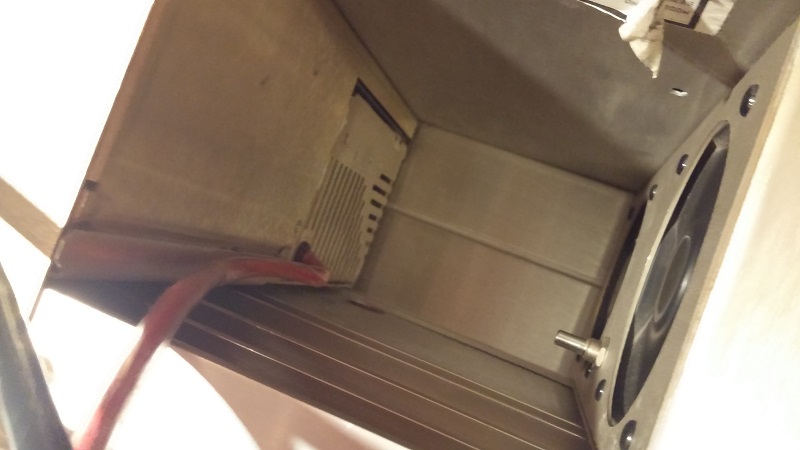

Curt, Possibly.
Here's a view from what I see.
The potentiometer in between the fans is the one I had to have brushed against.
When I made adjustments to it after taking a reading on P14, it was almost turned to the left completely... No silicone on it, but I had thoroughly inspected the supply before it's initial installation, and dialed it in.
I'm going to make sure it stays stable through the night, then will apply a locking agent to the stem.

Posted: Fri Mar 20, 2015 2:00 pm    Post subject:
Yup, could be one of mine. It's possible someone took the silicone off at some point in time, as I always set the voltage, then apply the silicone, then measure the P14 again. Then again, I'm not the only one doing the mod like this.

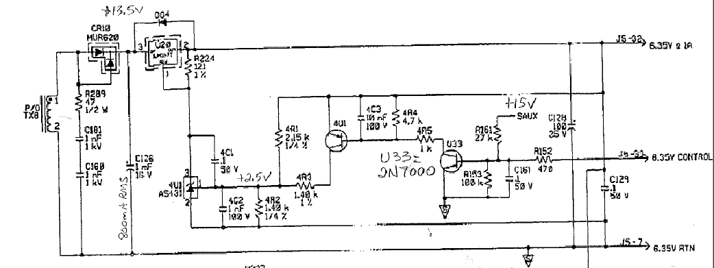

I don't follow all the Marquee threads but why are you guys not just using a basic regulator circuit?
Posted: Fri Mar 20, 2015 5:41 pm    Post subject:
E'home did that on the later power supplies. I just didn't have the time to work one out, putting in a pot takes me 1/2 hour.
Posted: Fri Mar 20, 2015 5:50 pm    Post subject:
The older Marquees had a bad part issue. the latest redesigned that circuit and it no longer is an issue.
You could just put a low tolerance resistor and remove the pot.
499Ohm 1% or better high quality.
Also might as well increase the 1000uf cap to 2200 or larger.

Putting a resistor there or even a pot is not a good idea. Any fluctuations in the supply line would also fluctuate the filament voltage. A regulator and zener diode would hold the filament voltage constant regardless of supply voltage fluctuations.
Posted: Fri Mar 20, 2015 8:32 pm    Post subject:
I think that is how the new Filament power board is. it is an entire new board placed vertically in that location.
Here is that section for the filament voltage.
