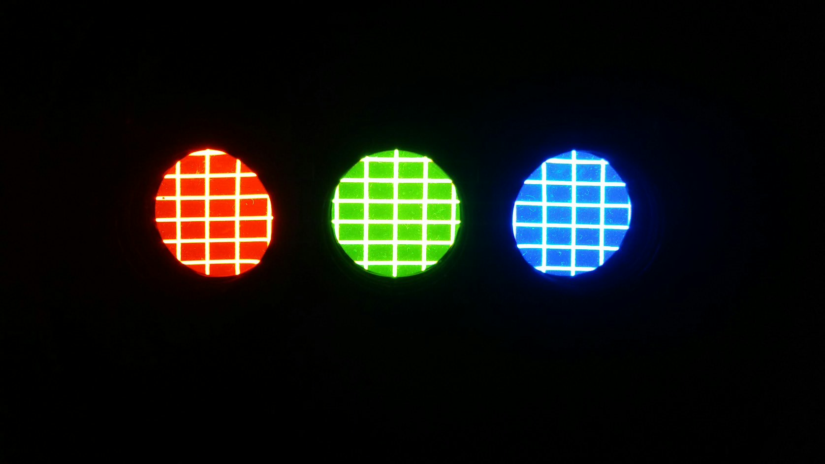

got it, i adjusted the g2s, if i look into the tubes, the blue tube seems out of focus. regardless how much i turn the lens.
Posted: Tue Mar 24, 2015 11:09 pm    Post subject:
One of the things with CRT is many purposefully defocus blue to get a better white balance and greyscale.
It might be like that from the previous setup.
Not sure if the ampro has a de focus blue switch like some other PJ's do.
nashou
Luuk neele
Joined: 04 Mar 2015
Posts: 186
Location: Wijk bij duurstede, the Netherlands.
Posted: Tue Mar 24, 2015 11:16 pm    Post subject:
That could be it.
So far it's good.

Posted: Wed Mar 25, 2015 1:02 am    Post subject:
Don't worry about the blue focus. That is electronic focus.
So you did the G2's with the tubes turned off, right? Then you turned them back on and this is where you are now, right?

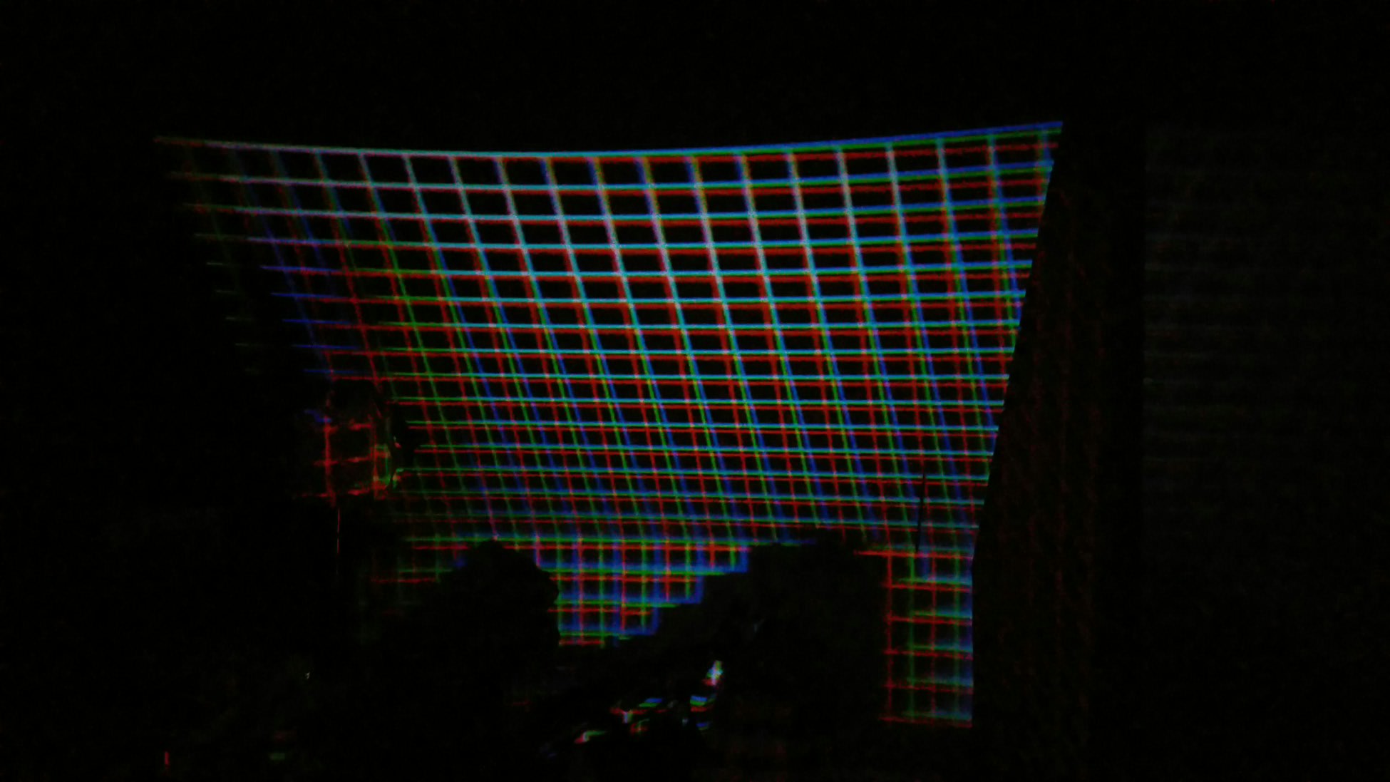

Posted: Fri Mar 27, 2015 1:58 am    Post subject:
It's in focus when I do setup.
As I finish and switch back to rgbhv input, the image is crap.
Blurry, low res. No matter how high I set the resolution on my pc.
Also the top is crooked, as is the top left, and the left side of the screen has double lines on the tube at 60khz or more.
When I look into the lense I see jittery lines on the raster,
What's up with that? I set everything back to default and I'm gonna try again
mac
Joined: 07 Nov 2012
Posts: 143
Posted: Fri Mar 27, 2015 2:01 am    Post subject:
Make sure you have the source at the resolution you will use and then use "4" "test" for the pattern to adjust. Also have the 55 code set properly when adjusting. I dont remember off the top of my head, just that it can be an issue. If you still have problems I will look at the manual and assist.
